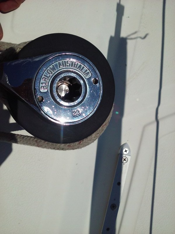

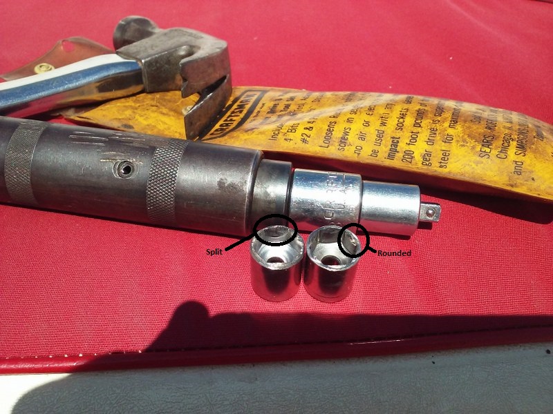

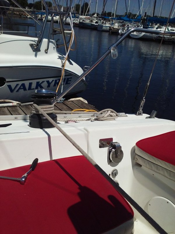

Well, I did get a chance to work on trying to loosen the bolts in the winches, but they wouldn't budge. I use the jib sheet rope to cleat off one end, routed around the starboard winch and then to the port winch and cranked it tight. This held both winches from turning.
I used my impact driver to try to loosen the bolts, and even tried going the opposite direction, but the most that I've managed to do is to ruin the two sockets that I brought (cheaper ones, 1/4 inch drive). The Barlow #23 winch manual shows an allen screw, I'm guessing that a PO changed to a stainless steel bolt (or from the factory?). I don't see where the bolts could be reverse threaded... Even tried soaking with penetrating oil. (I haven't tried heat yet.)
I think that my next move is to either find a "thin wall" socket (.670 OD) 1/2" (3/8ths drive) or try to have an existing socket turned down on a lathe and try it again. I found that I could get a lot of torque with the impact driver, but the tools weren't up to the challenge. I may also try to build a tool to use the two holes in the top of the winch, to hold it in place, although using the jib sheet to hold them worked well (very low stretch on the ropes).
Both winches are working OK, so I'm not in a great hurry, just wanted to make sure that they were greased, probably been a LONG time since they were cleaned and greased. (The thought: "If it an't broke, don't fix it" has crossed my mind...)

I would take out the top ring with the "Barlow Australia" writing on it, and see what help that might bring. Here's how, if you don't have the tool that originally came with the winch:
Put a winch handle in the winch. Take a bolt, machine screw, nail, or similar (I just use a machine screw) and insert the screw into one of the two holes in the ring. (Just place it in the hole, doesn't matter if it doesn't go very deep.) Slowly turn the winch handle counterclockwise until the lever of the handle comes into contact with the screw, then continue turning the winch handle. The screw exerts sideways pressure on the hole, turning the chrome ring, and allowing you to remove it, as it is threaded. The barrel of the winch should not turn, but if it does your hand pressure will be enought to resist the unscrewing action on the ring. You may then find you have more room, or other parts lift out and the problem looks different. DON'T drop anything overboard.
Hutton Winches, LLC in Australia supports Barlow and Barient. The phone number is +61 2 9623 2448. You can email a really helpful guy named Alan (sales@huttonwinches.com) for exploded diagrams of most of the models they made. Some parts are also still available. If you email with questions, be VERY specific about the model number of winch, how many speeds, whether it is self-tailing or not, etc. They made multiple versions of the 23, not all of which were two-speed, despite what some people will tell you. Don't ask me how I know, but there is a long thread on it here somewhere.
A google search should get you a manual or diagram/parts list, but make sure it looks like your winch before you start believing in it. As I said, they made lots of versions of the 23. Good luck. PM me if I can help.

I agree with SFS, you'll need to remove the ring over the self tailing arm. It works like a deck fill plate... need a special tool... or a small punch to loosen then unscrew by hand.

Thanks guys, I will try it next time I'm at the boat which should be later this week.
At this point I don't quite understand how the top comes off ( I have been into the other winch which is not self tailing) , but the difference must be because of the self tailing top. But I believe I understand what you are suggesting.
Mike
Jun 1, 2016
162
Hunter 28.5 Lake City, MN
OH!!! I see what you are talking about! I found a YouTube video on a Barlow 27 winch that has the same basic construction. It appears that the bolt that I've been working on doesn't even have to come out.
Many thanks!
