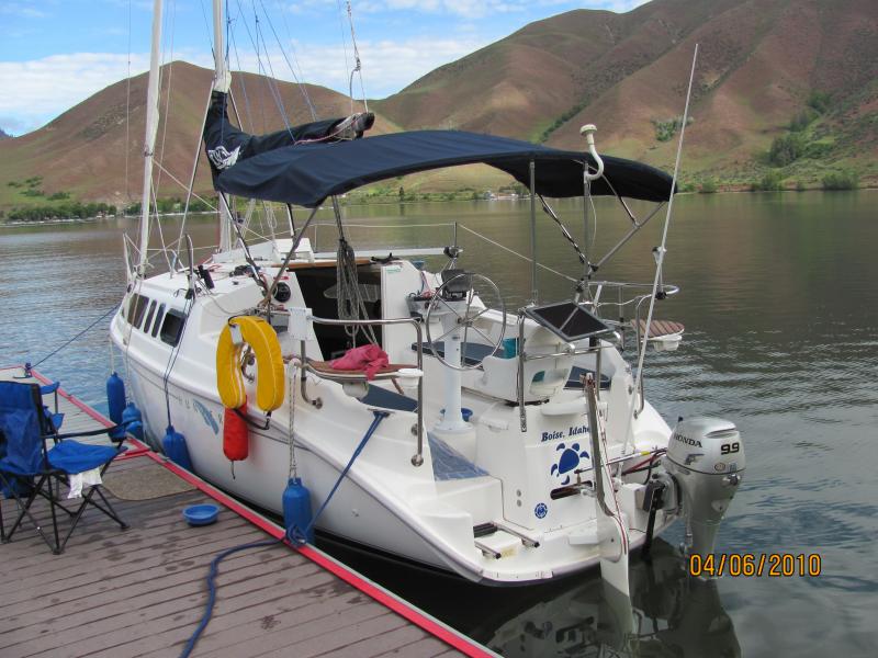

Not sure if I am understanding the Honda 9.9 issue. I have a 2010 Honda 9.9 that has a remote start, Fwd/Rev lever and throttle on the pedestal, and I have wheel steering. My connector that runs between the motor and the rudder, has a quick connect which I disconnect when sailing. The key starter, what I'm calling a remote start, is mounted at the base of the captains seat. So I do everything from the captains seat until its time to sail. Then I spin around in my seat and disconnect the steering and raise the motor.
I don't have any pictures handy but I have attached one that somewhat shows my set up.

My throttle was not mounted on the Edison pedestal. Instead, it was mounted on the starboard side of the seat.
You can see the throttle beside the cushion, just ahead of the motor. Yes, I still have the table!
