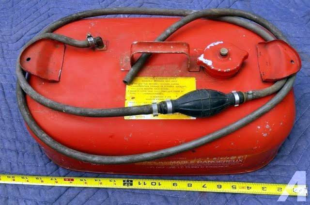

Will this go boom?
Sep 24, 2018
4,467
Catalina 30 MKIII Chicago
I have a friend that's pushing me to store my vintage gas tank in the lazarette. Seems like this would vent fumes into the boat when it warms up. Is it safe to store it in a semi enclosed space? The one below is pretty close to what I'm using for the time being

The answers is no, but would love to hear your friend's reasoning behind his recommendation. Gasoline fumes are heavier than air and will flow down to the bilge where a spark could ignite it. Boat's equiped with a gasoline engines usually have spark arresting components and venting fans to evacuate any gasoline fumes prior to starting.
"Other sailboats have done it!"
I've seen this done on a few boats and was skeptical. Are there portable tanks with proper venting?

Mine was in the lazarette and I moved it out. Both my O'Day 25 and now my Beneteau First 235 You need to vent the lazarette, not the tank, the tank will have venting. Just be safe and don't do it. This is not how you want to make the news. ;)
