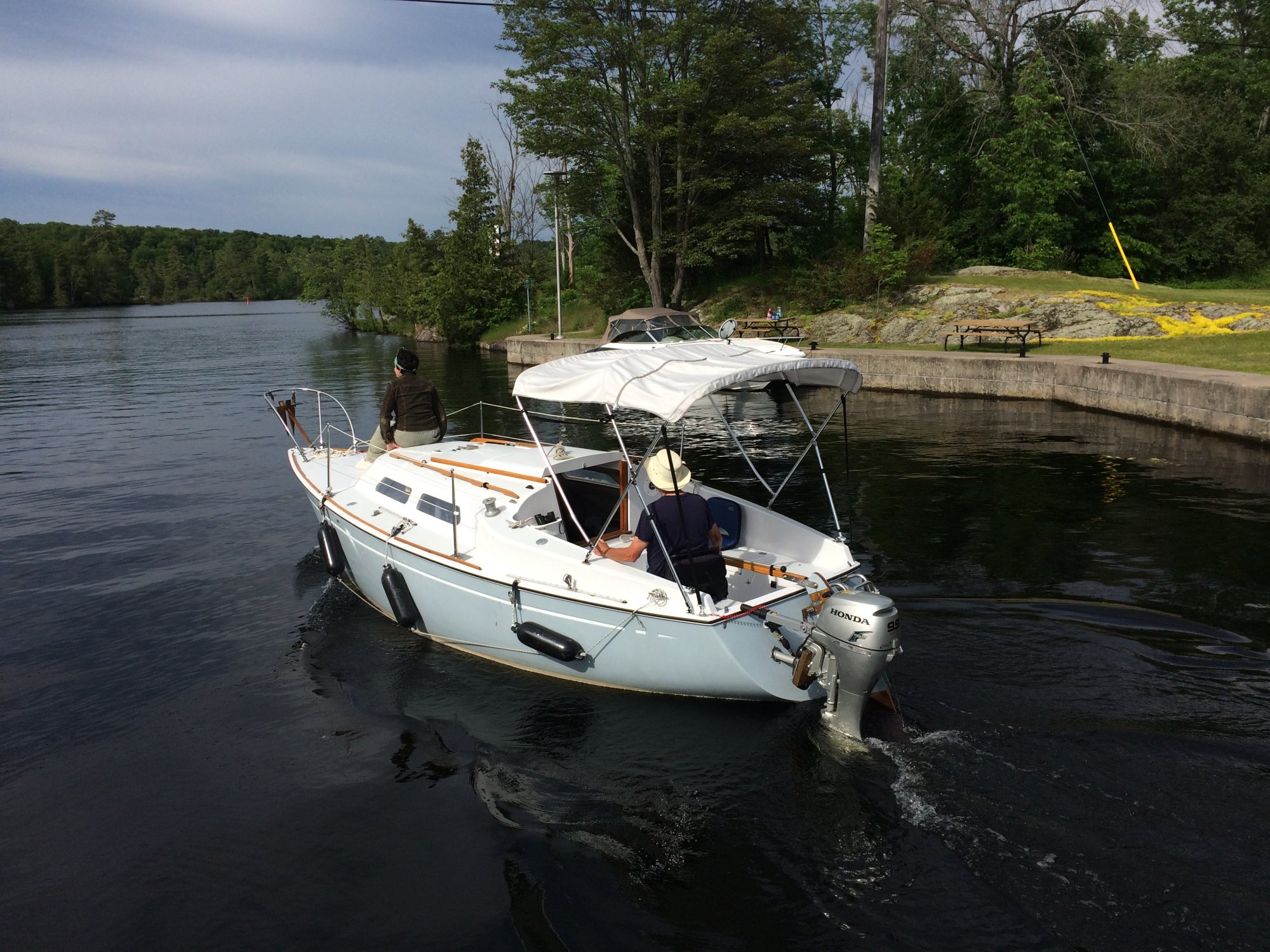

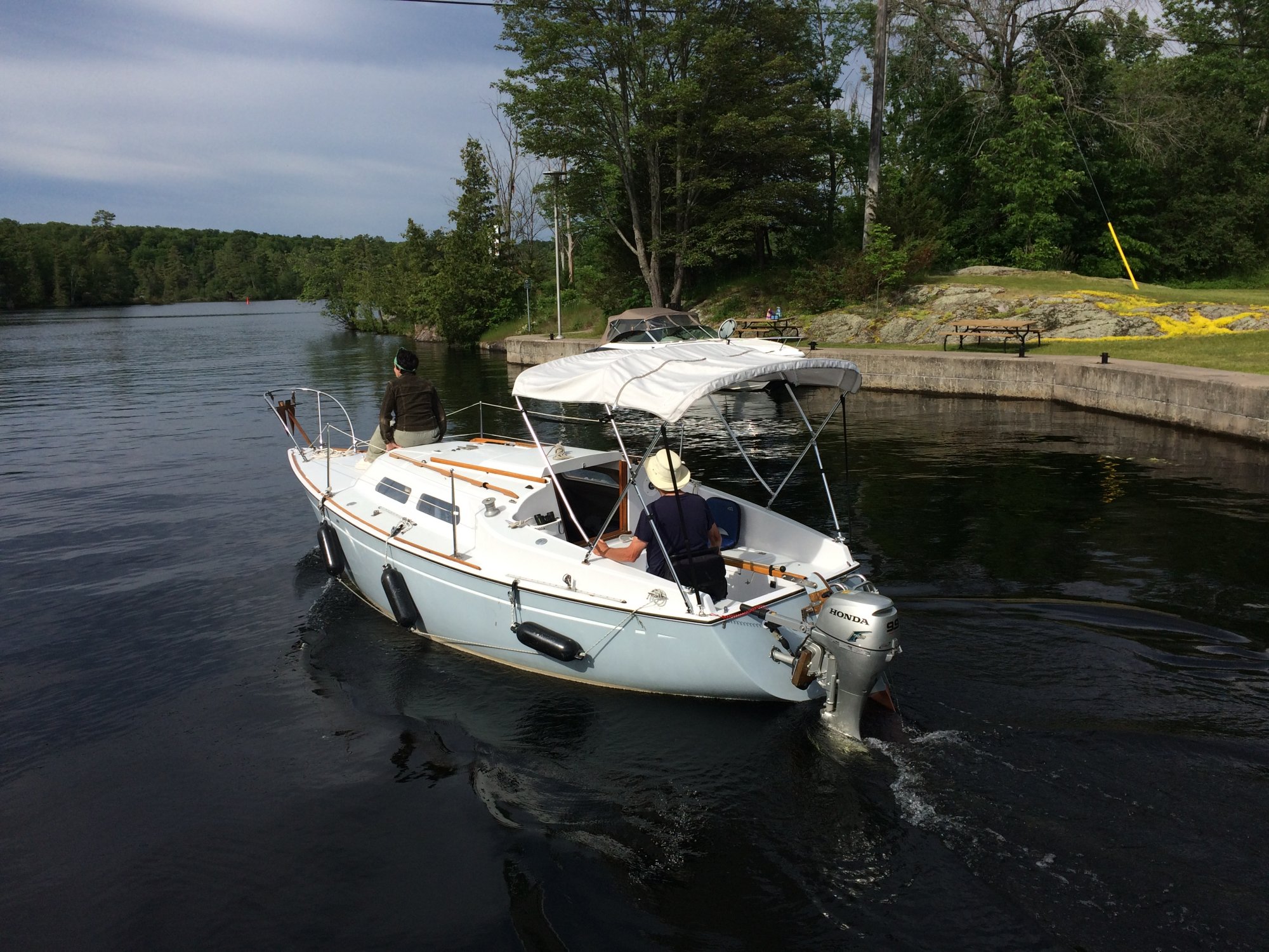

The plan is buy something small and easier to single hand in good shape without spending a fortune. If I like sailing, then upgrade later to something bigger, more comfortable and travel further. I am surrounded by Great lakes and canals. Or else convert the sailboat by removing the swing keel and add an enclosure at back and us it as a fishing boat like this couple

The plan is buy something small and easier to single hand in good shape without spending a fortune. If I like sailing, then upgrade later to something bigger, more comfortable and travel further. I am surrounded by Great lakes and canals. Or else convert the sailboat by removing the swing keel and add an enclosure at back and us it as a fishing boat like this coupleView attachment 169613.
Part of the issue of using sailboats as motorcraft without a rig is that the pendulum effect of the mast smooths the rolling motion of the boat, and gives it a more sea-kindly feel. Removing the mast can make the boat roll a lot, and with a faster period. Also, for a boat with a true ballasted swing keel, it might not be the best idea to remove it, given that it is the boat's ballast. Admittedly, the ballast is more important with the sails up, but I can see that it would be a potential issue.
My boat is a ballasted stub-keel with centerboard mounted in the keel. It draws 18" with the board up. The board does not contribute any righting moment, so if it were removed, it wouldn't matter. However, I don't know how the boat would feel with the rig removed. I've only ever launched with the stick up! :)

The plan is to learn to sail. As you said, outboards are unreliable and noisy. Wife doesn’t like sailboat heeling over 5 degree thru, will see. I seen many sailboats without their mast motoring up and down the Trent Severn Waterway and small lakes over the years. In fact, it’s the only way they can traverse as there are too many bridges to count. Travelling like the above couple from Ottawa to Midland, ON(600 km and 100 locks) been a dream of mine for a long time.
