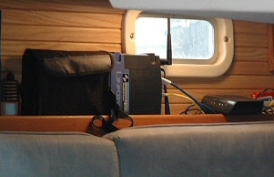

A couple of years ago I built a range extender (actually a repeater) out of a Linksys router running DD-WRT and the Linksys larger antennas. It worked pretty well for bringing in the weak marina signal - for a while. But weather and a big fishing boat all played a part in how good the signal was. All in all it was a pain in the ass and I could pretty much count on the signal dropping out exactly when I really needed it to work.
