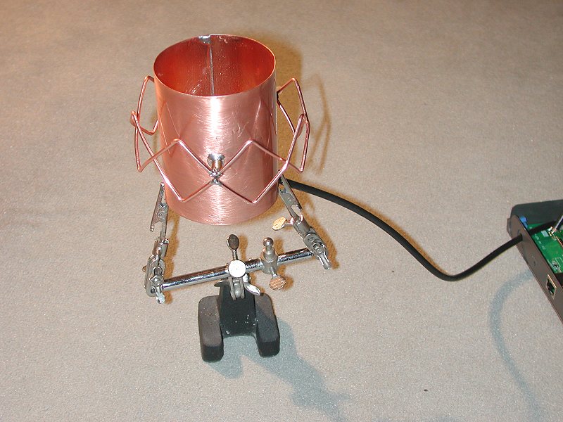

I understand that my reception depends upon my antenna gain and the sensitivity of my receiver. I'm working on a hi-gain antenna solution to address that problem.

What kind of antenna (directional or just high gain omni) are you considering?

I am considering a round tri-quad design. I can't find my translated info (from German) right now but I seem to remember that it had an omnidirectional gain of about 12-13db.
