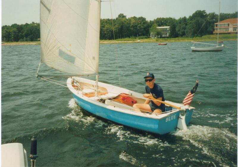

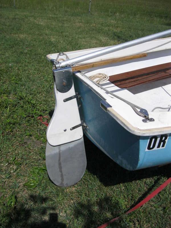

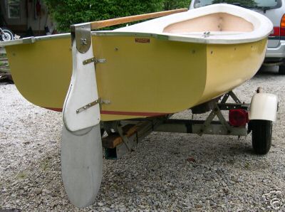

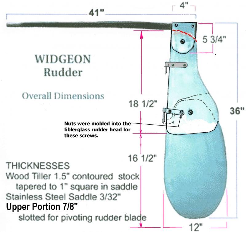

Based on this info, I have attached a series of pictures of what should have been the original rudder. I also included one of my old Widgeon, that picture was taken in 1989, the 2nd season that I owned the boat.
