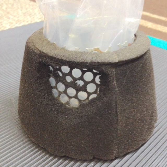

Just as a word of caution, I found this hole eroded through the foam air filter element when winterizing our Yanmar 3YM30 engine last Fall. The hole was at the point where the air flows into the silencer. My assumption is the element had not been changed since the boat was new in 2008 :cuss:and a diesel engine runs just fine on a little bit of foam...:yikes:
View attachment 121270 View attachment 121271 View attachment 121272
The February issue of Practical Sailor pretty much summed this thread up in an article named "In Search of Better Filters". They even used this picture. Noisier or not, I think I'm going to find a K&N that fits my 2GM20.
