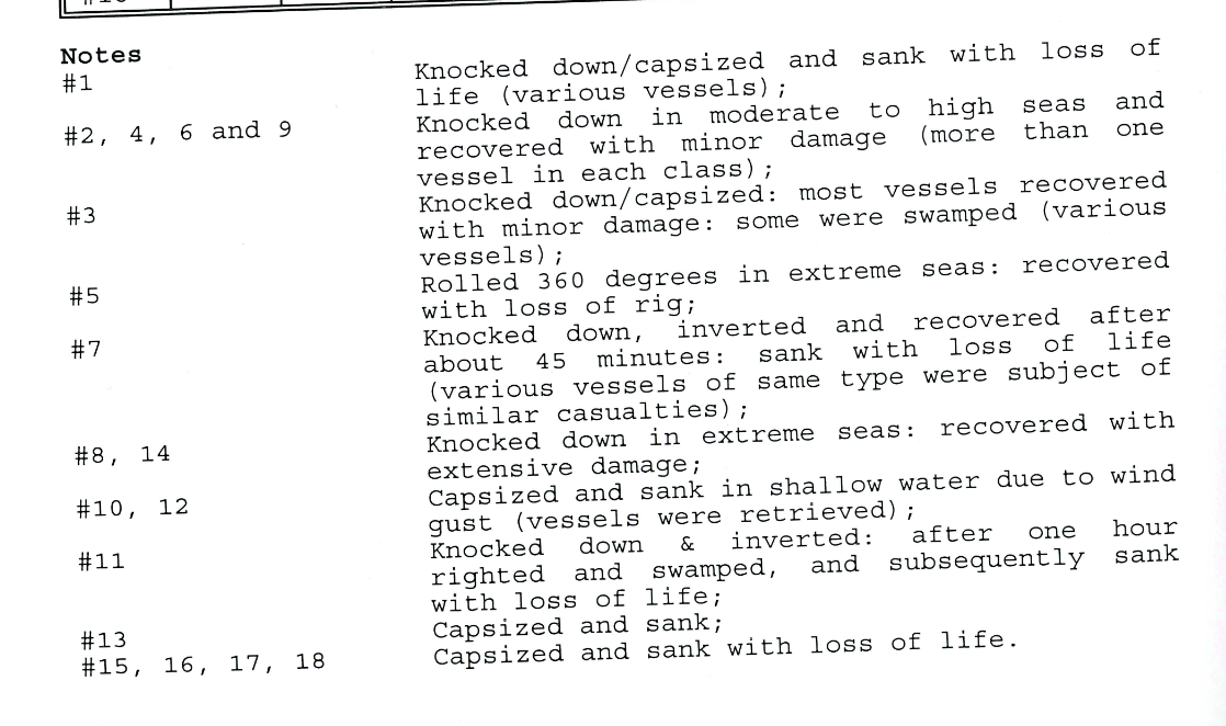

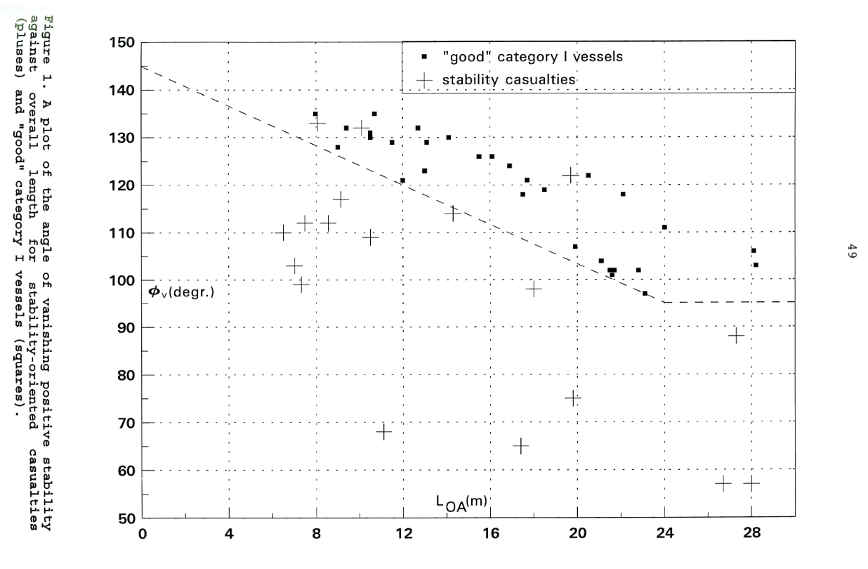

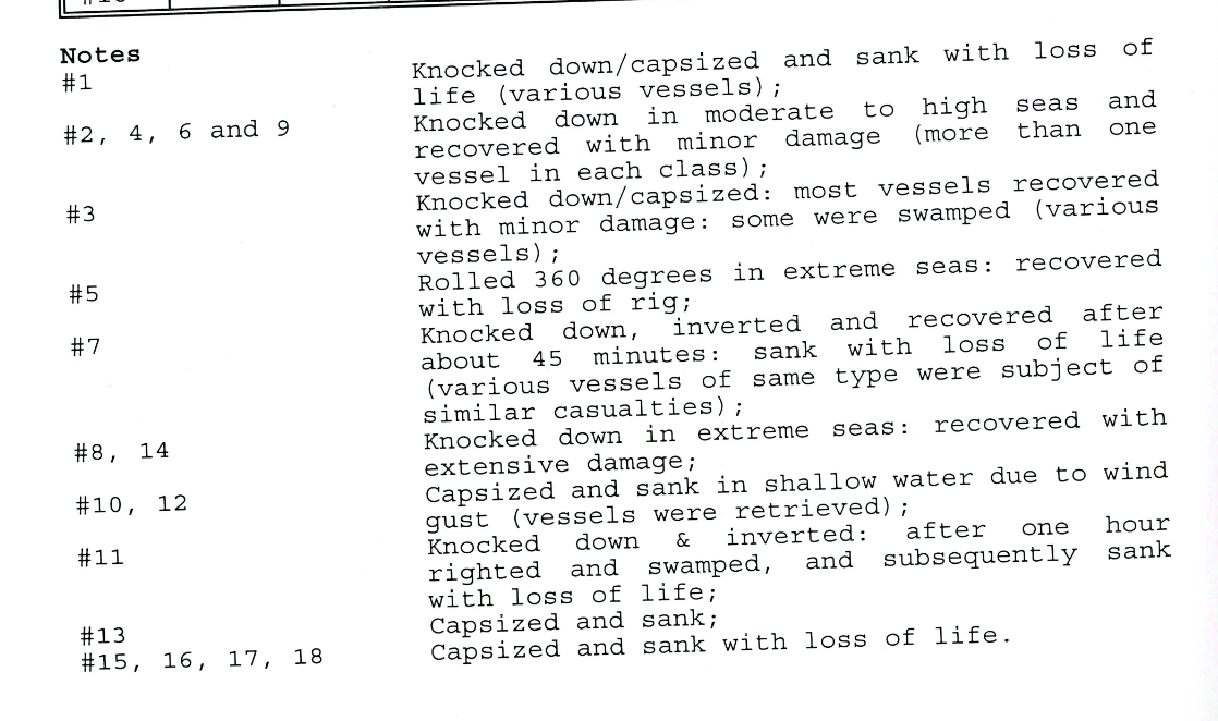

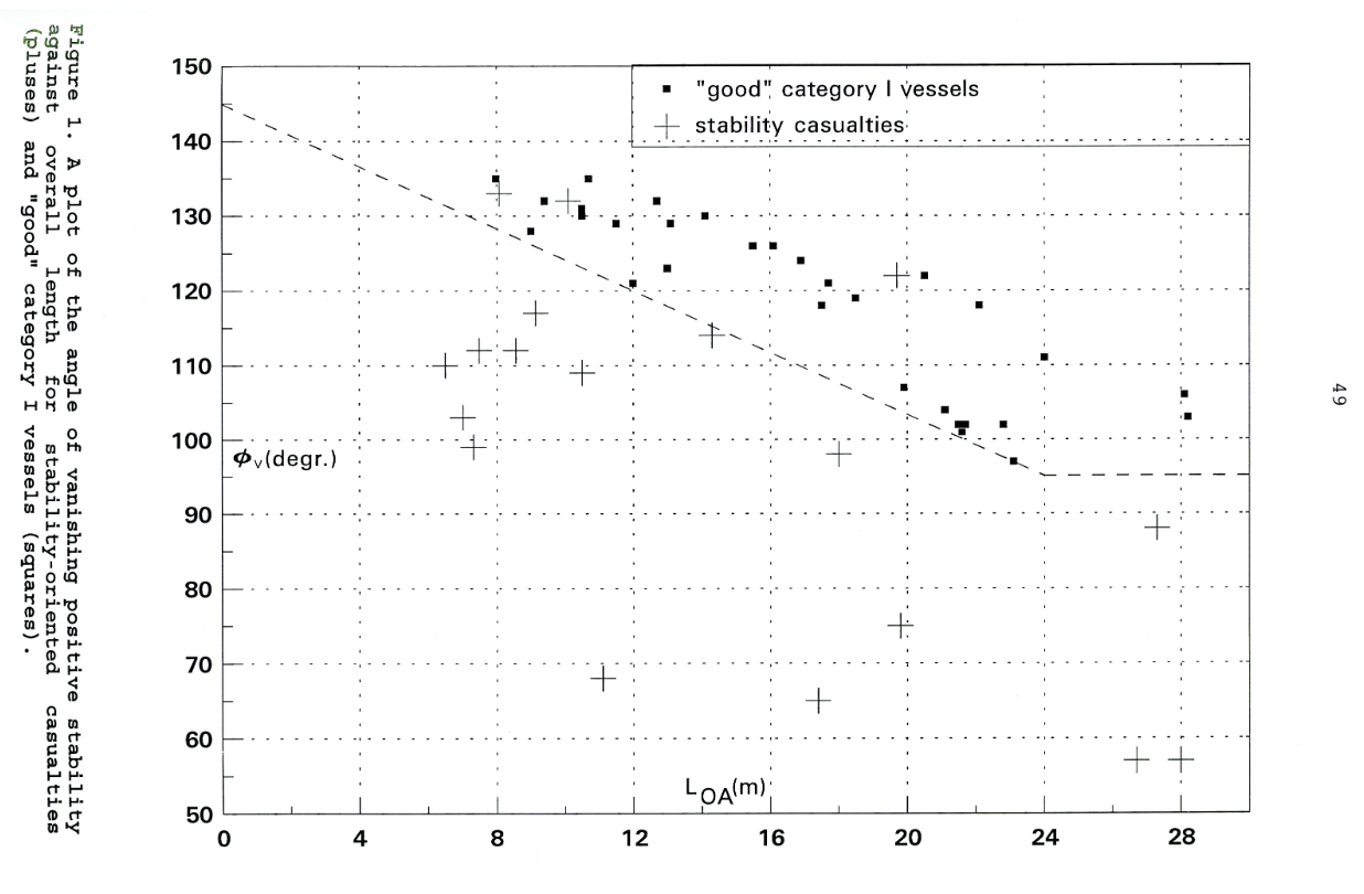

As far as stability goes (which is extremely important) - the CE rating matters. I've seen an enormous amount of criticism thrown at this standard online, but it is the best, data-based lens we have to look at the major safety components of boat designs. I've attached a paper that the original standards committee comissioned for the development of safety requirements. It's a really interesting read, studying the characteristics of known losses up until the time of the study (1994). Edit - the forum rules won't allow me to upload the document. It's available here, under "Stablility": https://oossanen.nl/papers-and-publications/
The stability requirements established in the report are remarkably clean, and suggest very strongly that a smaller boat needs most resistance to capsize (which the standard eventually adopted and still requires to this day).
