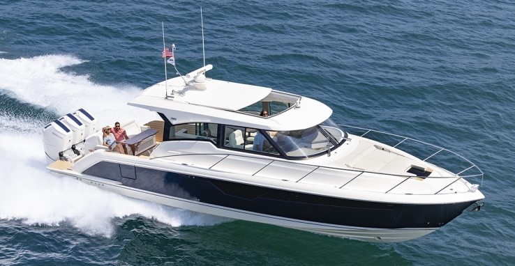

While I generally disdain adding an outboard on the back of a boat designed for an inboard, I was at a boat show recently and was aboard a Tiara 43 which has two massive 600 HP outboards on it, and they have a 48 footer which has 3 600 HP outboards. The world is changing, outboards are becoming more common place on bigger and bigger boats. :confused:
If you plan on sailing anywhere but very protected waters, don't do it. Even in protected waters, you have a very nice looking boat, why would you want to uglify it by adding an outboard? This would be akin to putting truck nuts on a Mercedes.
