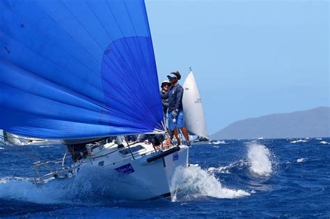

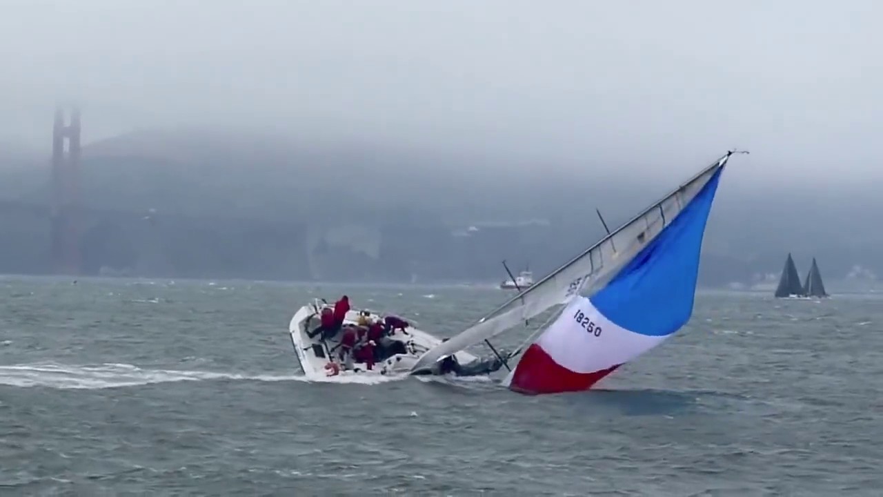

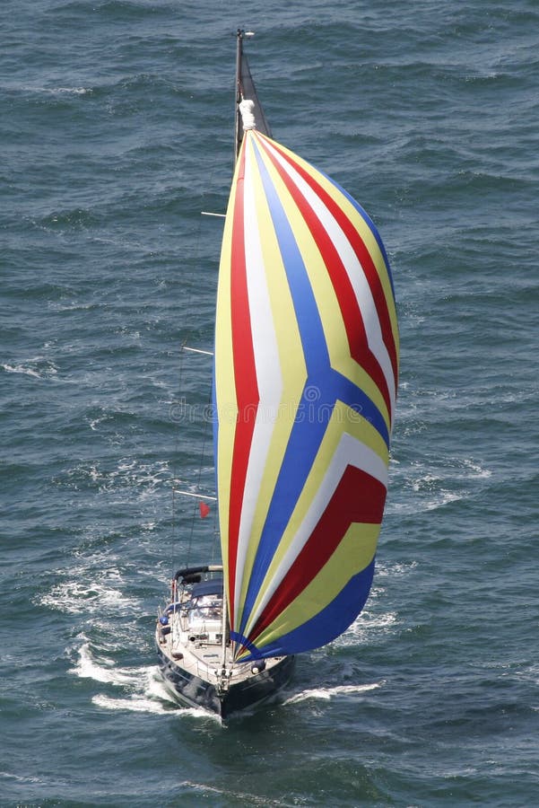

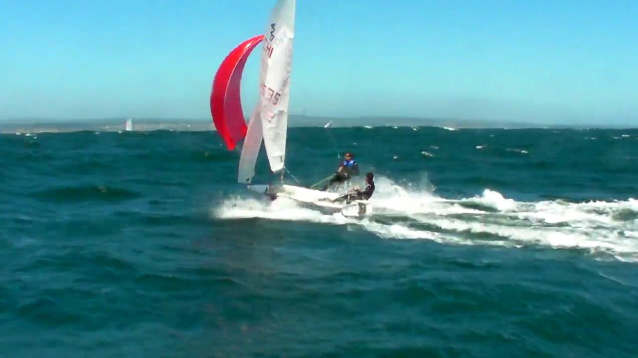

Sailing fast down wind all depends on how much sail you have up and how strong the wind is blowing. Here are several images of boats sailing down wind. They do not look to be standing still. The more sail the faster you go. Till it is to fast...
then you broach.

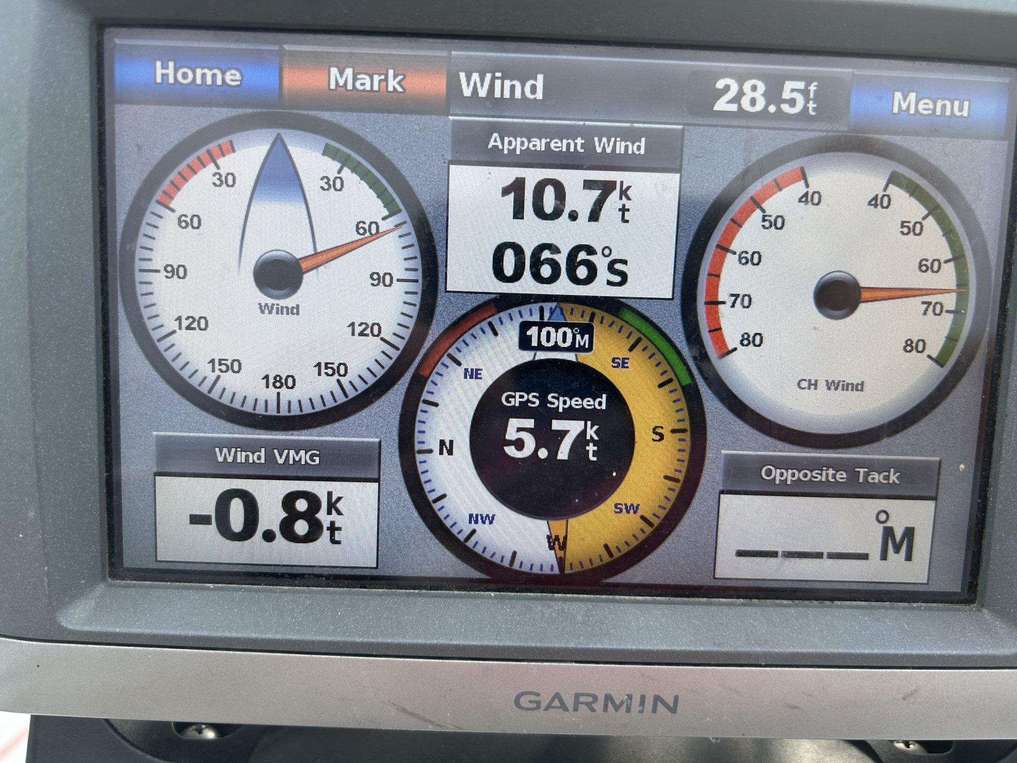

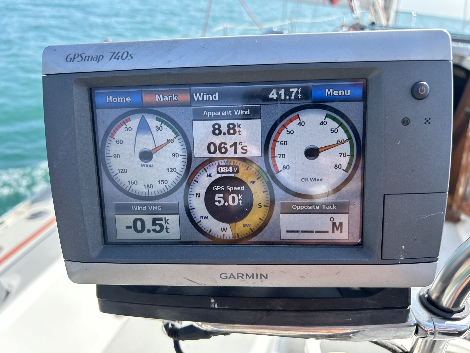

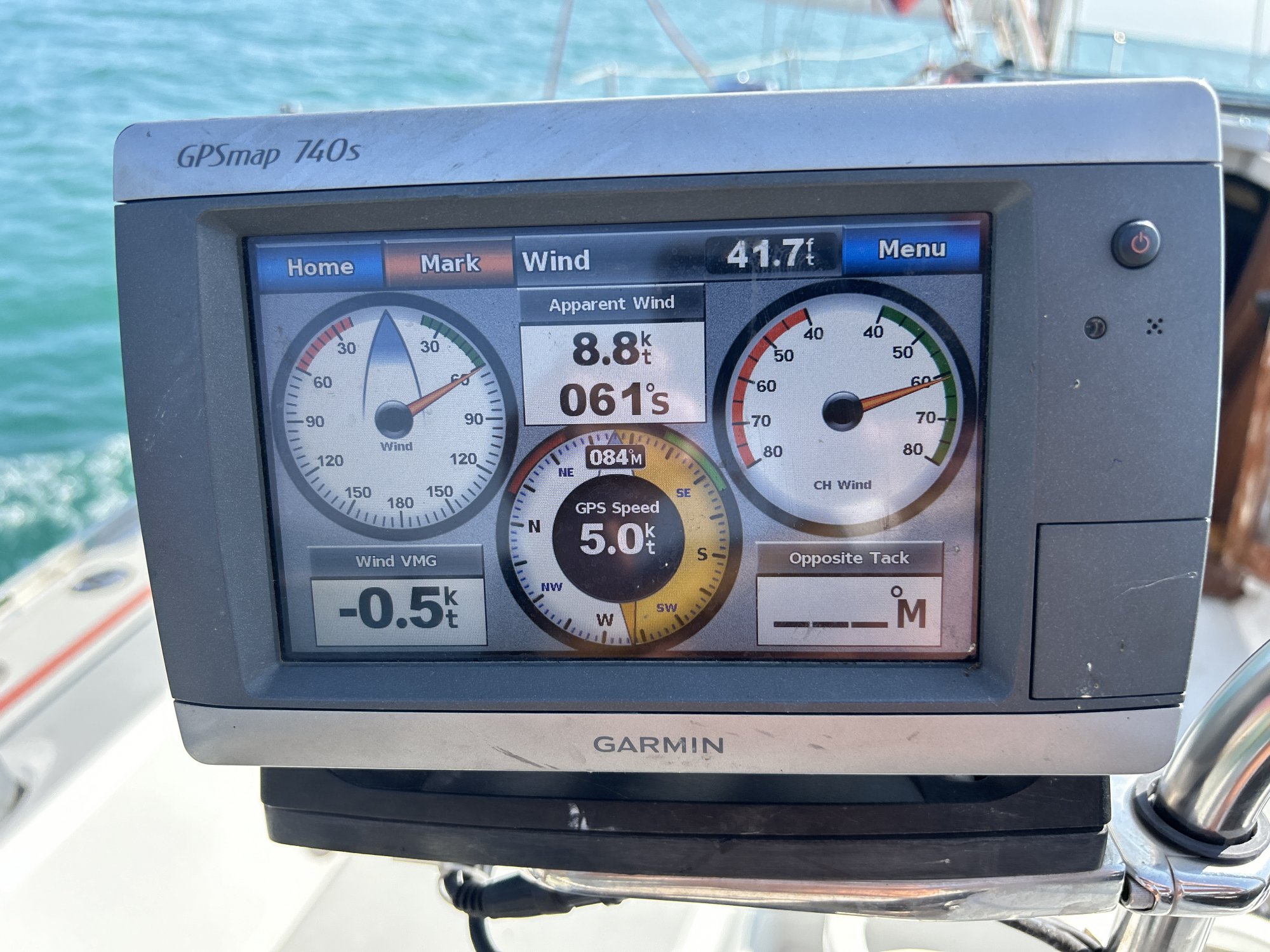

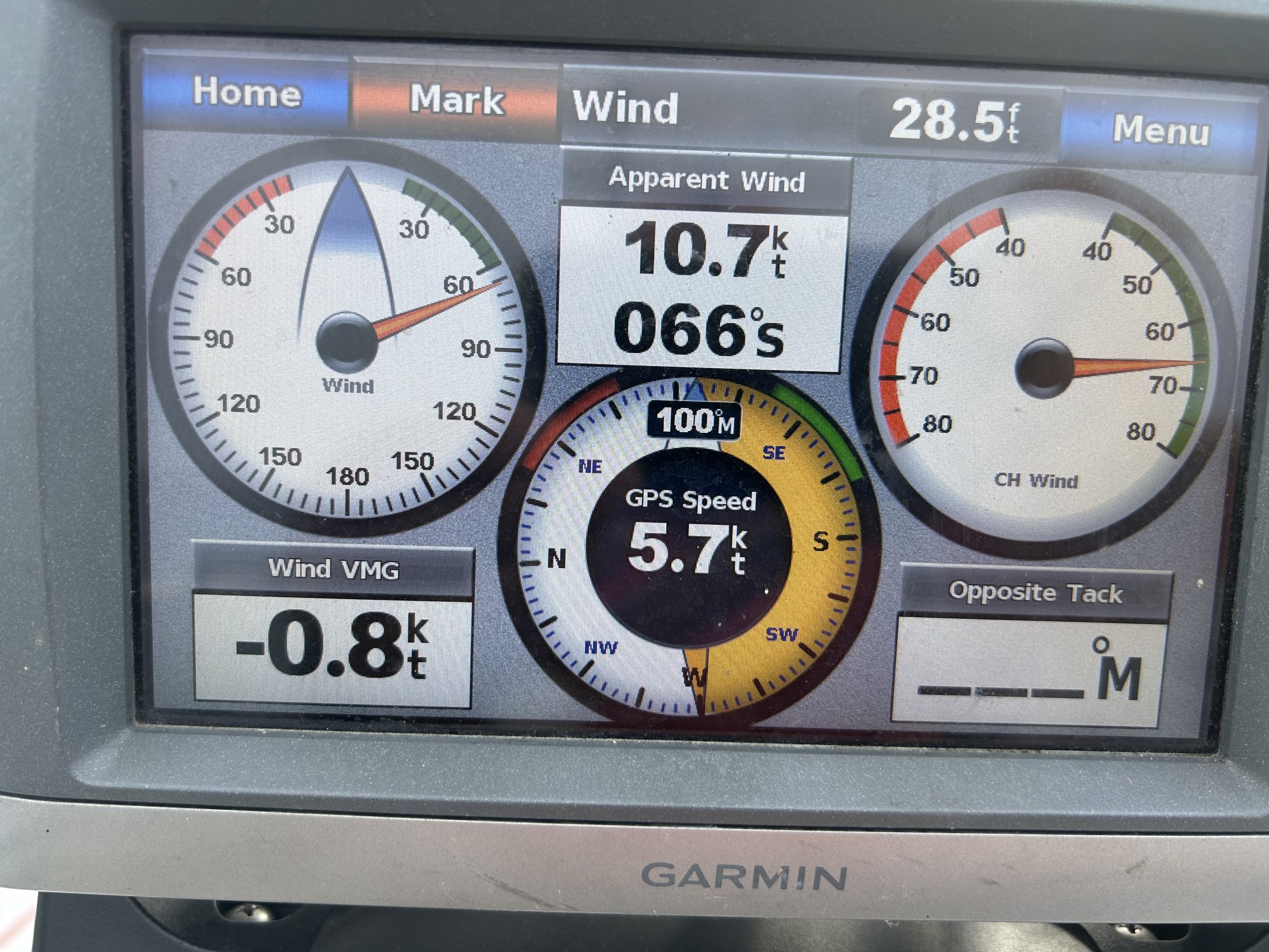

I usually figure if I am making better than half of the wind speed, I am doing OK !
With my new Max Prop feathered, I am now getting better than 50% of the wind speed and feel good about it!
Greg
