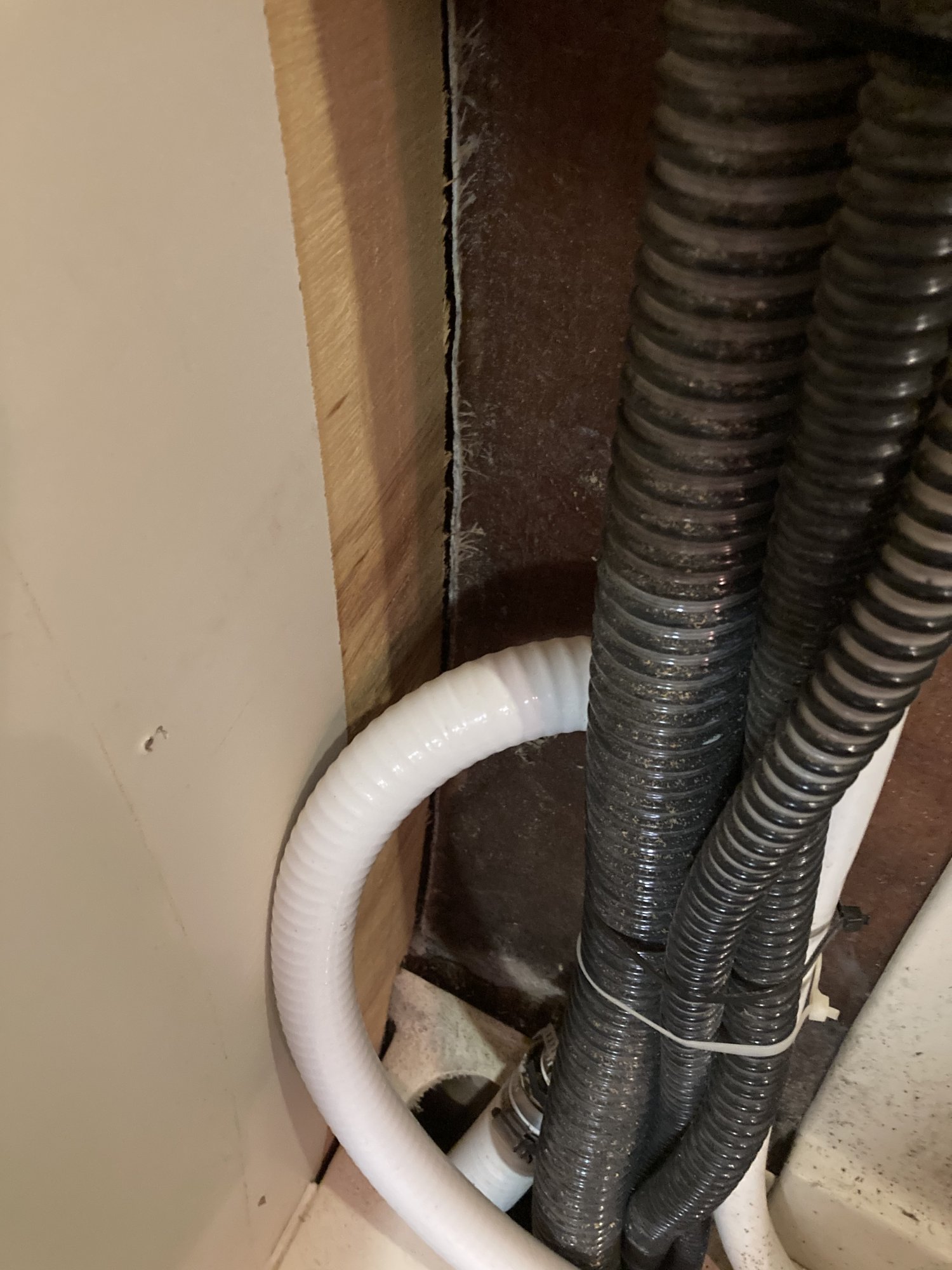

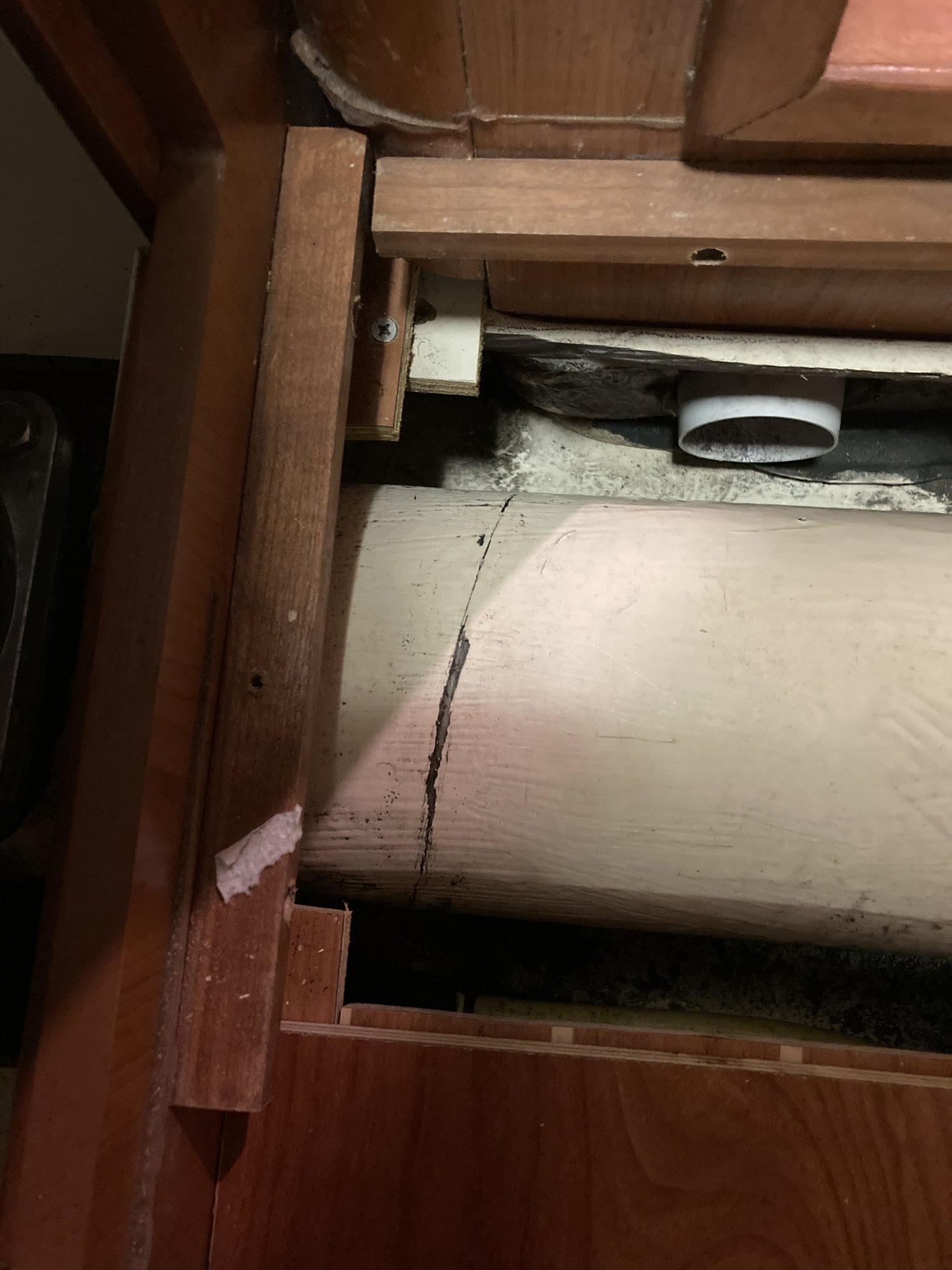

Yes, get the correct tool for the job. I certainly have an appreciation for more advanced materials and more advanced design work to take care of that, but simple things from modest offshore work where the boat is simply was not originally (I would not say designed) built for that job is different? Pics below - half-tabbing even though the laminate was removed such that it was expected bulkhead would be tabbed on both sides. Cracked bow thruster tube from using spiral exhaust-style tubing instead of proper marine grade. Having to put in cabinetry so there are additional handholds in the 'spacious' wife and/or latest f-buddy friend main salon? Don't even get me started on the cutesy doors for easy ingress/egress while tide up at a safe marina with good security that would never be able to take a few tons of water coming over the stern without a giant hole opening up, much less some locals with a crowbar looking to pick up some free electronics and other personal possessions. Or the entire companion way stairs having no positive attachment so if things get really bad, that ~50 pounds with sharp corners will just come loose and poke holes in windows wherever it wants.
Definitely not a Hunter basher after having owned the 41DS for ~5 years now. Once again, not surprised with the limitations. I think overall for this boat if she was built better the design could actually be workable.
