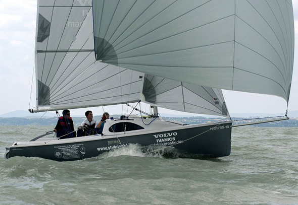

You have a nice dinghy with 10 sqm sails and weight of about 200 kg and obviously easily planes under the right conditions. The 35.5 is 6000 kg and has 60 sqm sail area, thus six x more sail area an 30 x more weight. So much about planing or not planing. Actually there is one H170 for sale under USD 5000 in Minnesota or somewhere. Main sheet traveller would be ridiculous for a dinghy and you are the backstay when holding the main in your hand. But a jib sheet traveller, bowsprit, jib furler and cunningham can be easy to install yourself if you spend some money. Myself personally would not do it on the dinghy but up to you. I would rather save some money, buy a little used sailboat over 20 ft in good condition which has all these or I would install them on her. But even than forget about ocean crossing and the likes.
Long time ago I used to have a SHOLCZ 22 OD, a Hungarian made fibreglas sailboat. It was easy to bring it to plane. However. her weight was 750 kg, sail area was 30 + 50 sqm genakker. Now she was a sailboat. They still make it and costs about USD10 000 new. See it as attached.
Finally, I would be very cautious making generalized judgement of anything,

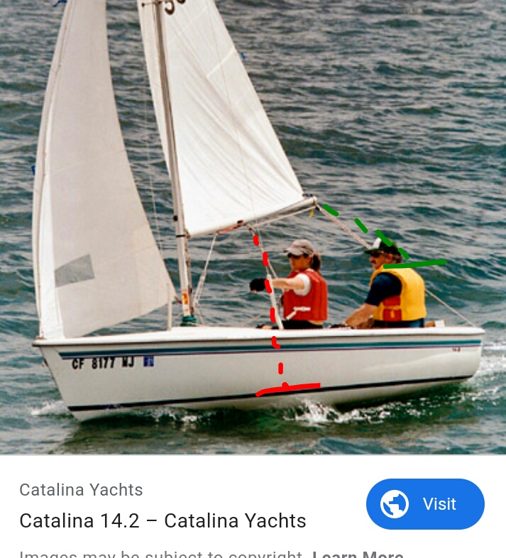

by traveler i include the stern mounted "bridle". That raises the connection point of the boom to the mainsheet so that the pulling force of the line is closer to the planeof the boom.
You suggested Capri 14.2 sailers enjoy their sailing experience. Lets bring the topic back down to show why they do and how my hunter 170 hunter let the sailor down.
Ive drawn a dotten green line to show the mainsheet for the 170 with its fixed deck mounted lower mainsheet purchase. Note the force on tbe boom is down with almost perpendicular force to the deck.
The better designed capri has end boom sheeting with a bridle midway up. The mainsheet us pulling the boom less torwards the deck and has more power inboard and outboard.

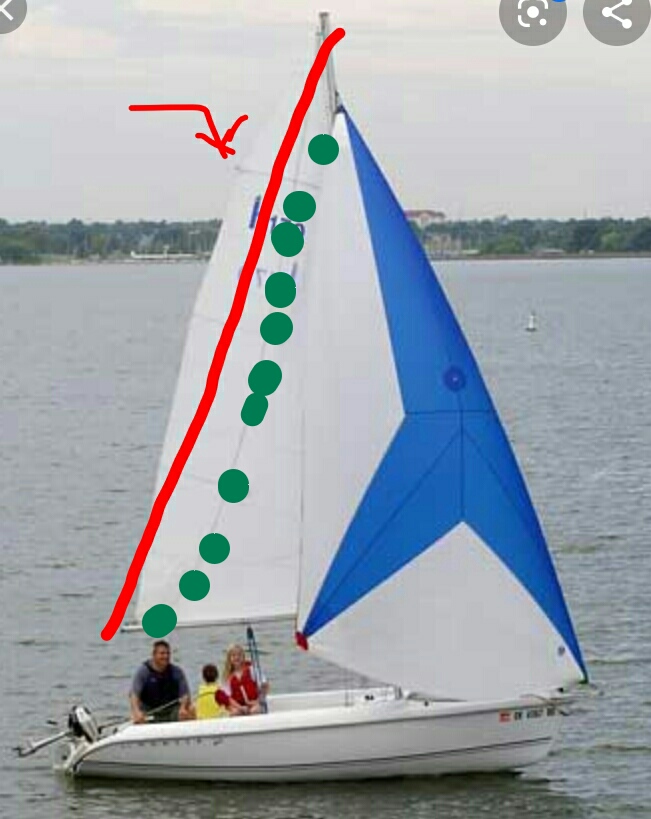

Heres a 170 with full main.
Note the green dotted line is the loose topping lift. The red line is a tight topping lift. There is a removable top batten that protrudes beyond the roach and the topping lift. This is a pretty common issue with many boats. Some boats have a mast crane that moves this out, other have flicker rod to overcome this.
