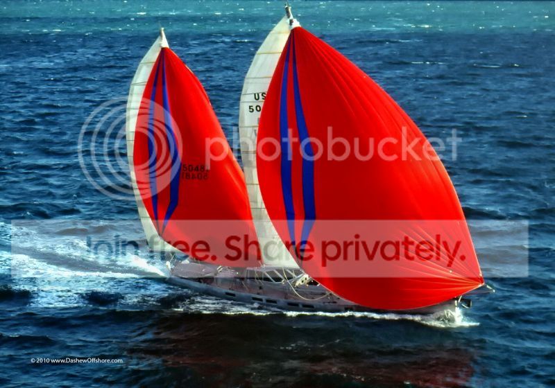

Steve Dashew was different. He believed that speed was safety. The ability to evade bad weather makes a safe passage. I don't remember the name of his most notable boat but I'm sure someone on this forum does.
The 77' Beowulf:
Likes: forest gras
Sep 28, 2008
922
Canadian Sailcraft CS27 Victoria B.C.
Main and mizzen asymetrical spinnakers. While they flew all that sail area that day for the cameras Steve & Linda put on many thousands of miles without additional crew. About 40,000 miles in Beowulf.
