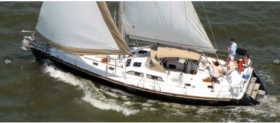

If you want to see a center cockpit boat taken to the zenith, take a look at the Hylas 46. It is a beautiful boat, built extremely well. I love center cockpit boats and have sailed aboard a bunch of them. Including that 30' S2 9.2. The attraction is that you get maximum use of the entire hull; the cockpit sits on top, not in the hull. You generally get great engine access, a snug sea galley, maybe some sea berths, a very usable aft deck, and ride high and dry in blue water. The morgan wouldn't be at the top of my list, but the Hylas, Irwin43, and the Beneteau40 would all be contenders.

@Gunni I took a look at the Hylas. I see why you like it. Can you say damn! That is some serious boat porn.
I would HAVE to be retired. There is no way I'm going to work if I owned one of these. Check out the stern seats and walk off transom in the last pic.

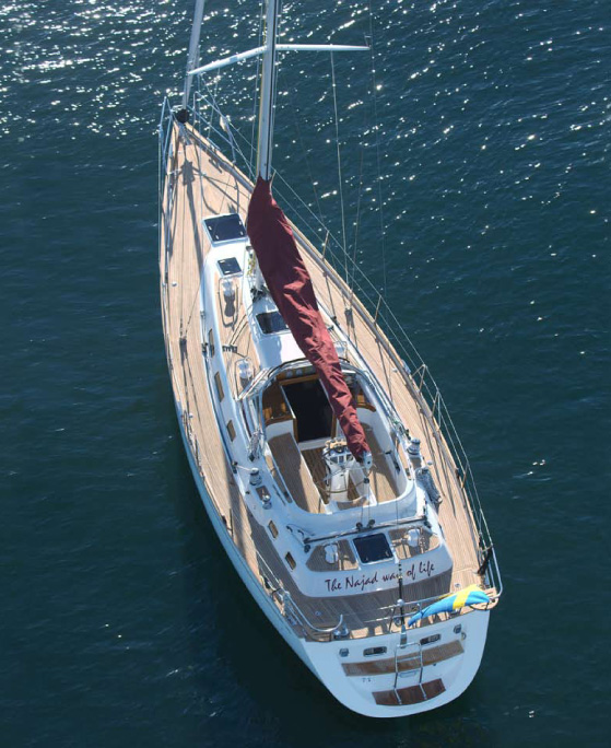

I have always thought that the Najad 440 CC (now the 450) would be a spectacular blue water boat to own. I love the styling and it seems that they would be very good performance wise. I'd love an opportunity to sail on one. I agree, under 40' no way. 45' and longer, they actually look far more graceful and balanced to me than an aft cockpit. If I was in the market for a boat that is 45' or longer, I think I would look exclusively at CC.
