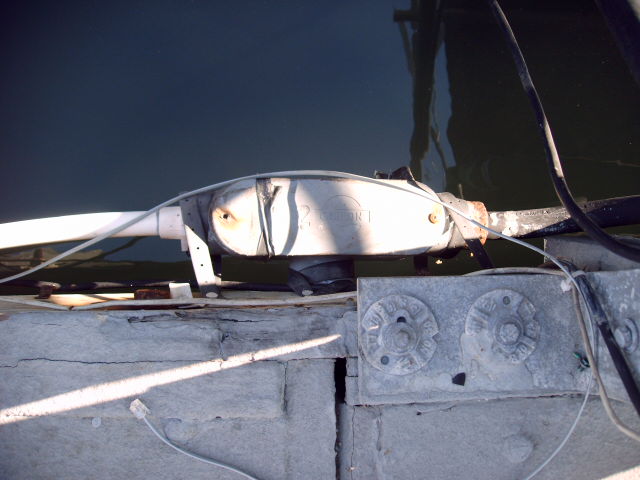

Last week I was visiting my boat in MDR an I noticed my reciprocating fan was slowing down then speeding up. I unplugged it and assumed it was going out on me.
A few minutes later I noticed my cordless phones base unit Led's had went out. I happened to have my Fluke meter out for another project so I checked the AC wall outlet to see If I had lost shore power as happens with some frequency in this Marina due to DWP electrical issues
When I checked the outlet voltage I was shocked to see it was 220 VAC. I thought the meter was bad. I turned of the AC on my panel then I went outside and checked the outlets on the dock itself.
I observed a voltage swing from 45 VAC to 240 VAC. There were other owners on the dock doing similar things as I was to see what was going on with the docks power.
Long story short, I lost my boats charger, my cordless phone, a router, a small old school TV.
All in all 3 boats suffered blown up chargers. There were two microwave ovens blown as well. This is the damage I am aware of. There may be more as I have not spoken with all affected owners.

I'm willing to bet that the problem was a floating neutral, either at or close to the main breakers for that dock. when that happens, the neutral is no longer staked to 0 vac but is free to float around.
(image is from about the middle of this webpage.)
This changes two normal 120vac branches, into two branches in series across 240vac, and the neutral is the 'mid-point'. If one branch has a much greater load ( = smaller resistance) than the other, the voltage on the less-loaded branch( = higher resistance) will then shoot up towards 240v.
It's not the marina, it's a fellow boater that needs a 50A 125/250V receptacle for his boat. Couldn't find one, so he plugs in two 30A cords on two different circuits, which gives him 250V. As soon as his 250V water heater or electric range is turned on, then everyone on those 2 legs gets 250V. .
Sorry, this wouldn't happen, if the dock wiring is all OK. The reason is that 240vac loads are connected across both hots, and never to the neutral, thus has no influence on the neutral.

Thanks for the the response. I appreciate it. Sorry I couldn't update until now, here goes.
The voltages were as I described, rapidly changing.
When the Marinas employee (not a DWP guy) showed up he worked on wiring where it meets the edge of the dock. See photo
This area moves up and down with the tide. The incoming wires are in a large heavily insulated waterproof looped bundle that flexes and then contracts with the tides, The Marina worker made his repair in this pictured connection box.
Notice the condition of this box, the rubber water proofing gasket is missing. In fact both bolts that secure the cover are missing and the cover is held on with black electrical tape. Photo taken this morning.
The worker made his repairs here and no where else. When he left the ac voltages were back to normal.
Again, no tenant needed to do anything to accomplish this repair, it was 100% to do with the docks wiring the worker repaired.

Thanks for the add'l info
The voltages were as I described, rapidly changing. . . . See photo . . . .
Notice the condition of this box, the rubber water proofing gasket is missing. . . . .
You might want to get a local newspaper and use it to date the photo. Negligence may be a factor in how this eventually gets settled.
If it were me, I'd call my insurance, and my lawyer.
10,536
-na -NA Anywhere USA
A picture is worth a thousand words and you have proof of claim. Have you presented this picture to the marina operator? If so and no response, you may want to consider small claims court. You will have to go and file and there is an associated fee and make sure you pay to have the document delivered. If you win the case, your fees are included.
When you do file and the marina operator has been served, then they usually turn it over to the insurance carrier. I am not sure you have the time or want to go thru small claims court but that is a decision you will have to make. Whether to be represented or not is up to you.
Hopefully the marina operator will work with you once you show them that photo.
