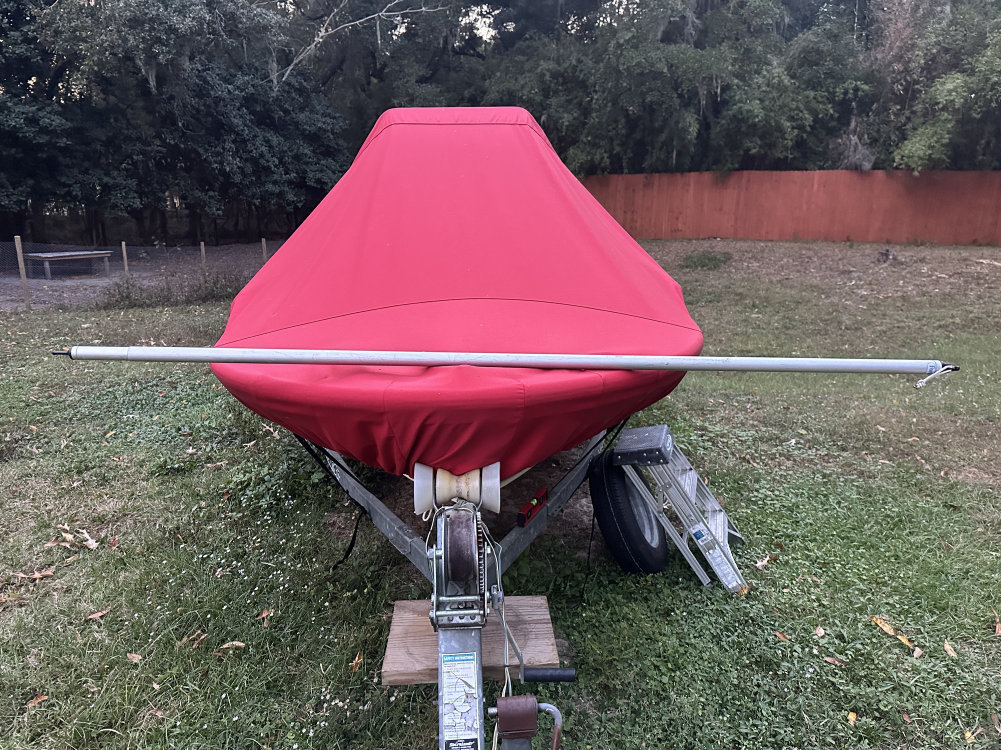

We have a 6-12' whisker pole which has a clip on the inboard end and a spike on the outboard end. The joint where the two sections of pole join are on the outboard end.
This seems wrong on multiple levels. Having the adjustment on the outboard end means you have to disconnect the pole from the mast and pull it toward you to adjust it. Doing this almost always results in the spike coming out of the clew, and the poking, jabbing, harpooning festival begins anew.
I want to replace the spike with a clip, turn the pole around, and put the adjustment end toward the mast. But SURELY there is a reason Forespar made it this way, and I'm just too dumb to understand it and use it properly? Then again, the whisker poles I see on bigger boats have hooks on both ends!
So who is the dumb one? Me, or this whisker pole??

Gene, can you post a photo or two of what you've got? I'm having a hard time picturing your set up. Tks.

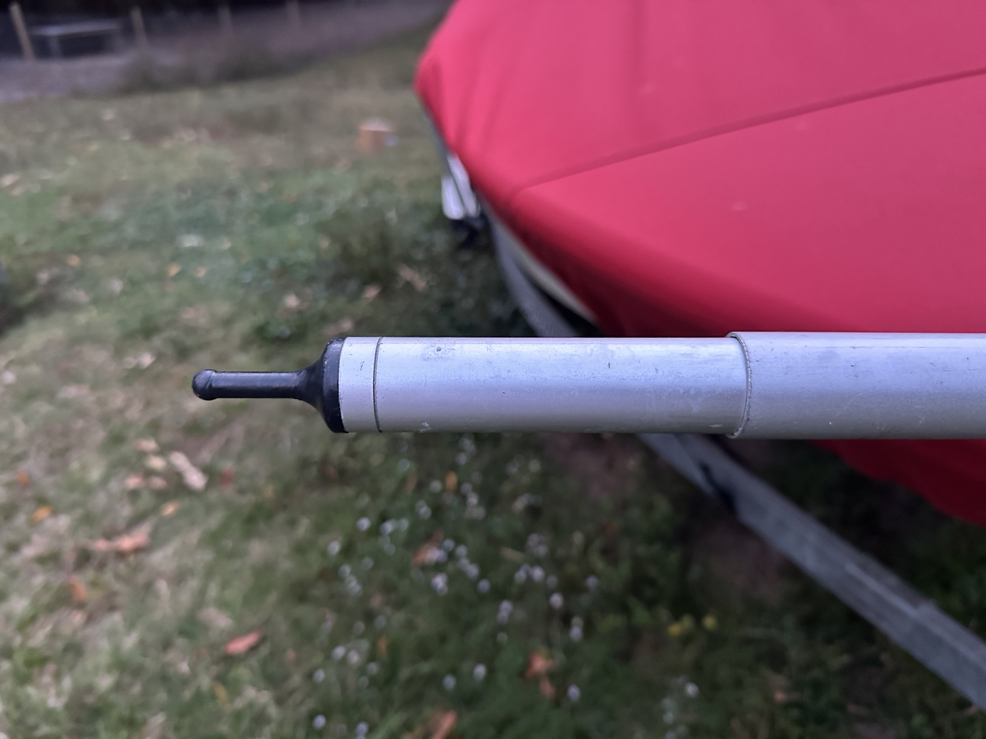

I think you can remove the spike fitting and replace it with a jaw fitting. Usually by drilling out a couple of rivets. You just need to know the ID of the pole tube. It's worth the time to consider the best configuration of the jaws. I've seen different configurations on various boats. The sail jaw should release down as, unlike a spinnaker, the jib wants to fall out. The mast side works better snapping it down on the ring than trying to push it up onto the ring.
Some boats do an end for end jibe and others collapse the pole and swing it through the forestay. I like the collapse except with a twist lock pole. Most boats I've sailed on put the pole jaw on the sheet near the clew rather than in the eye loop of the sheet. The latter is more secure but more difficult to achieve. You can always push the pole forward if it drifts aft.

I asked Forespar if I could replace the spike end with a newer clip end. The response was “not without considerable modification. The clip design ends are not the same size as the spike insert.” I have not pursued it further. Looking at the process I suspect it can be done but would need tools and some patience. Perhaps this winter will provide such time.

@jssailem that checks out. The ends are not riveted on, they are swaged. Replacing them will require some creativity, and some luck in finding fittings of the correct diameter.
Not sure it's swaged on
In the second picture it looks like there maybe a pin that holds the nylon piece in the tube similar to the way Sunfish masts and booms are manufactured. There is proba
If it is swaged on just cut it off at the swage and put a new whatever sort of end you want on. Loosing 3/8" of length is typically not an issue.
If you can't find an end to fit that portion of the tube rivet on a section matching the other end and use a matching hook.

If you can't find an end to fit that portion of the tube, rivet on a section matching the other end and use a matching hook.
Hey now! I had not thought of that. If I can find a replacement hook for this model of pole, I'll be in business! I could just cut a few inches off the end with the swaged hook, and rivet that assembly onto the spike end. Then rivet a new hook into the end I cut, and Bob's my uncle.
You're a genius.
There are definitely no pins or rivets in this whisker pole. I kept looking for them for years. haha

The replacement end kit from Forespar seems to imply the ends are epoxied on
If you put clips or hooks on both ends of a twist lock pole, will there be any issues with the ends not being in the proper orientation when the pole decides to lock up? On second thought, if that was a problem, I suppose you could mitigate it with soft shackles. emily litella never mind - Search Videos

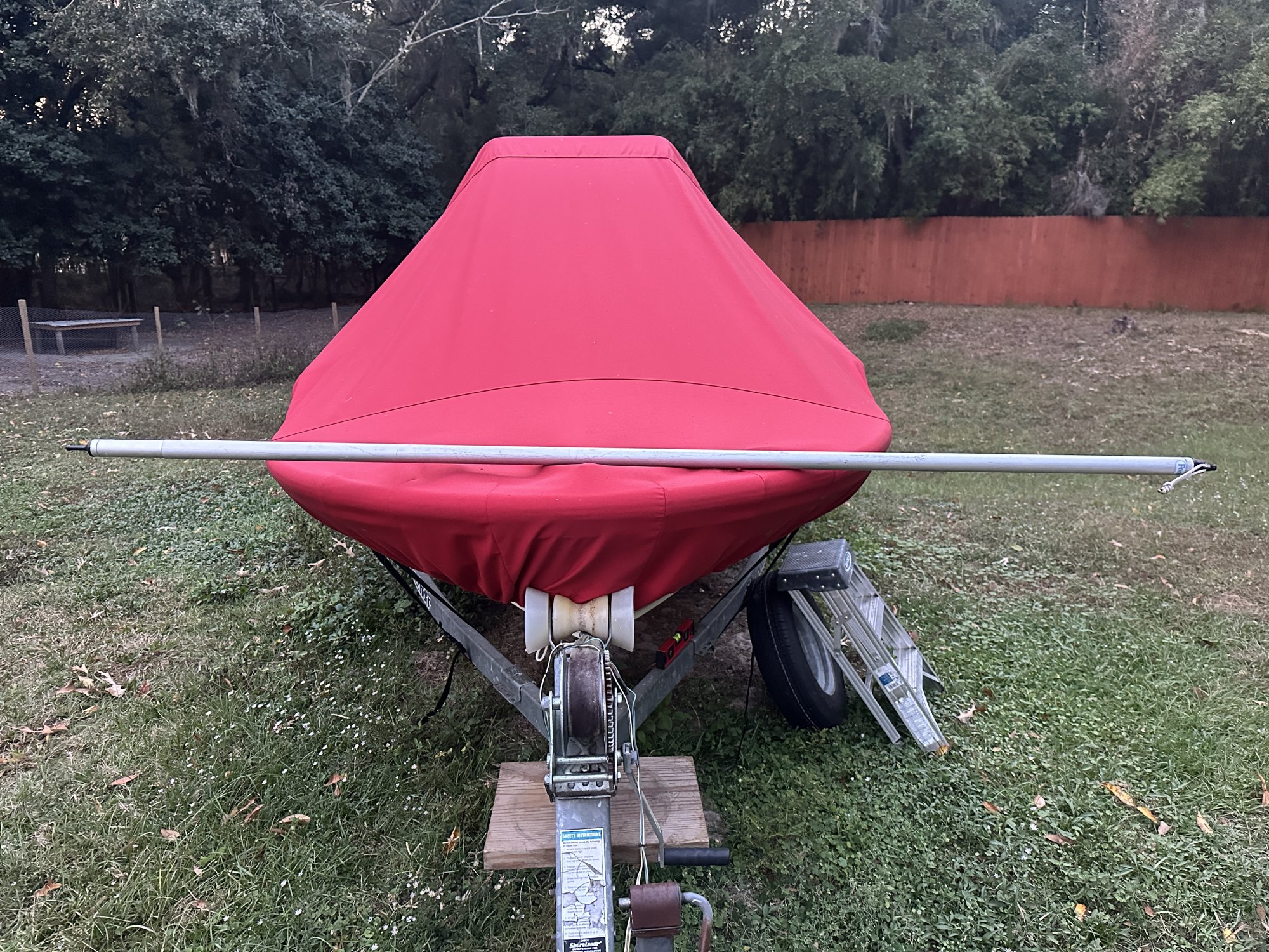

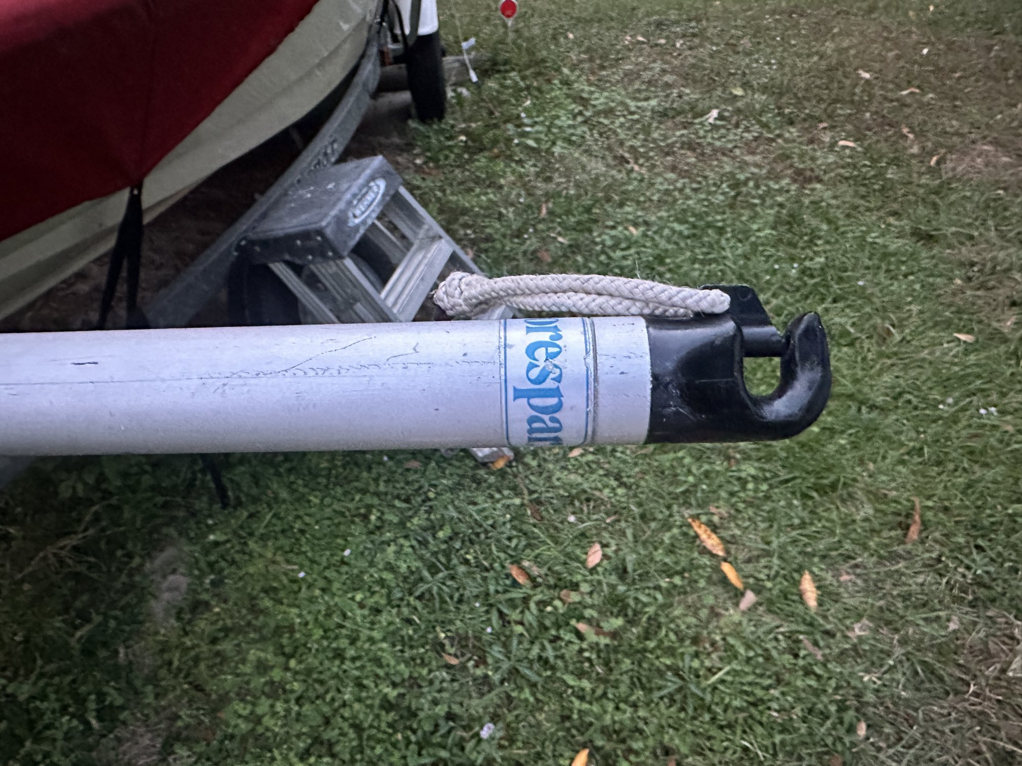

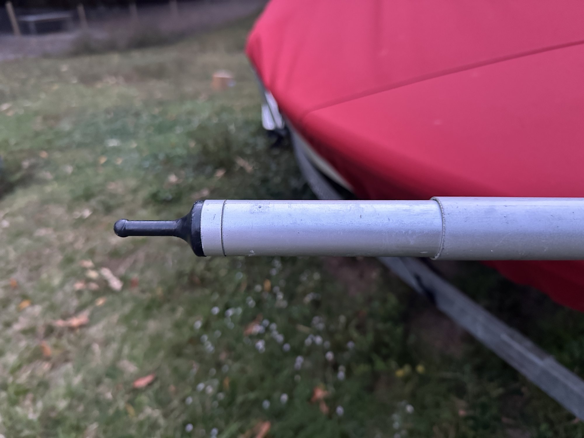

The type of Whisker Poles you are discussing and have posted pictures of have a tubing diameter and wall thickness, along with the black plastic endfittings intended for boats under 20ft in length and no more than 1,000 pounds displacement. On larger boats, the plastic endfittings are the weak link.
The first thing to mention is that these adjustable whisker poles are designed with the larger tube as the inboard end, which is attached to the mast.
The Forespar part number is 406000 for the type with the spike outboard and the piston latch at the inboard end. Part number 406100 will include spring-loaded latches at each end of the Whisker Pole. Again, the larger diameter tube is the end of the whisker pole that attaches to the mast.
Pictured is the endfitting repair kit, #300027. The one endfitting that is attached to the short PC of the alum tube is intended to convert a 406000 latch-spike into a latch-latch, 406100. That is the only reason that the epoxy is included in the kit.
Endfitting attachment: Forespar uses a pipe-cutter set to a shallow depth and puts the ring that you see going around the aluminum tube into a corresponding groove in the molded plastic end. That is how the end fittings are held in place. A new endfitting can be held in place by using a couple of small pop rivets or a couple of self-tapping screws. Any epoxy glue tends to get in the spring cavity, and then the piston will no longer move. If anyone wants to look over the PDFs for these whisker poles or has any other questions, you can use sts2@forespar for answers. Been doing this since 1988.
