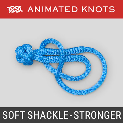

A bowline is the height of my knot-tying repertoire. How does one tie a soft shackle?

There are a few different approaches for that. The one I used for this was similar to
. Some approaches leave you with a loop with two lines, which I figured would be harder to grab with the pole, so I used the approach that ends up with only a single loop. Splicing the dyneema is remarkably easy. The hardest part I thought was the stopper knot at the end.

I have used the technique described by David. It works. An perhaps is a little easier to tie than the Brian Toss Soft Shackle. I prefer to tie the "Toss" soft shackle due to the improved strength.
Here are 2 video links. If you have questions I would be happy to try and answer.
I encourage you, when burying the tails, to taper the ends. It makes the knot much stronger.

The stronger version is what I’ve tied for some spare general purpose soft shackles. It’s also easy enough, so a good tool to have in the toolbox.
