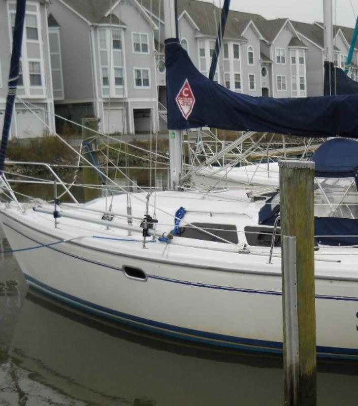

here is my whisker pole attachment.....I am actually thinking about taking it home and storing it there since I never use it :cry:

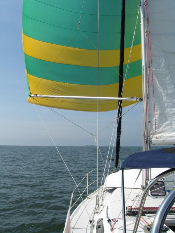

Up the mast on a track. I use the upper section of a carbon windsurfing mast with a tang on the end, light, strong. I had previously used this arrangement for many years on my Hunter 37 racing in non-spin. Very effective and efficient. We could get the set around the mark faster than anyone else.
Are you stating you do not use your whisker pole? Why?
There are so many times I wish I had one to deploy. If you really do not really plan on using it, perhaps consider selling it?
