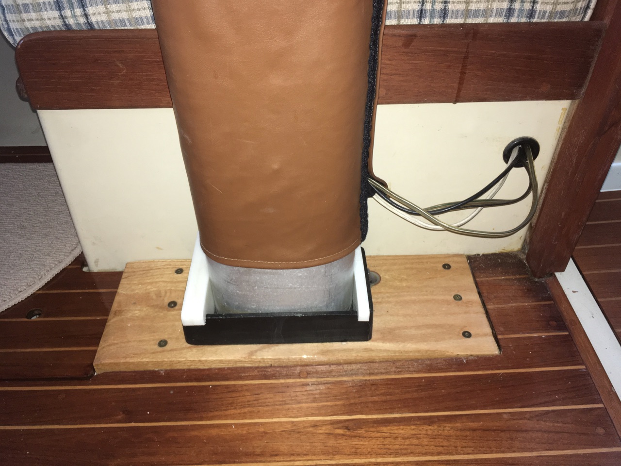

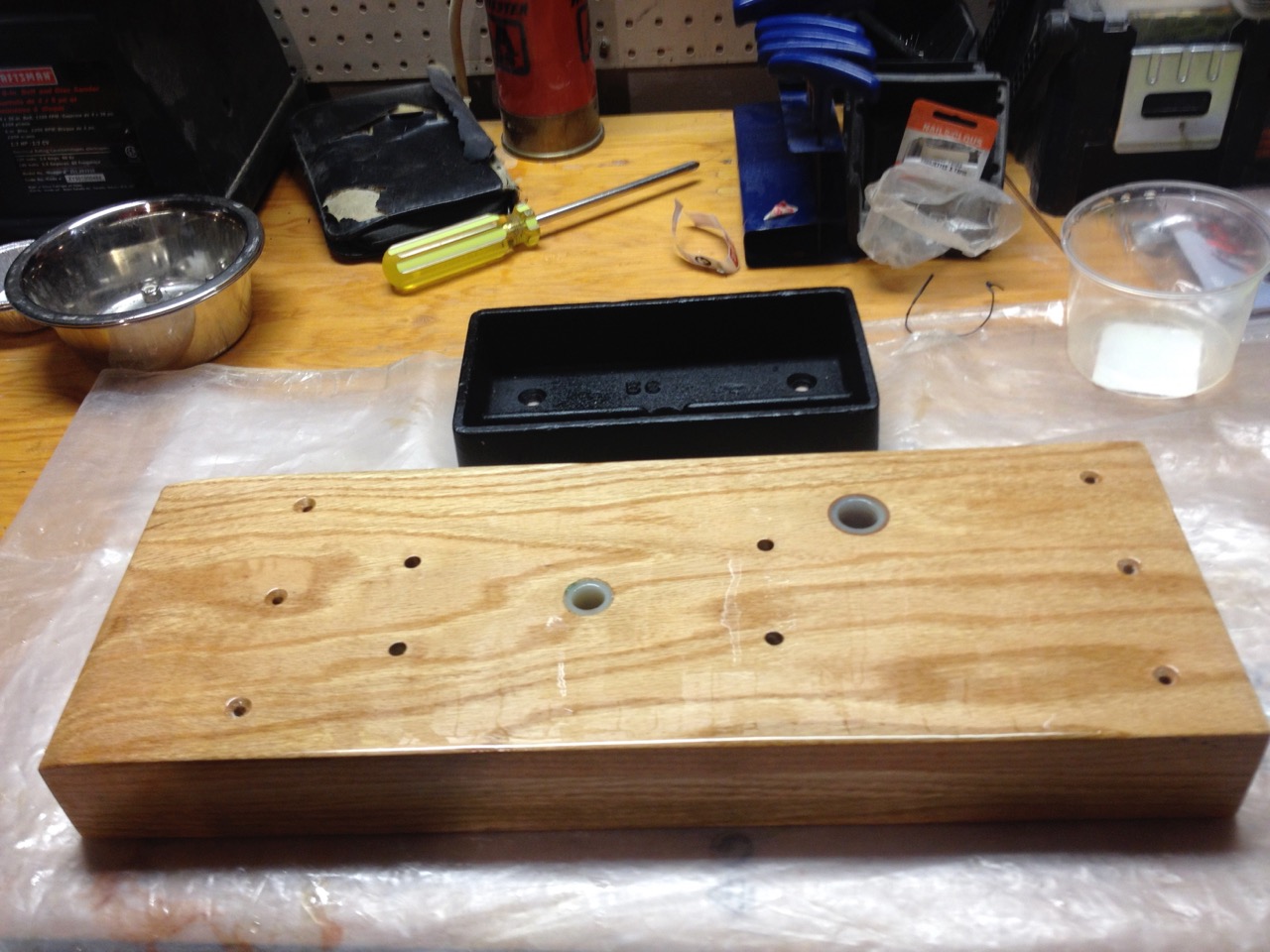

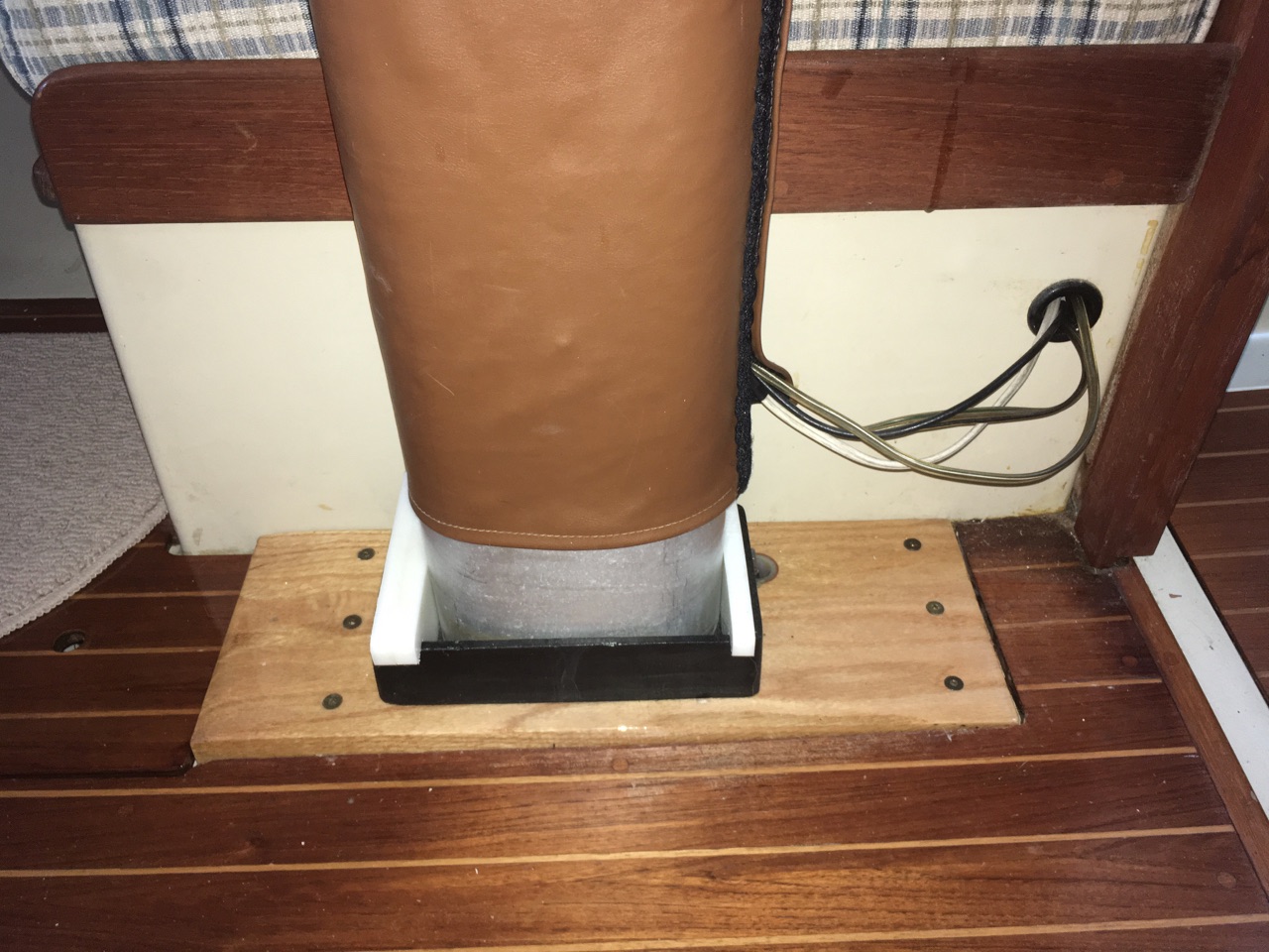

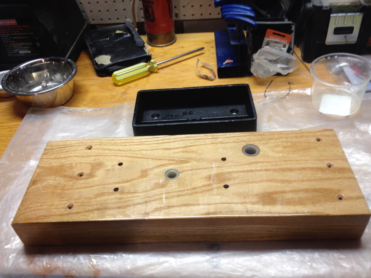

(The photo shows the new one my friend made for his boat, with the drain holes both lined and sealed)
If there isn't much difference, I figure will just laminate one. Wood would be easier to buy and as a bonus, likely cheaper.
