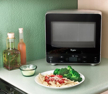

Bummer: I just dropped $130 buying this nice little microwave, only to discover LATER that it doesn't work with my Freedom 20 Inverter. Dang!!! :banghead::banghead::banghead::banghead::banghead:
Obviously, I don't need a large microwave on my boat. This one was just .7 cubic feet, designed as a corner unit, and neatly fits in my galley. It's all great, except it doesn't work.
Since I bought the unit, I found out that my inverter produces a "modified sine wave", not a TRUE sine wave. OK: Lesson learned (the hard way).

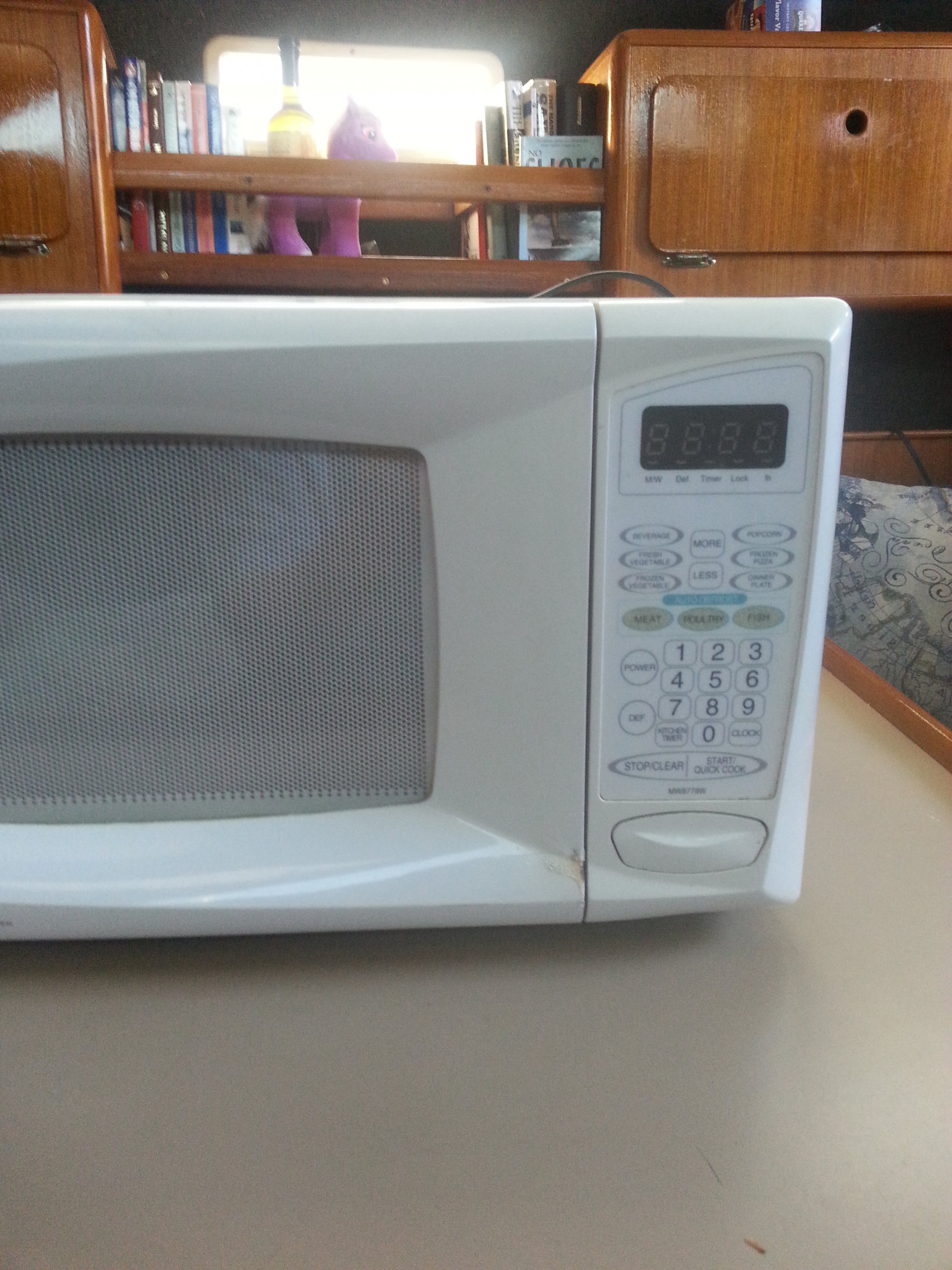

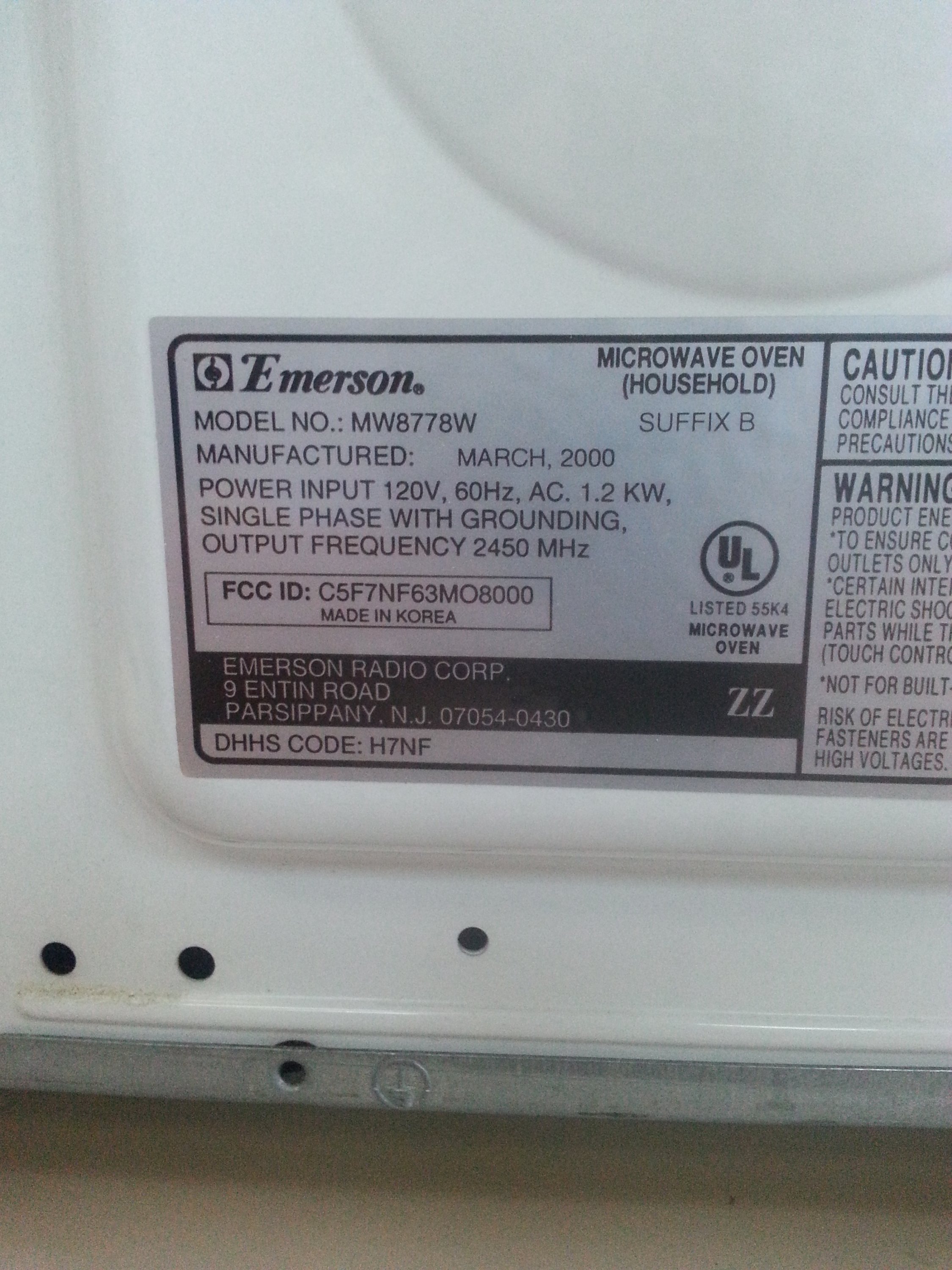

UPDATE: A couple of things. I successfully adjusted the "idle" adjustment on my freedom 20 so that with no load, the output produces a full 115VAC (RMS). Still, even with full voltage, this microwave didn't work. However, I WAS successful in getting a microwave to work with my freedom 20 inverter, but it ended up being an older unit.
For some reason, an Emerson MW8778W, circa 2000, works perfectly, with no apparent power loss. I timed how long it took to boil a cup of water with shore power and with the freedom 20, and it was within 10 seconds of each other.

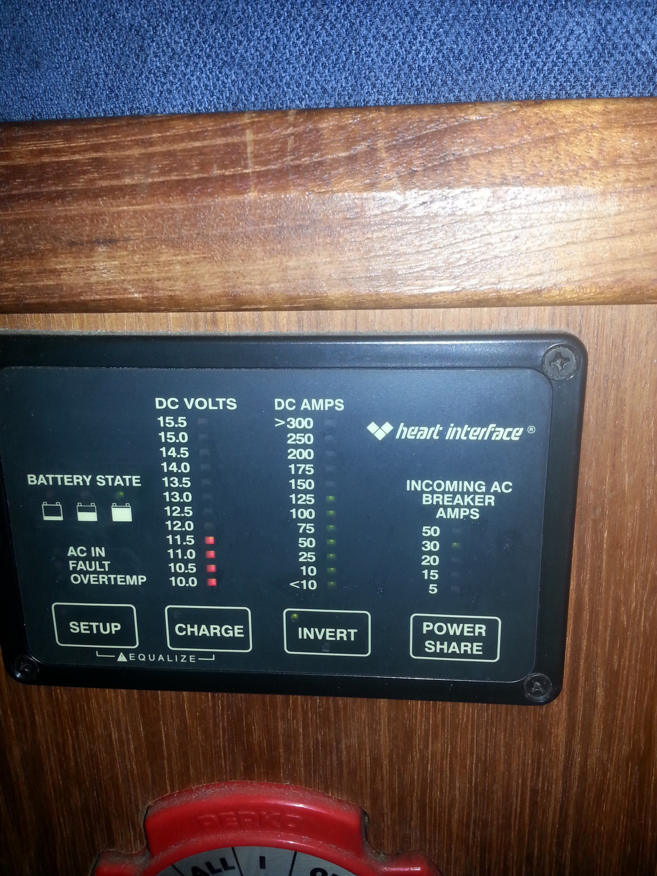

You can see from my freedom 20 remote that it draws over 100 amps. I've concluded that the engine should be running when I use it.

Sorry -- There is such a lack of proper information it is baffling. A clue is as the nameplate last line says ." WITH GROUNDING." A microwave uses the ac + and - via a doubler and transformer to make up the NEGATIVE Hi voltage for the microwave tube. (See if you can find a ground.) The Anode of the TUBE, THERE FORE, is GROUNDED ----AND THAT IS THE CABINET GROUND, NOW IF I DISCONNECTED, THE TUBE ANODE, EVERYTHING WOULD WORK EXCEPT THE MICROWAVE AS IT HAS NO MINUS path For conduction of the -2400 . ( + -)
I think I'm giving up----when I saw the author state the Freedom draws over 100 AMPS --WE ARE NOT ON THE SAME BOOK OR PAGE !
