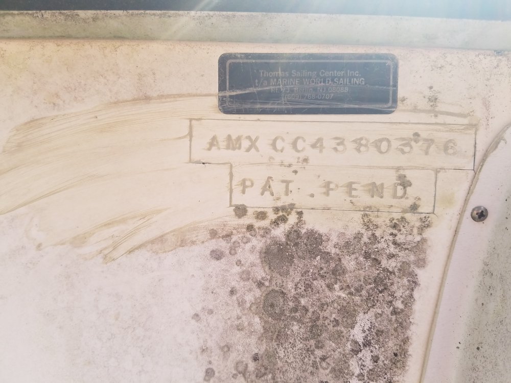

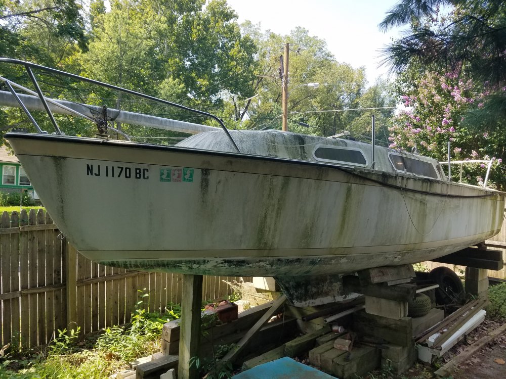

That looks like an old American 23. They were poor sailing boats and not very well constructed. Be sure the owner gets rid of it before you buy the property as that boat is not even worth fixing. If you want a 22 ish footer look at a Catalina 22 orr an O'day of that size. You can buy one in near mint condition for a fraction of what it would cost to fix that one up, and you'll have a better boat..

That bow rail has to be worth something right there. The rest, well, probably not so much.

Even in that picture there appears to be some form of damage to the hull/deck joint. The rub rail hanging down is bad enough but not necessarily a show stopper, but the fact that the extrusion is missing could be a sign that the hull took a hit.

Friend of mine recently got a "free" Tanzer 22. So far, he has spent about $5k in repairs, upgrades, and a new OB and other equipment. So, sometimes "free" really isn't. However, he was looking for a project boat (and the pictured boat in this thread would be a classic example of one) to keep him busy in the boatyard as he has a lot of time on his hands. So it meets his needs. Make sure your "free" boat meets yours.

Hello all, I'm buying a house and the owners are leaving their old sailboat behind, pictured below. So if anyone can help with who the manufacturer is, boat length, etc I would appreciate it! Also, assuming almost everything in this boat needs to be replaced, what should I expect to pay just for parts? Thanks all for your knowledge.

I'm guessing there are no sails with that boat. You can buy a better boat that is ready to sail today for less than the cost of the sails you need, never mind all the rest of the hardware that will cost thousands. If you haven't closed on the house, you really should make the seller get rid of it. Do yourself a favor and don't take possession of it. That looks like it could just as easily be a Lake Hopatcong or Greenwood Lake neighborhood. You can find a lot better derelicts than that in a five minute radius, I'm sure.
