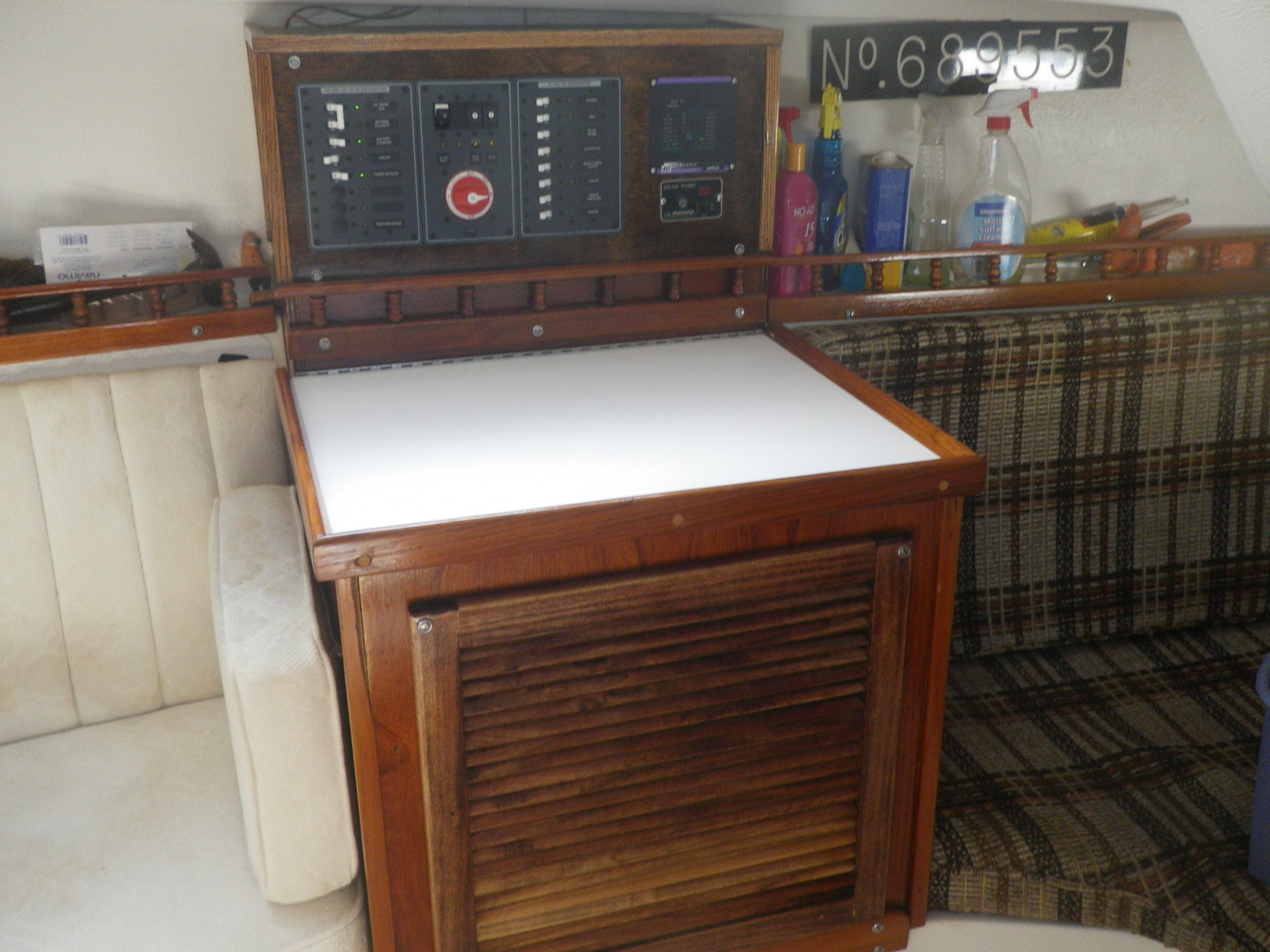

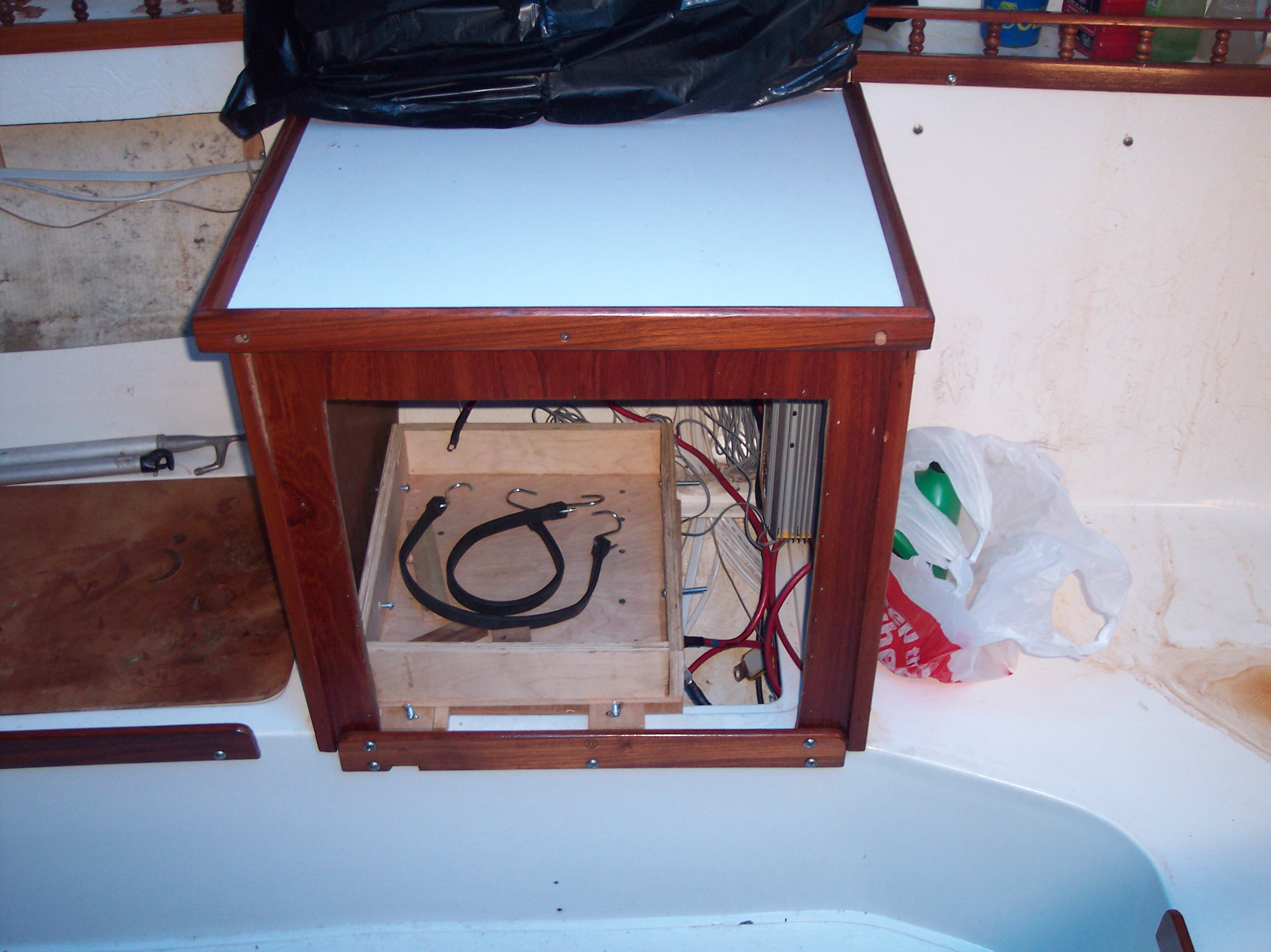

I put 4 T-105's under the nav table. I built a wooden box to hold them. The picture enclosed was for the original 12volt batteries I used. I had to modify it to fit the 4 Trojans. I then built a louvered door that is Velcro'd over the opening...I had to build that from scratch, there was a kit to make louvered doors but it went out of stock.
The system supplies about 450amps on paper.

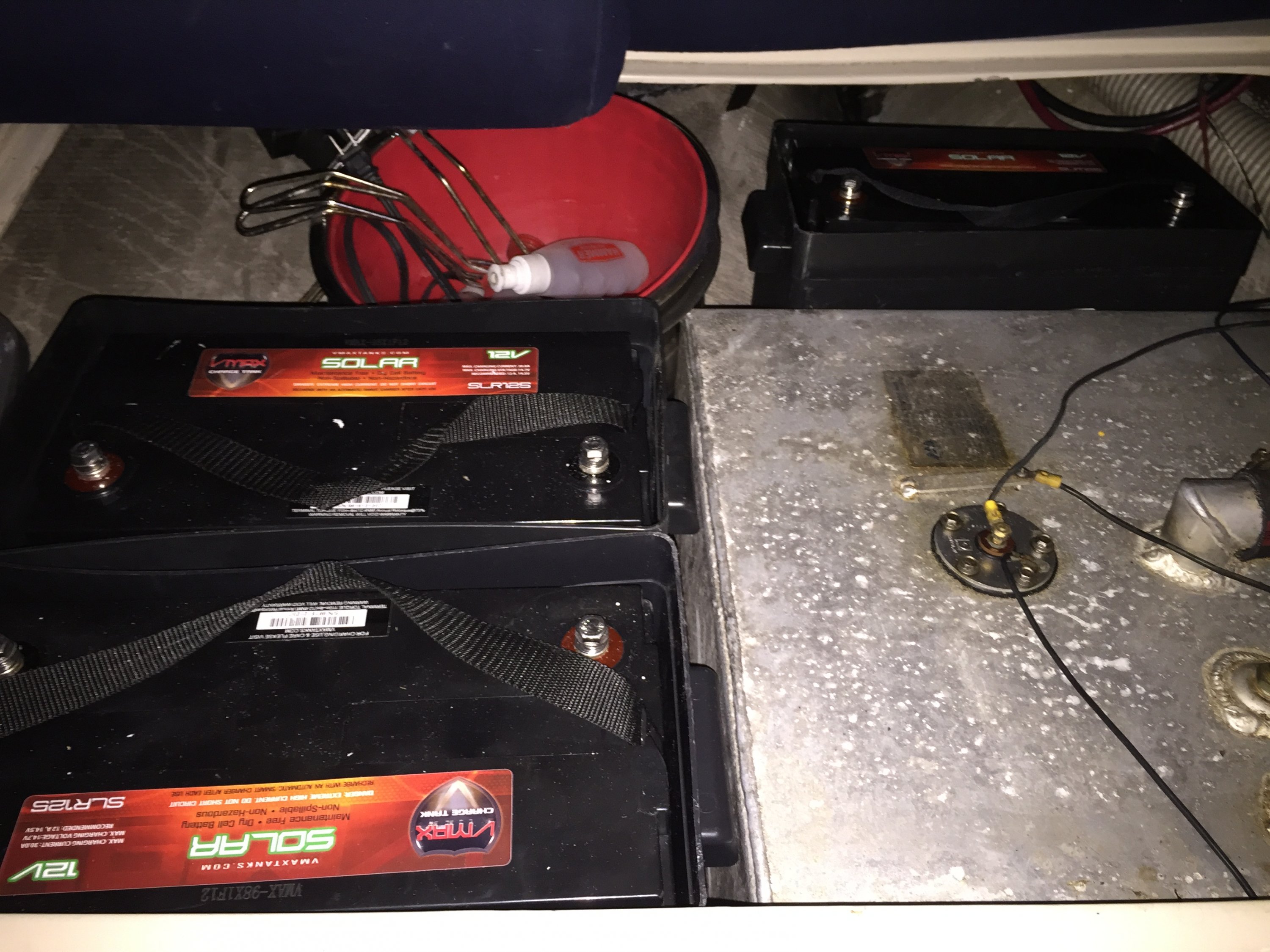

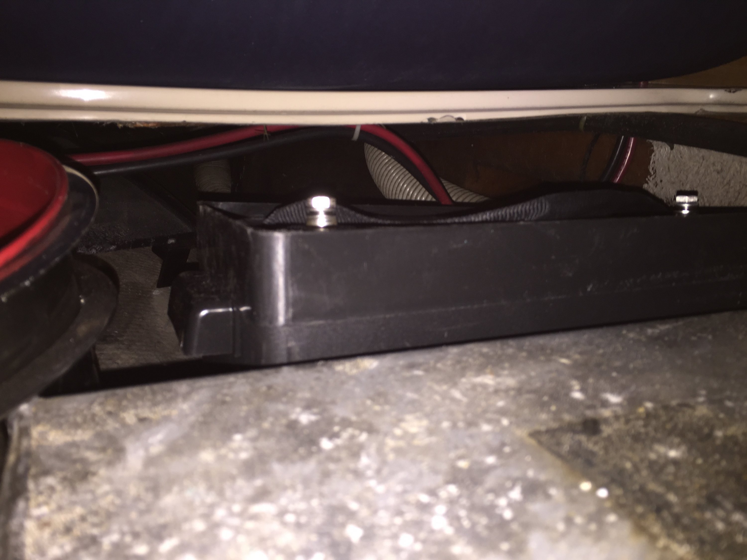

For what it's worth, I stuck three VMax125slr 12V batteries (375ah total) under the quarter berth in simple ABS battery boxes with wooden slats built to accommodate the hull angle underneath. Easy to change later if necessary. I could have fit four of them total by cramming one more aft of the fuel tank but they are expensive and it would have been a total pain to get them in and out if necessary.
