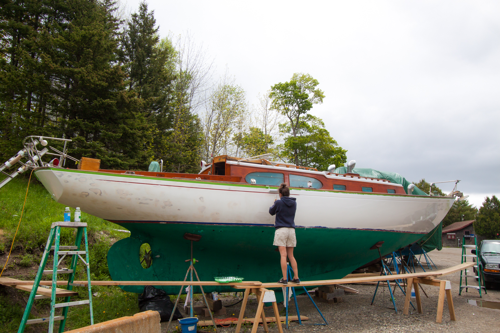

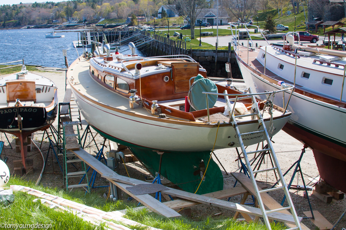

I see people struggling in the boatyard with buffers. I find their problem isn't the tool so much as where they work from. Usually they work from the ground, sometimes a step ladder, but usually their tool is too high.
If I was going to buff my topsides, I'd hold the buffer at the most comfortable working height - standing on the ground, and measure the distance from the tool to the ground. I'd use that number to devise the height of a simple staging that would place my hands and tool in the middle of the work area on the topsides.
It may look like a lot of work but it's not in comparison to holding a heavy tool over your head, or shifting block and tackle counterweight arrangements around.
The last time I rolled and tipped the topsides of my 38'er, friends buffed the hull of a 24 sailboat. They spent two short days (couldn't take anymore pain!) going around the hull with no more than a rickety step ladder. My daughter and I rolled and tipped the 38' in 4, easy hours.
You wouldn't need this length of staging to buff a hull, but I might do it anyway as it's easier to set up a full area as opposed to setting and re-setting short sections.
Move your staging from one side to the other as needed (BTW, that's the 24'er next door).

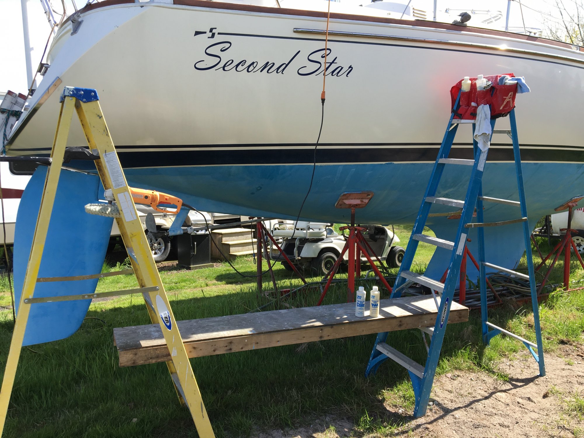

i've used an old searscraftsman double handle buffer with a support line suspended from a carabiner running thru my lifelines. also use a ladder that folds into a horizontal painters' platform, or an upside down v , not a regular ladder. it's a miserable job however you do it.

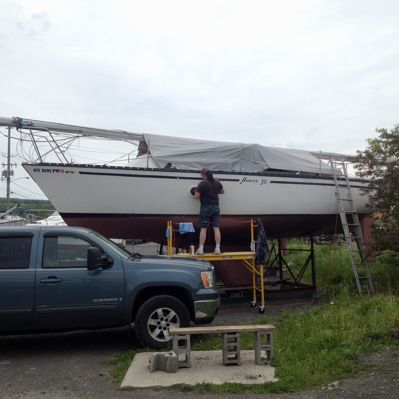

Having sided my house using scaffolding, I'll agree that it's hard to beat the safety and comfort factors. Compared to using a ladder. Scaffolding wins hands down. Setting up the scaffolding is well worth the time and I would not encourage the boards-n-ladders configuration.
Now, having that experience, I would certainly use scaffolding for repairs and other long term projects up high. Maybe rolling and tipping too because there's some exchange of equipment in hand and being up close affords better visuals. And, moving over a ladder every two square feet is a p.i.a. But, I wouldn't do it for buffing. Not until I try the counterweighted suspension method first. I can see a slight issue jumping the loop or trolly, over a stansion to the next section of lifeline but that doesn't sound like it'd be too bad.
