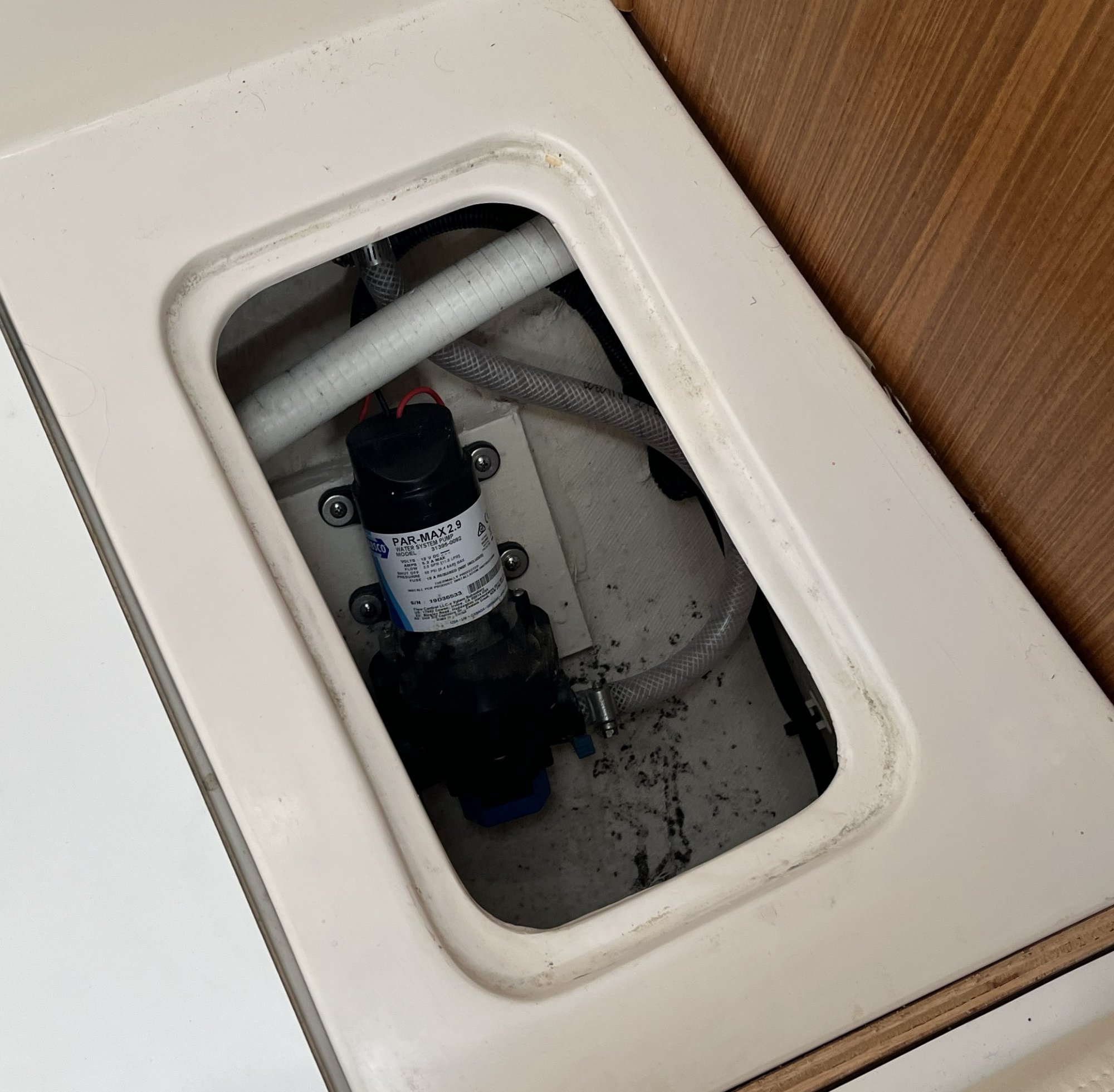

Catalina 315 Noank
I do not have a TV installed, but I do have a breaker for the TV.
I assume Catalina ran the power wire somewhere to the Port side, potentially under the salon settee, and then capped the wires.
Can a 315 owner show me where their TVs power it routed?
Is it inside here, near the water pump wiring?
Sep 25, 2008
7,751
Alden 50 Sarasota, Florida
no personal experience but I suggest you open the panel to see if any wires are connected to that breaker. Just because the panel label is there doesn’t necessarily mean anything. If there are wires connected, at least you’ll know there are wires somewhere.

On examination of the breaker panel it appears the wires were not installed to the circuit breaker as had Don suggested.
Now I have to figure the best way to get the wires over there.
