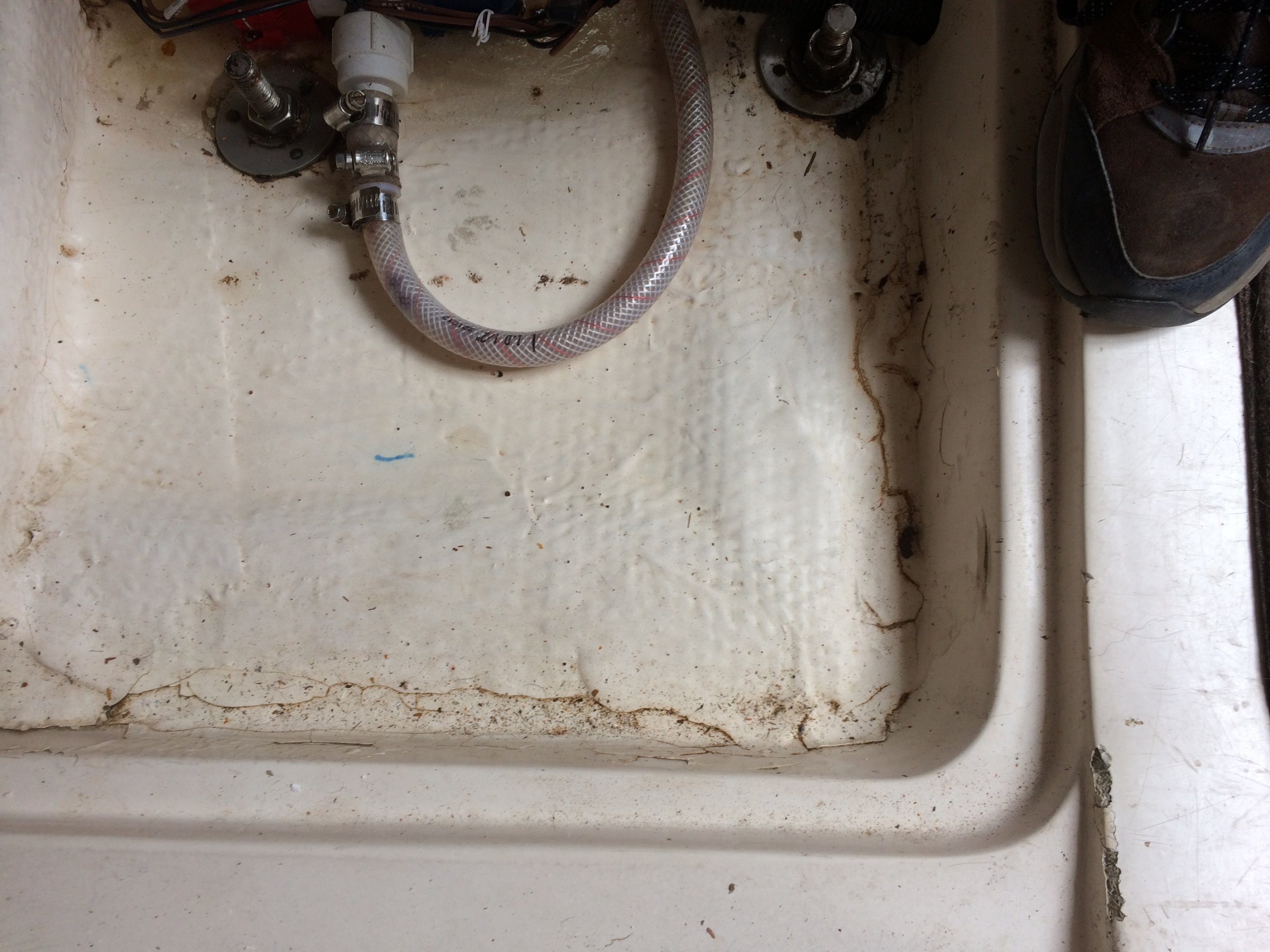

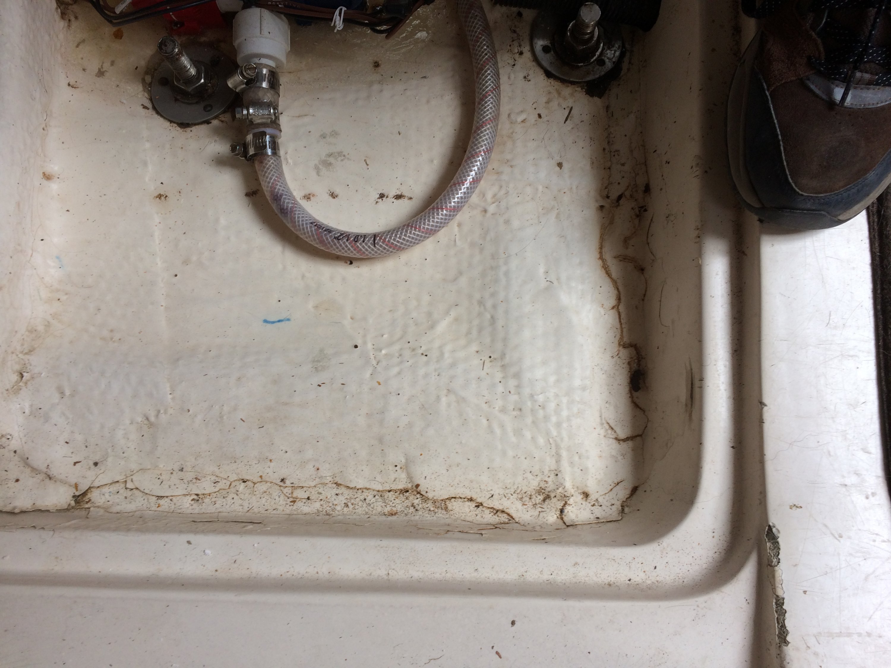

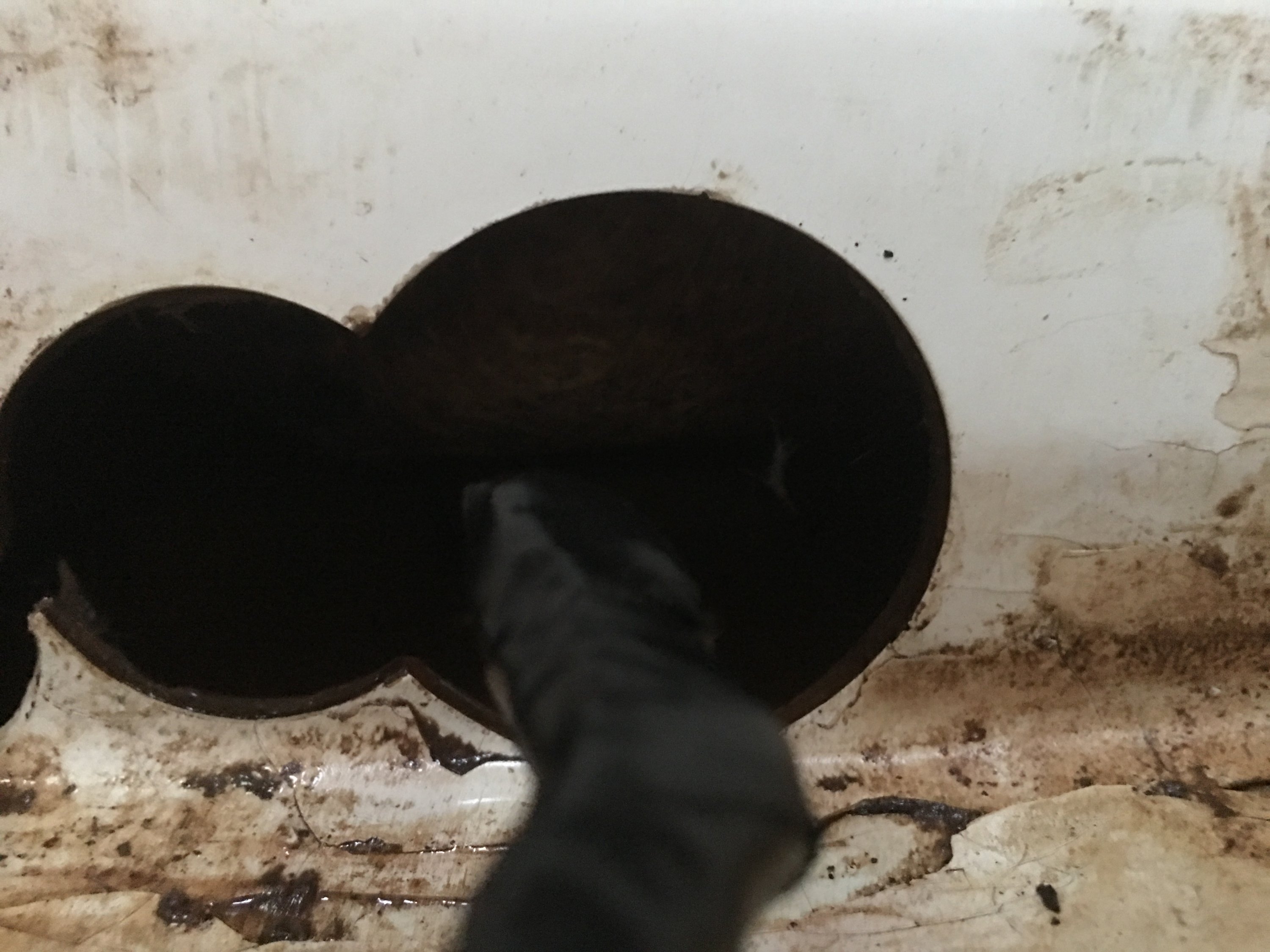

This shows the depth of both the bilges in the main cabin. Definitely no room for a sump pump there.

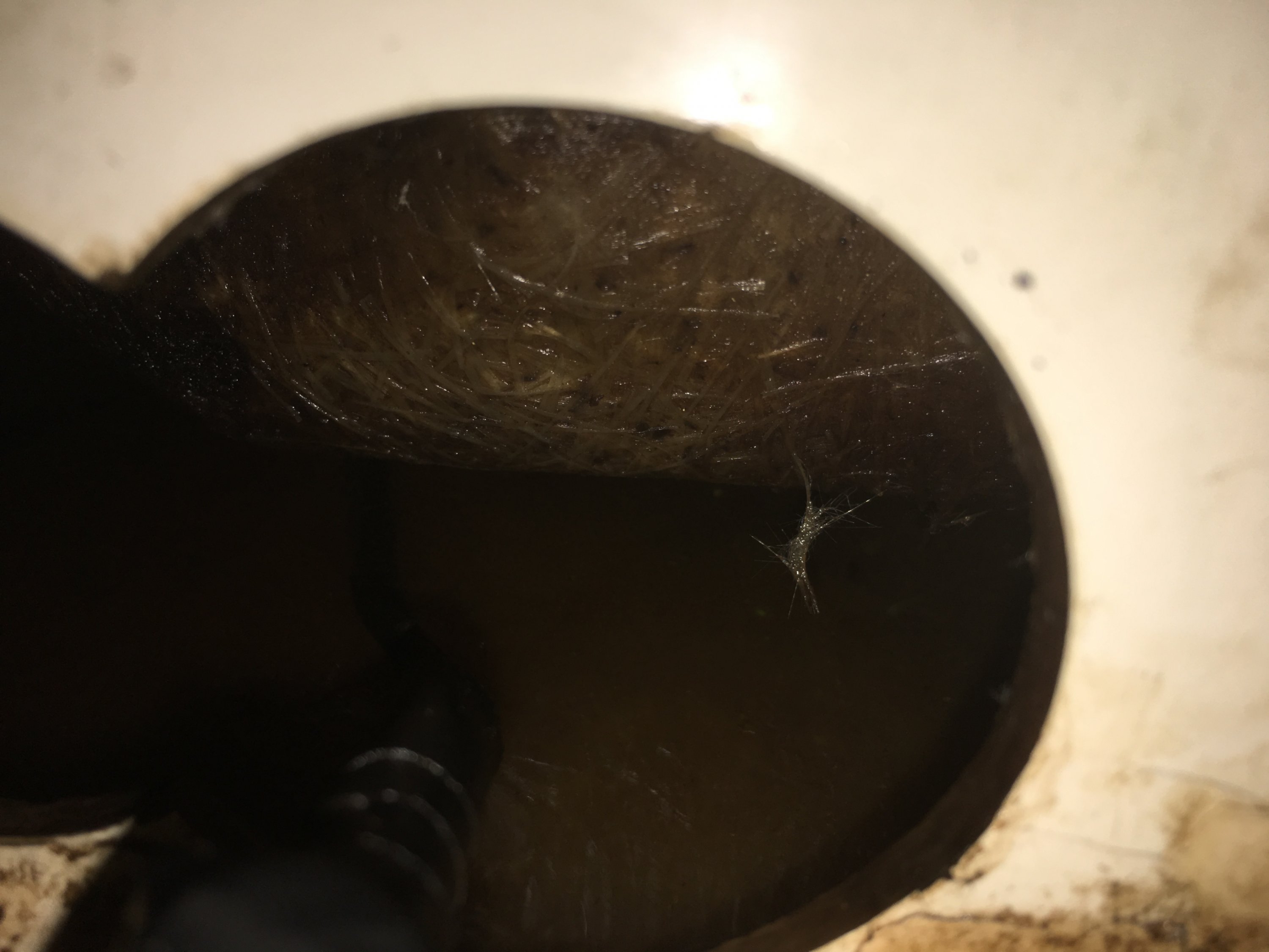

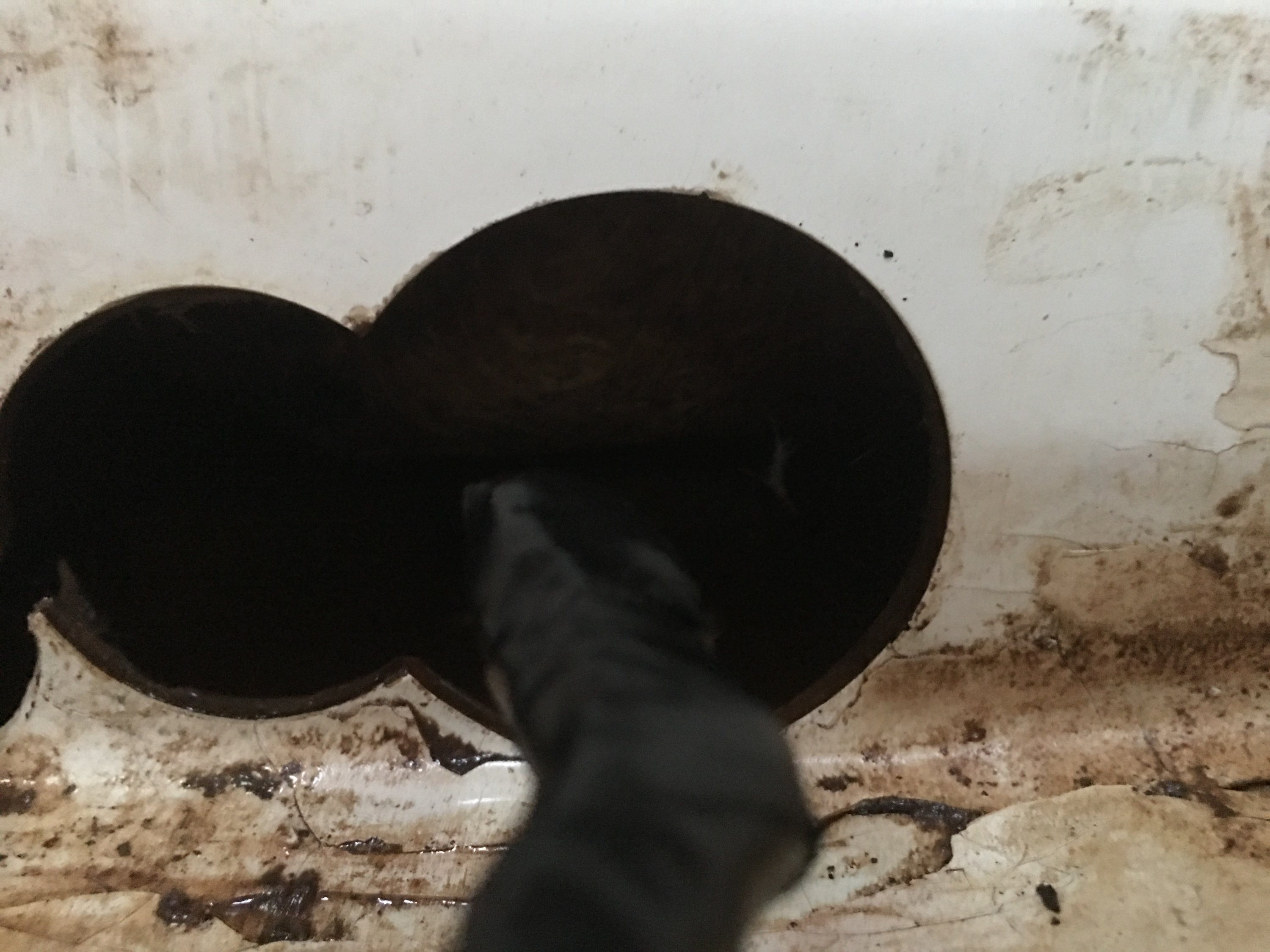

This is what it looks like. The holes drilled are about two inches aft of the head drain.

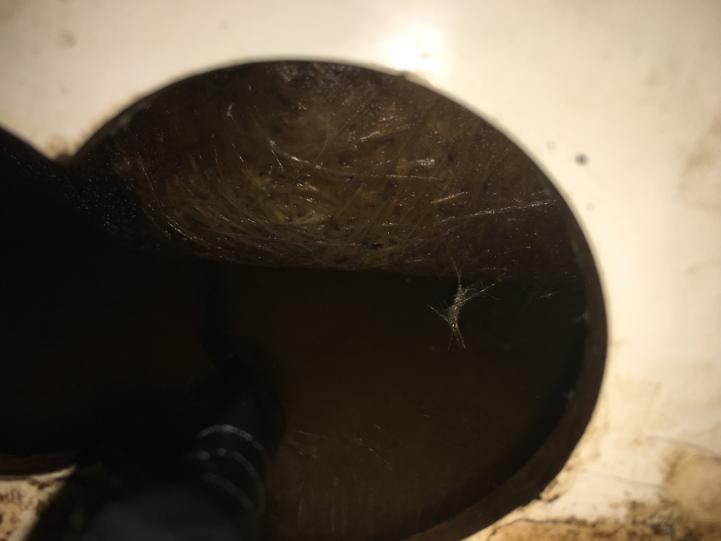

Someone asked what was under the head floor so the other picture is what it looks like.
View attachment 134770 View attachment 134771 View attachment 134772
My 1984 H27 does not have a shower or a hole in head sole. The only visible access to the small space under the head sole is the 1/2" hole between the main saloon bilge and the head sole space. The hole is used to run wiring to the mast and to connect a grounding wire from the mast to a keel bolt. You do have space near the aft most keel bolts for a sump if it were no higher than about 5". It would mean drilling a larger hole in the fiberglass strut that separates the two bilges. If you "have" to have a indoor shower, I would go that route.

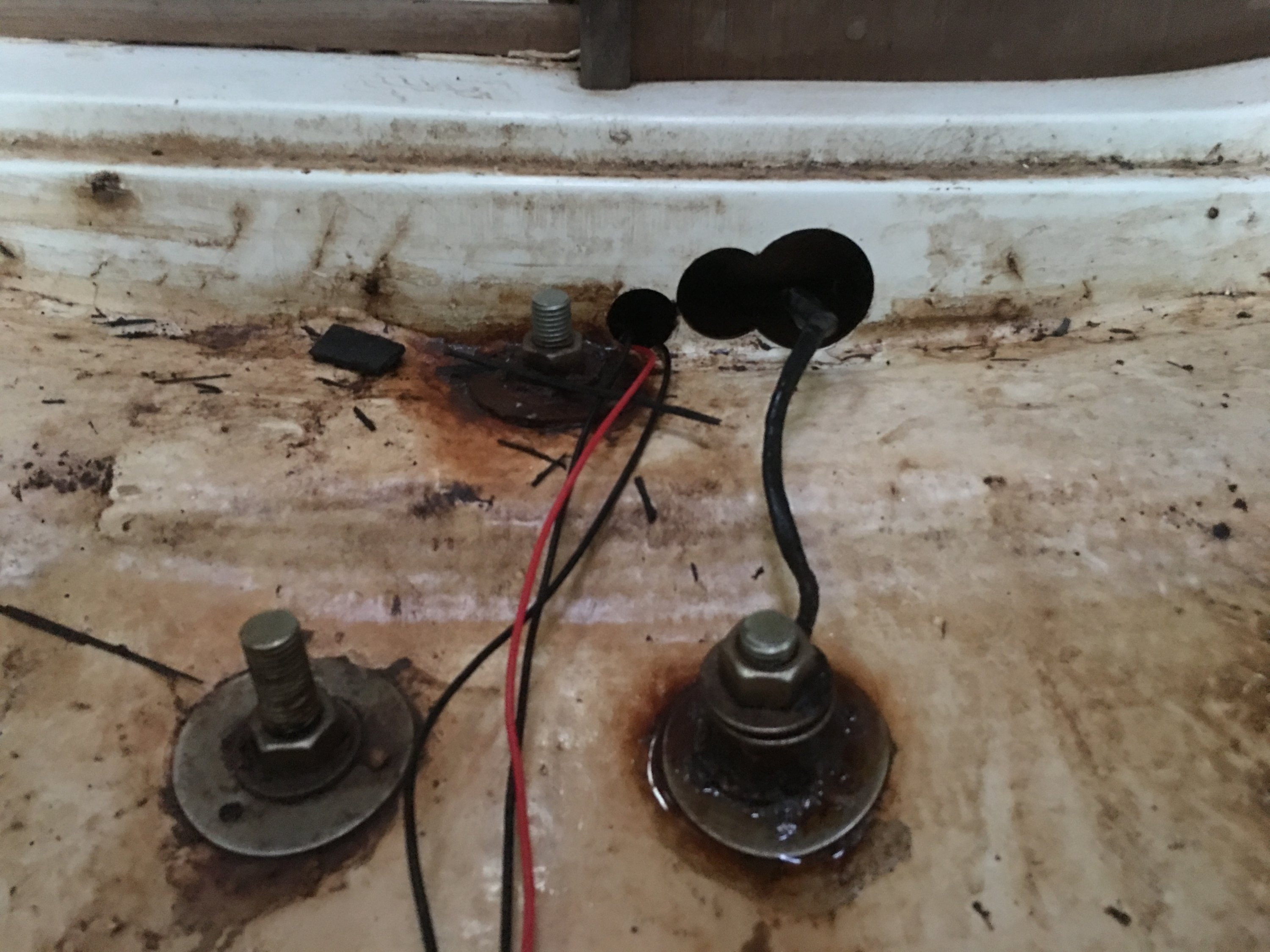

My main reason for doing this post was brought on by what I saw on your pic of your forward most keel bolt. That is a lot of rust. Take a look in Hunter 27 Owners Mods and scroll down to Keel Bolt Repairs.
