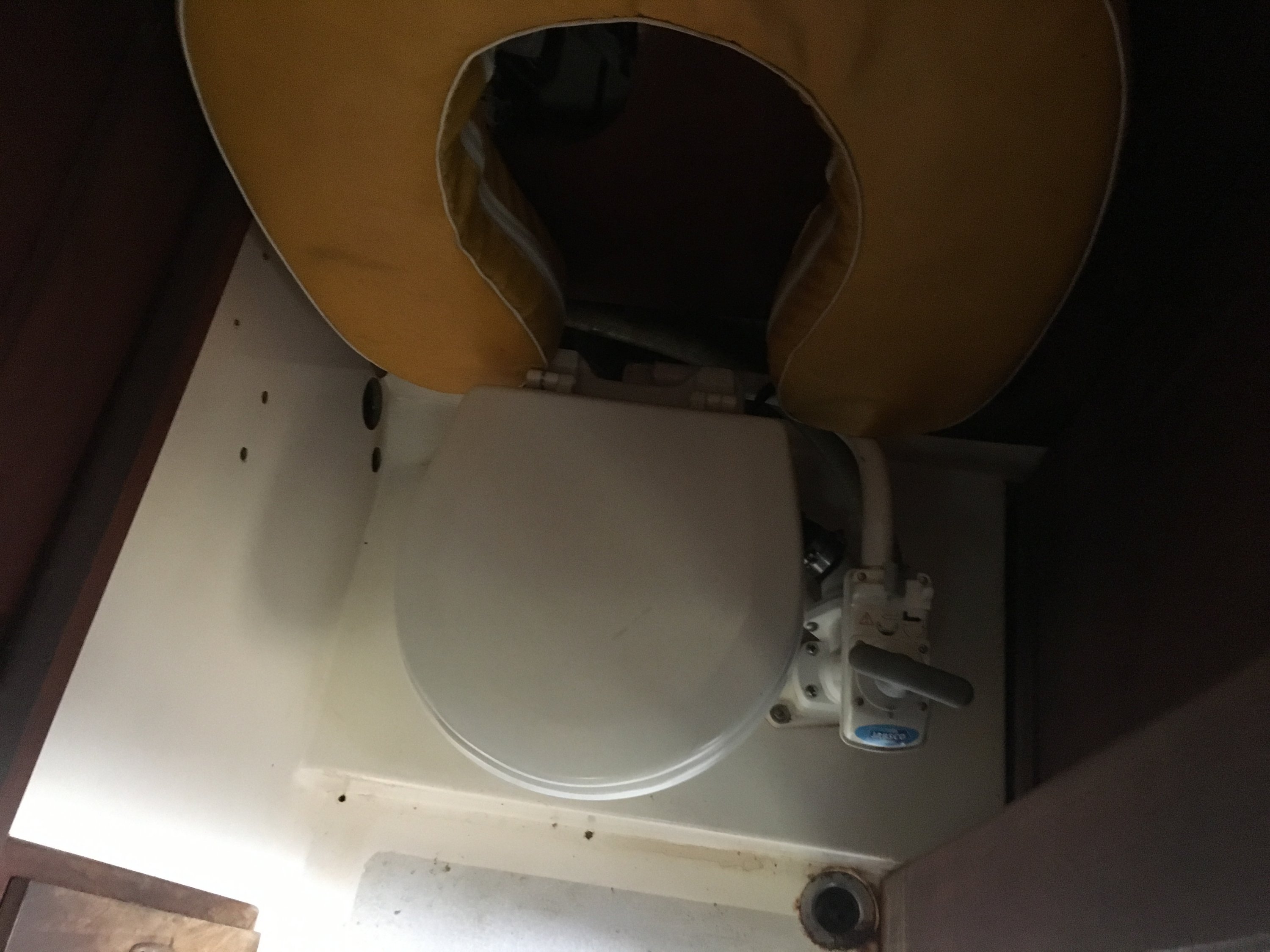

It's not a full shower. It's a hand sprayer off the sink faucet. And the "drain" is a small hole in the floor next to the mast. You can see mine in this photo, bottom right.
That's what all of them are on most boats--although most of 'em have a 3" drain with a cover similar to those in a shower at home.. The water that goes down that little hole has to end up somewhere, preferably in a sump.
