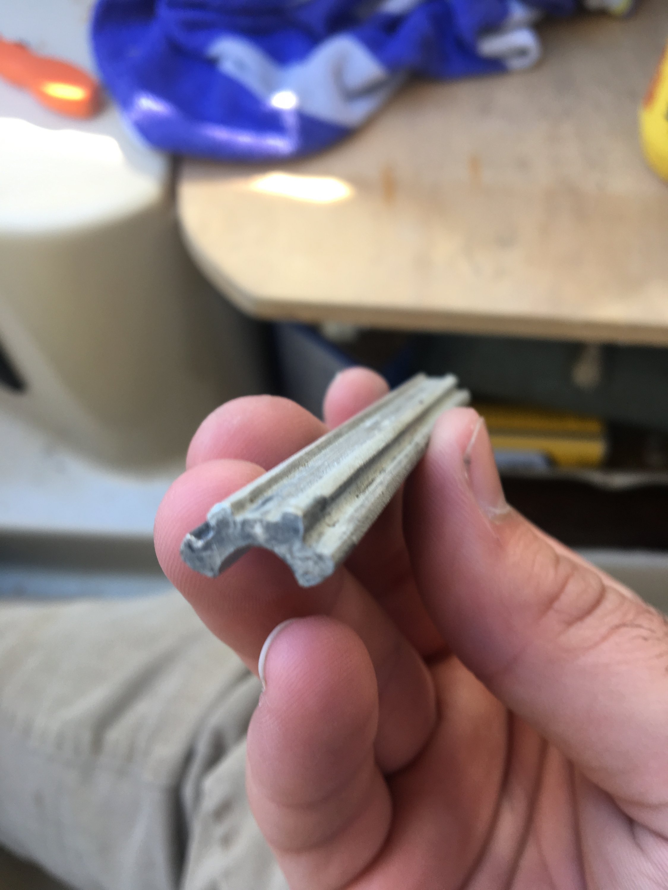

I just bought a Fixed Keel Catalina 22 and was sailing it this past weekend when my headstay broke. These aluminum pieces shown below broke inside my furler and I need to either buy new ones, buy used ones or make new ones. Would anyone know where to get theses?

As far as I know it was made by CDI. It is an older furler and when I called CDI they said they no longer make this furler. I am curious to know if anyone has run into this problem and would know where to get some replacement parts? Those little Aluminum pieces are ALL that I need to get the head sail back up and running. If worse comes to worse I will probably end up making a fiberglass mold and recreating them. Thanks for the quick response markwbird

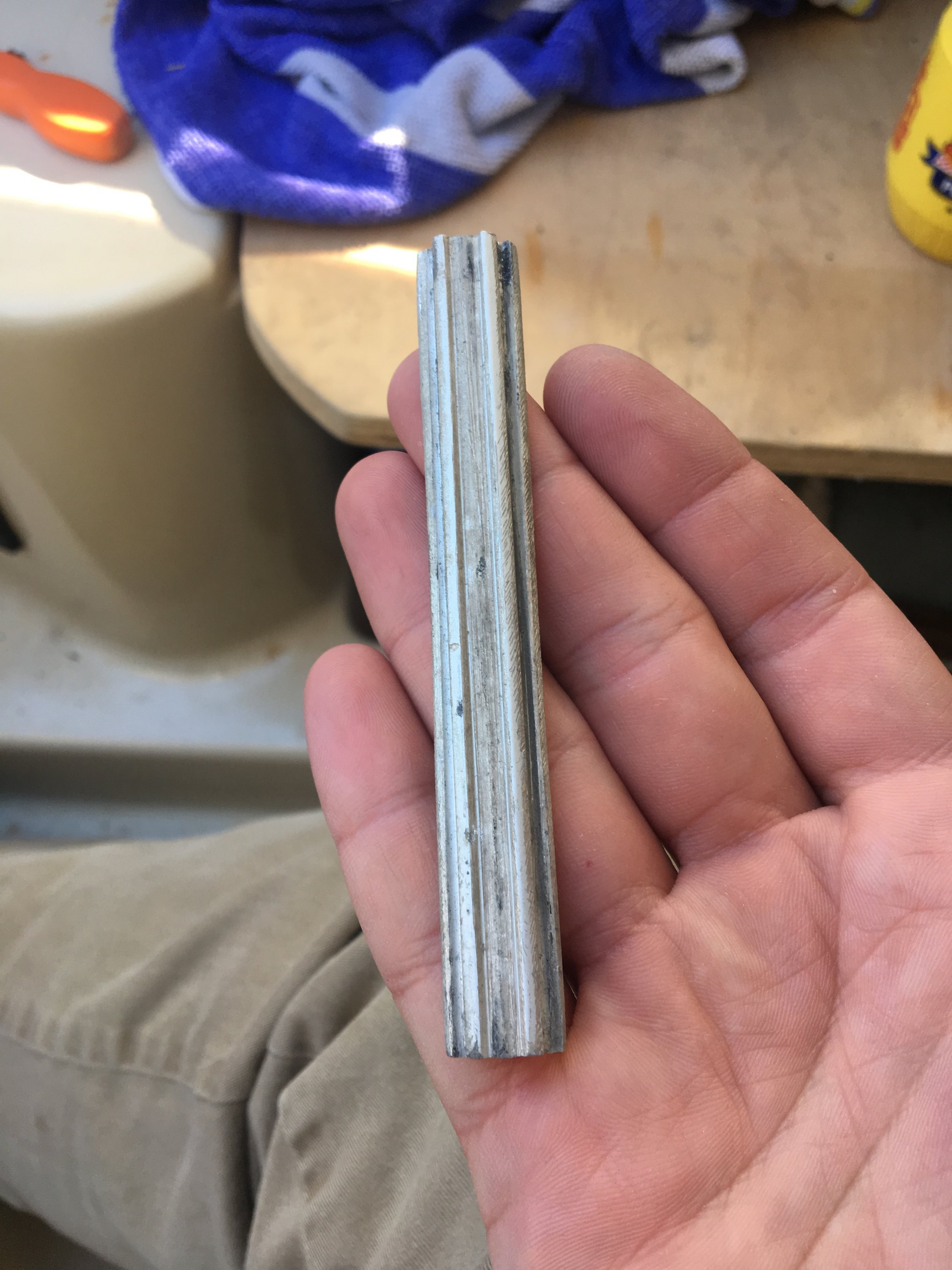

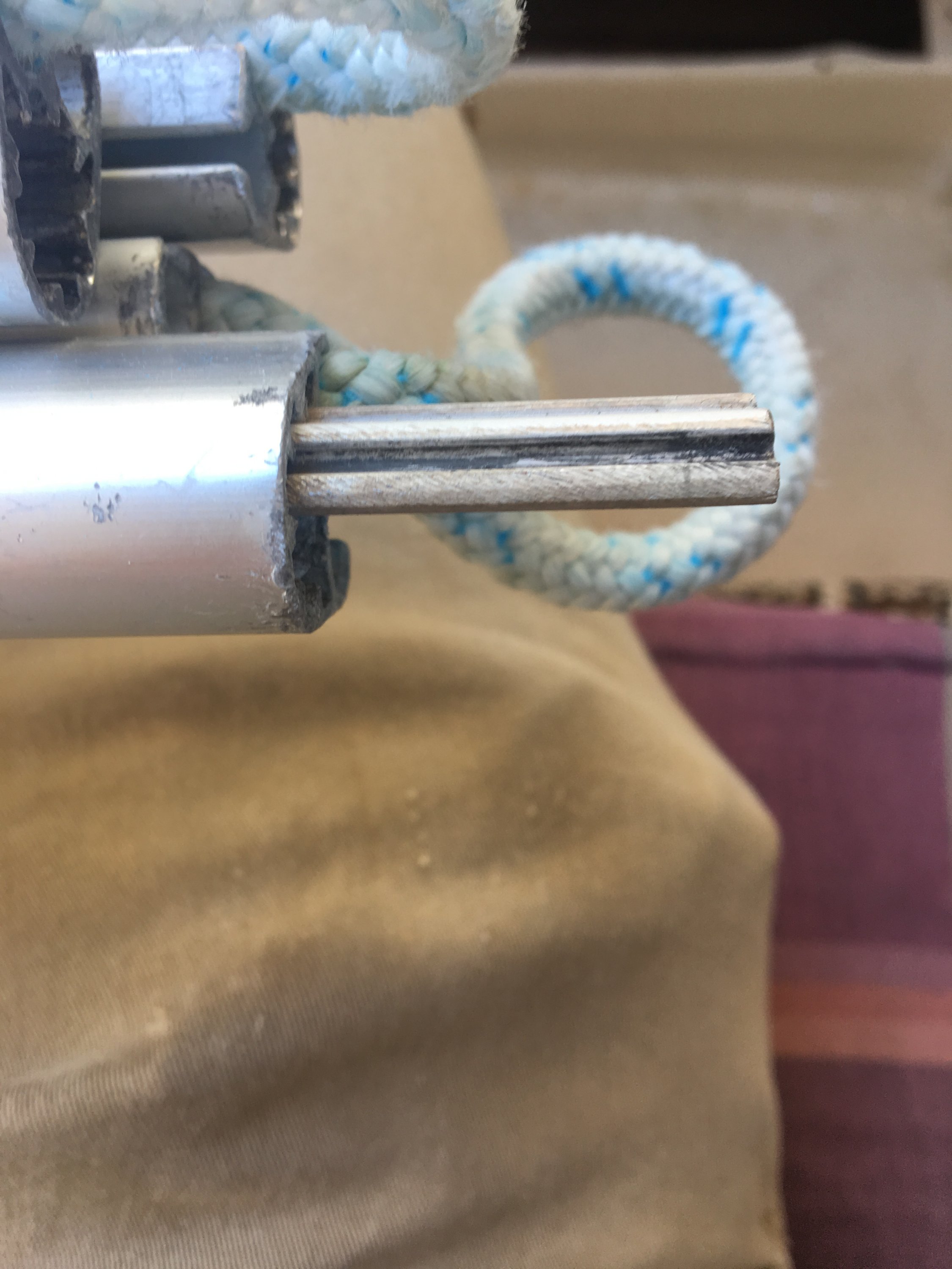

Ron20324. That piece in my hand is one of the 3 that survived unscathed. The other 5 are broken in half, multiple pieces, or bent down the middle. The good ones are 4 inches long and yes have those 4 splines. They butt up against each other to act as what I can only equate to as a bearing/bushing/locking piece that locks the furling pieces in place, to keep them lined up, while hugging the cable when the headsail is unfurled along the headstay. Excuse any miss names on the sailing terms. I am still really new at this as far as sailing terminology goes.

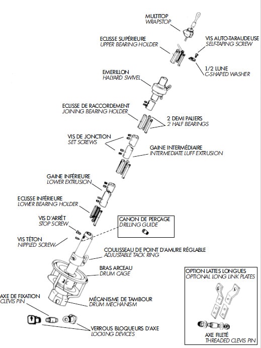

Those are definitely bearings.... usually held in place by set screws in the foil.
I've seen complete CDI FF2 furling units for $445.... before you start fabricating parts... check through the other pieces... swivel, drum, internal halyard, etc. might be cheaper and safer to replace.

These can get messed up when you raise or lower the mast when the foil kinks at the joints. We used to tie the foil ot he mast with some tension on it to minimize the kinks.
