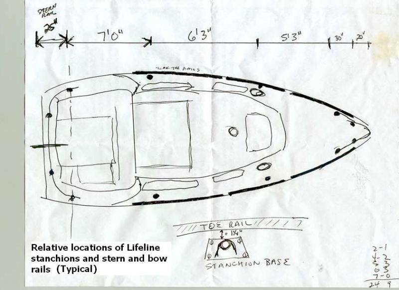

Thought a diagram of the layout of the stanchions and rails that someone posted might be of some assistance.
