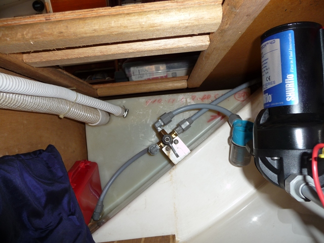

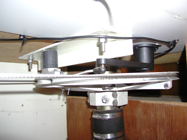

Mark, here is a picture inside the locker under the port berth, looking aft.. Original tank, selector valve, and pump and strainer. The other as Allen noted, is behind the cover at the foot of the berth in the aft cabin. If ya look behind the rudder drive wheel in the other picture, you can see the top of the tank right behind the wooden cover..
