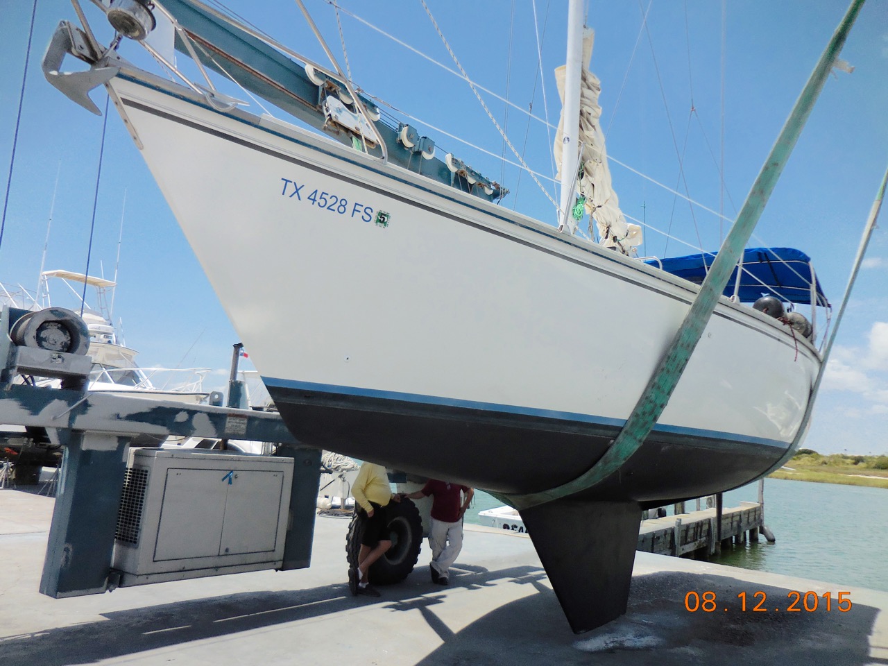

Thank you for the responses. I appreciate the advice and the photo of anode placement was very helpful. The boat was in the same slip in a freshwater lake until February 2015. Here she is hauled out last August for a survey. She had a full bottom job just a month prior. Another current concern is that there seems to be corrosion trailing in the bilge from the forward depth finder transducer. It still works but would like to keep it working. We have shallow bays and regular silting issues. I work at avoiding the 'Tow of Shame' from running aground.
