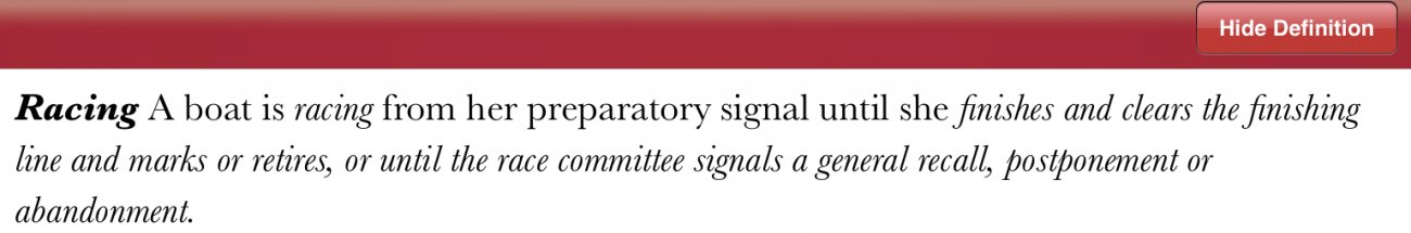

Look up definition of Racing in RRS
So close. Exactly right that you can't use propulsion while you're racing, so that's the key definition. The only thing is that racing is defined as starting at the preparatory signal (generally 4 minutes), not the Warning signal (generally 5 minutes).
