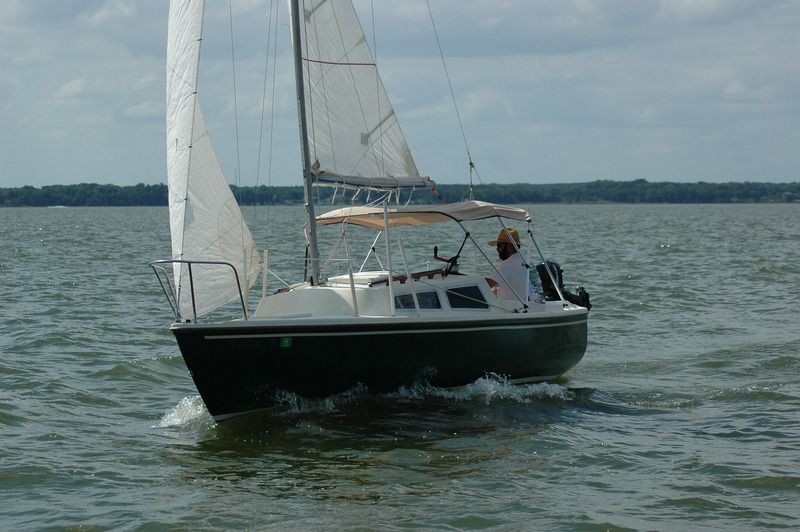

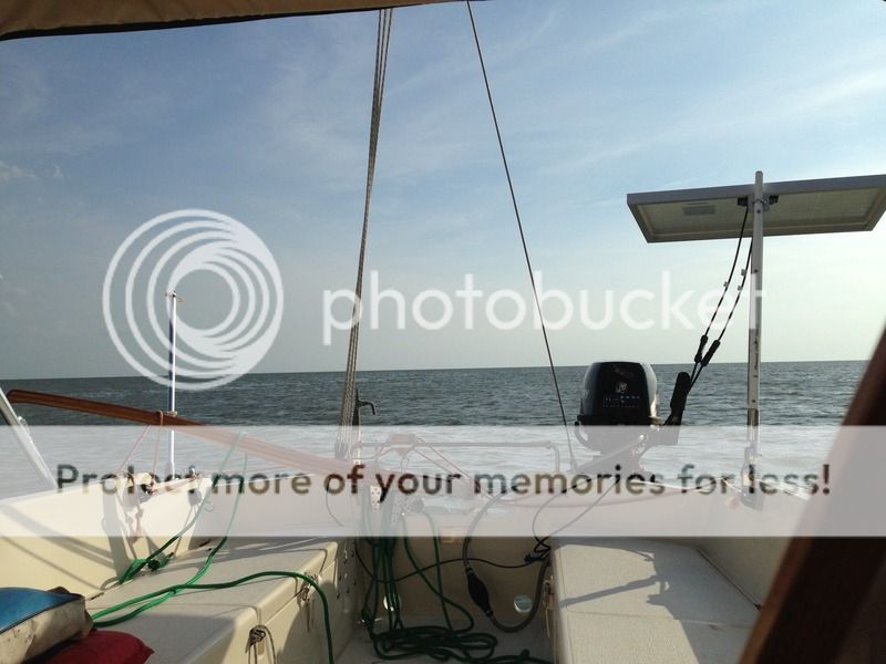

WELL... after the weather man went back and forth several times, I woke up around 4am and checked the weather (I wake up intermittently and feel compelled to check the weather when im going sailing) to see that today was now the favored day. the boat was a MESS and the mast was still up since I was planning to go tomorrow. the motor needed to be cranked since it hasn't ran since January and it needed to be put back on the boat. well, those details weren't going to keep me from going!!!!
thanks to Gene for the pics

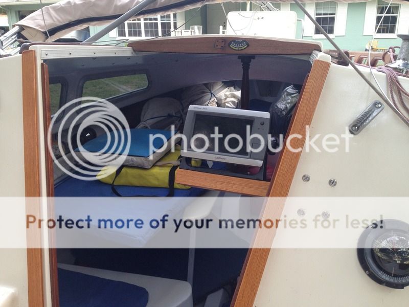

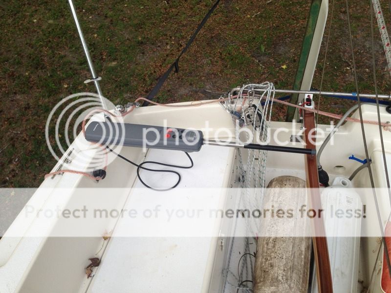

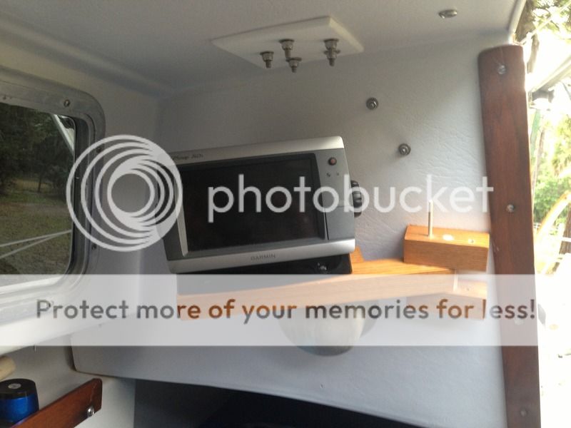

well since the last post I have finished a few things. I made a mount for the gps out of red oak:
I made a berth for my new best friend Ray:

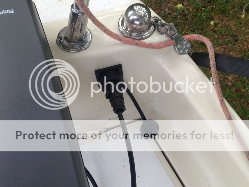

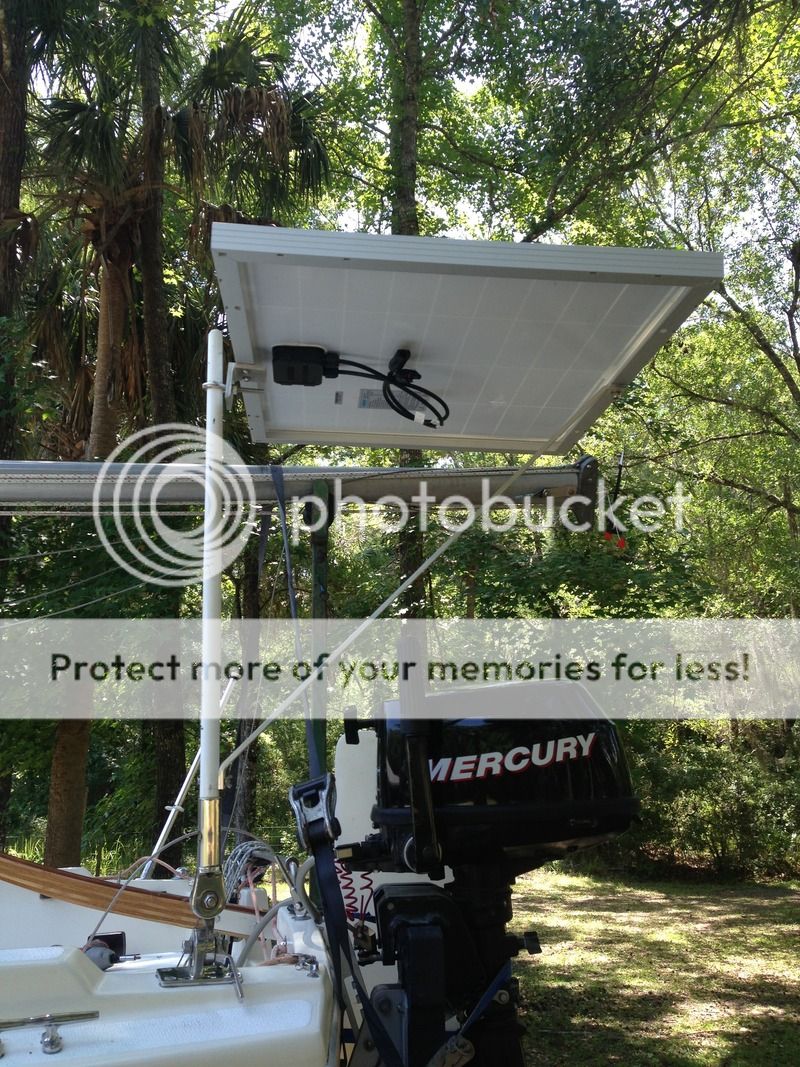

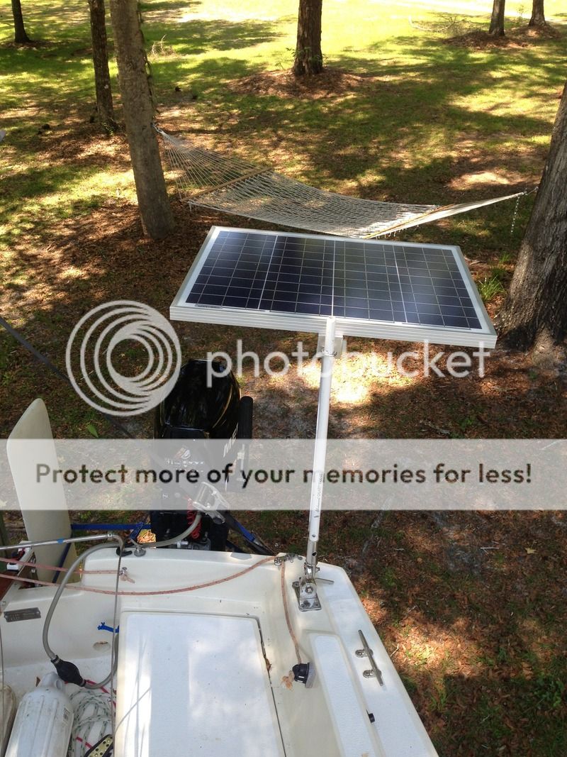

and I installed the 50w renogy solar panel. for this I had a old fiberglass vhf antenna, rendered useless by a PO who cut the coaxial up against the antenna. I cut it down to size then filled it with epoxy resin to make a solid fiberglass rod. works out real nice as the easily adjustable base allows me to angle it to compensate for heeling
I spent the past two weekends on the boat testing everything out. the first trip didn't work out so well (good thing it was a test trip right?). the gps wouldn't read depth. for some reason, the spot where it was mounted in the boat was causing issues. I had it next to the thru hull for the cockpit drains. after some playing around at the ramp I found that it would work well on the opposite side of the thru hull. not sure why it didn't work in the first location. Once out, my wife was feeling nauseous so I only got to use the tiller pilot for about 30 min. that was her first night on the boat and a success in the sense that I worked out some kinks and thoughts of some things we need to make sure to bring on the upcoming BEER cruise.

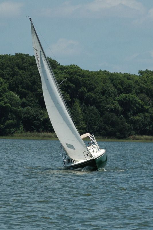

last weekend I went by myself to a lake near here. everything functioned as it should and I had a great time. total distance traveled was 33 miles and only about 4 of that was motoring. even had a good night sail! click to see the video
the next morning I did a "fly by" on Gene Neill. luckily he caught it on tape so a huge thanks to him!! click to see the video

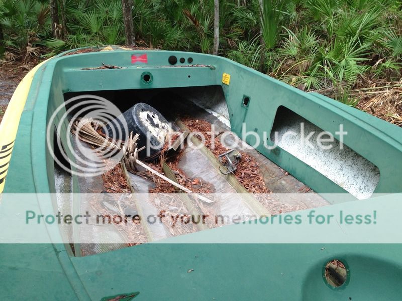

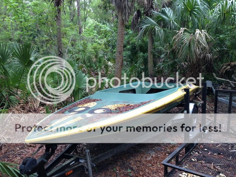

Whats next? well... back to what I was SUPPOSED to be doing this past spring before I broke the keel hanger bolt... this poor gal had already had the cap removed and I was in the process of removing the splashwell when peewee stole my attention. I put the cap back on and she got stuck in the woods. I guess its time to pull her back out and get going again. She is a Kevlar ex-marathon race boat. I am (obviously) doing a FULL rebuild on this, with all coosa (for weight savings and never having to worry about rot again).

I'm liking the GPS mount.
That solar panel is smaller that I would expect for a 50w unit.
Didn't that race boat get used in the James bond movie Live and Let die :D ? ?
