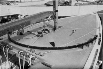

I'm with you on the efficiency of a vang. You could install a curved track on the cabin and pull straight down.
Interesting you should say that... one of the very first boats with a 'vang' (the Olympic-class STAR) uses a curved track for the vang.
