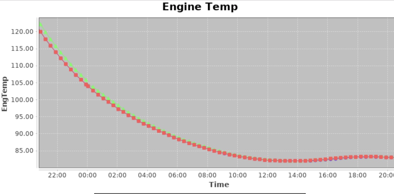

It would be interesting if someone with a gauge to read degrees would see how long it take the engine to cool down to "acceptable" (read tolerable) level. Anyone?
Probably depends on what you mean by “acceptable”. A warm engine in April is a lot more tolerable than August. But as an example, here’s my engine temperature for several hours after a long run yesterday. We shut down at about 4PM around 165 degrees. My chart only shows the last 24 hours, so the first few hours of decline aren’t visible, but this gives some idea as to how long it takes for the block to cool. 5 hours after shutdown the block was still around 120. Temperature sensor is mounted on the outside of the closed loop water pump. We have a blower tied to the ignition. The cabin was in the high 70s most of the time.
