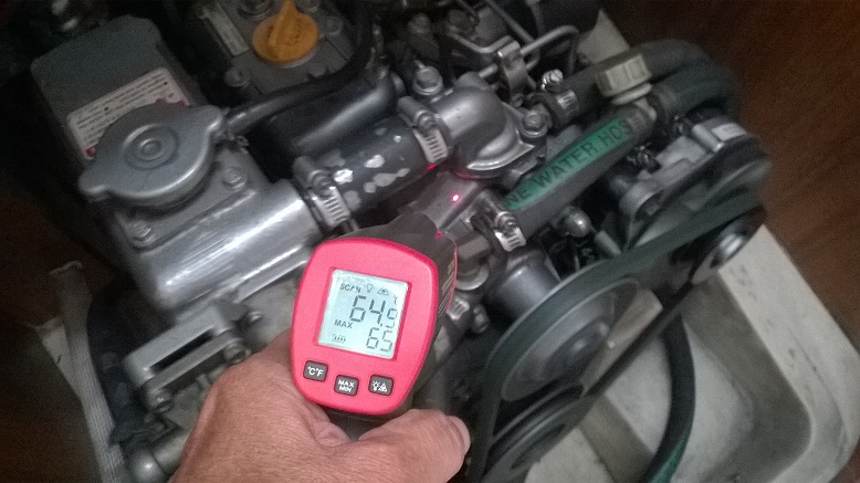

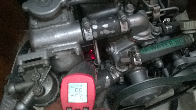

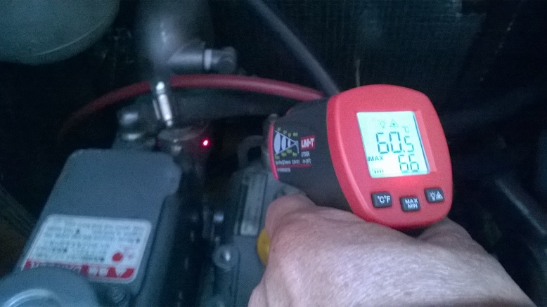

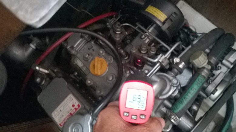

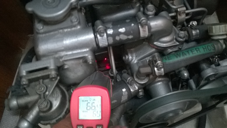

I ran the engine at dock in gear for like 20-30 mins and measures the temperature at Tstat ~68degC, lower engine body ~65C, exhaust elbow ~60C. Temperature seems kind of low. I'll send pictures of measurements when I get to a proper computer.
24,797
On my Perkins those would be normal temps. I usually shoot the Injector as well I get temps in the range of 80-86 C . Not all cylinders are the same temp.
10,248
Ken, attached is the cooling water flow schematic for the GMF.. Your temperatures look OK; Note that the coolest water in the fresh circuit (from the heatex) goes through the FW pump then into the lower block. It goes up where it picks up heat and exits the cylinder head at its highest temperature. The thermostat controls that water temp by either recirculating some back through the pump/block or shunting it into the heatex. Your thermostat should start opening at 71C; that is the water temperature inside the housing, as it is leaving to go to the heatex.. I think you are measuring spots of lowest temp on the engine.. "engine body" is where the "cool" water from heatex enters block.. "pump" is cool water entering the pump from the heatex... Exhaust elbow is cooled by cold sea water exiting heatex and "cool" fresh water in heatex reservoir... "injector" is cooled by diesel and it is insulated from the cylinder head by an internal washer; it would never get to cylinder head temperature, which should be around 75C internally.. Couple that with the inaccuracy of the IR gun, and I think your temps are OK..
