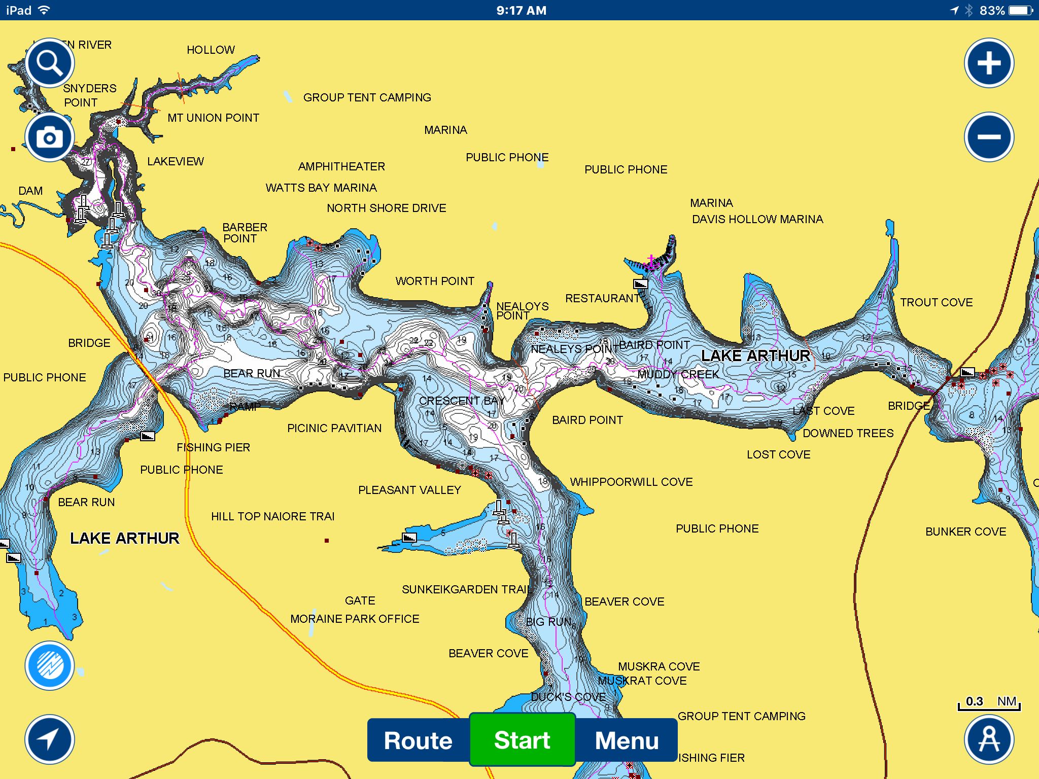

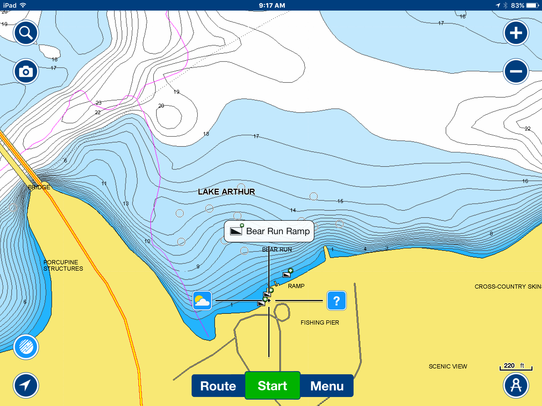

LNL, I apologize if you thought my suggestion to launch from Bear Run was silly. I am not familiar with Lake Arthur, therefore simply suggesting another launch point, perhaps on the south side of the lake where wind would be favorable to push away from shore, and offer a lot more control coming back. I guess I also believed with the C22 that you trailer it.
Looking at Navionics, Lake Arthur has several boat ramps which appear to have significant depth gradient for your ship. I'm assuming also that some of these ramps may have obstruction or other objects which limit keel boat passage into the deeper channels.
I've attached a couple images which show Lake Arthur to be a very truncated water feature. In my mind there is a lot of potential areas where you might find yourself in a world of hurt if the wind decides to become confused. That is the only reason I suggested a motor.
Truth is...we are attempting to help you become a better sailor!
