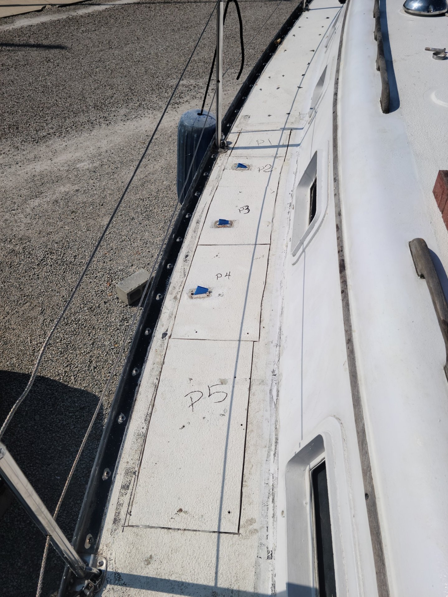

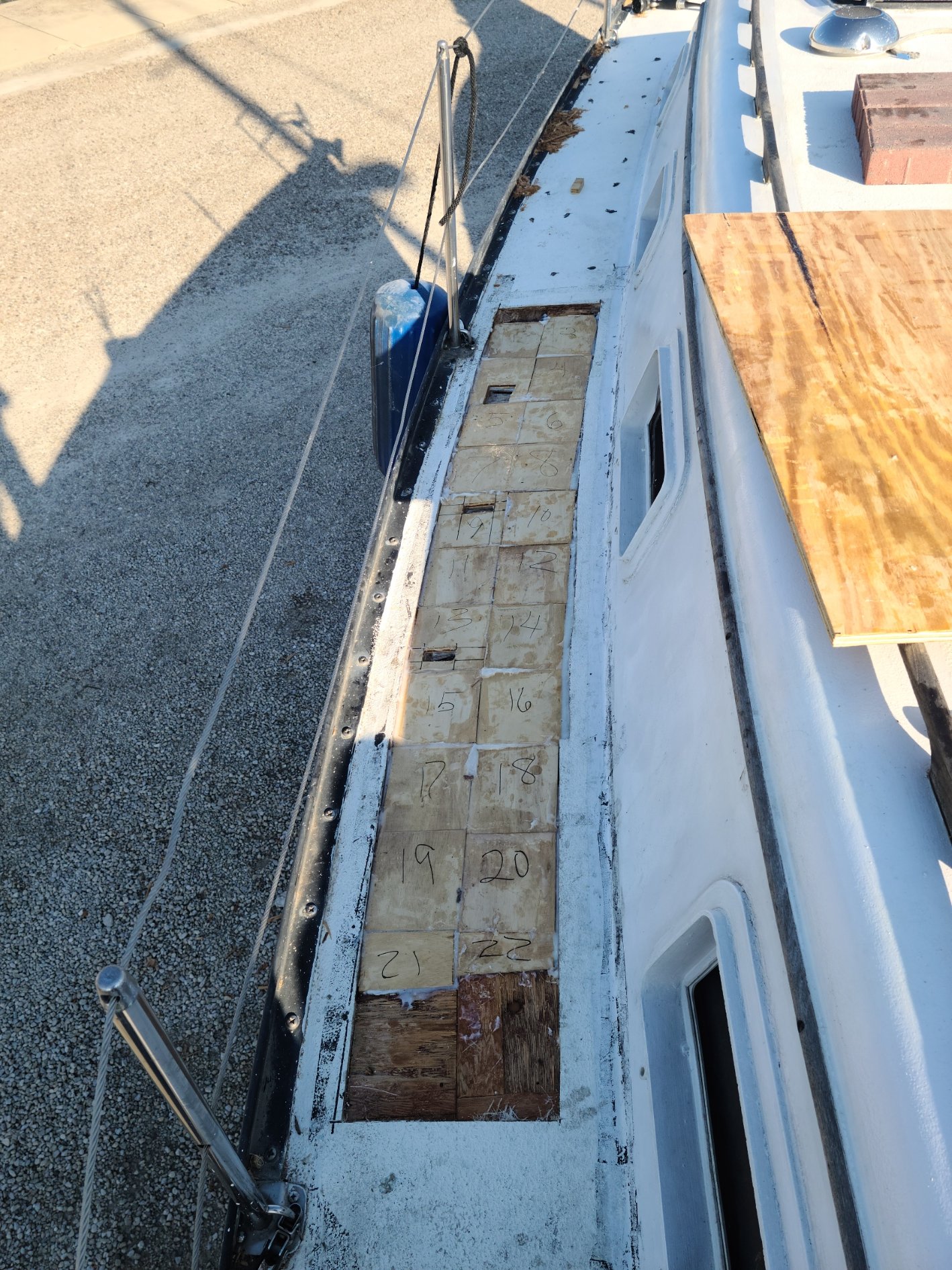

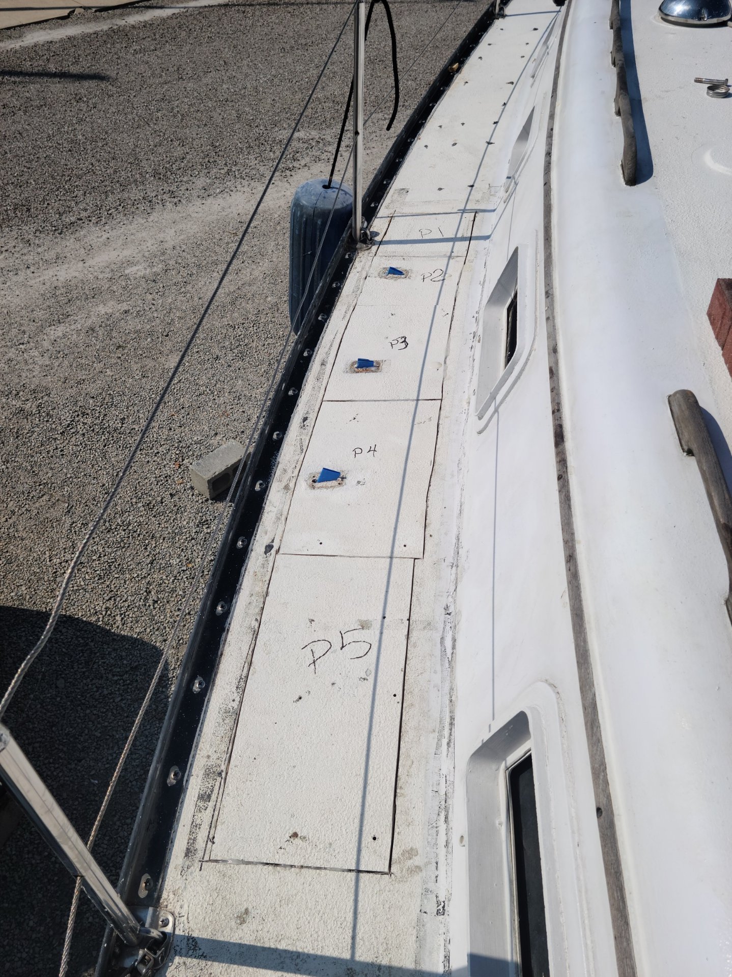

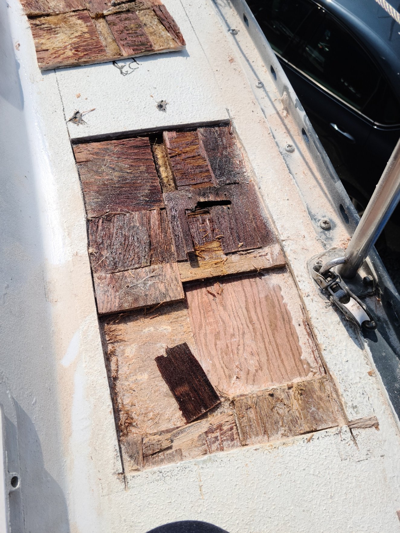

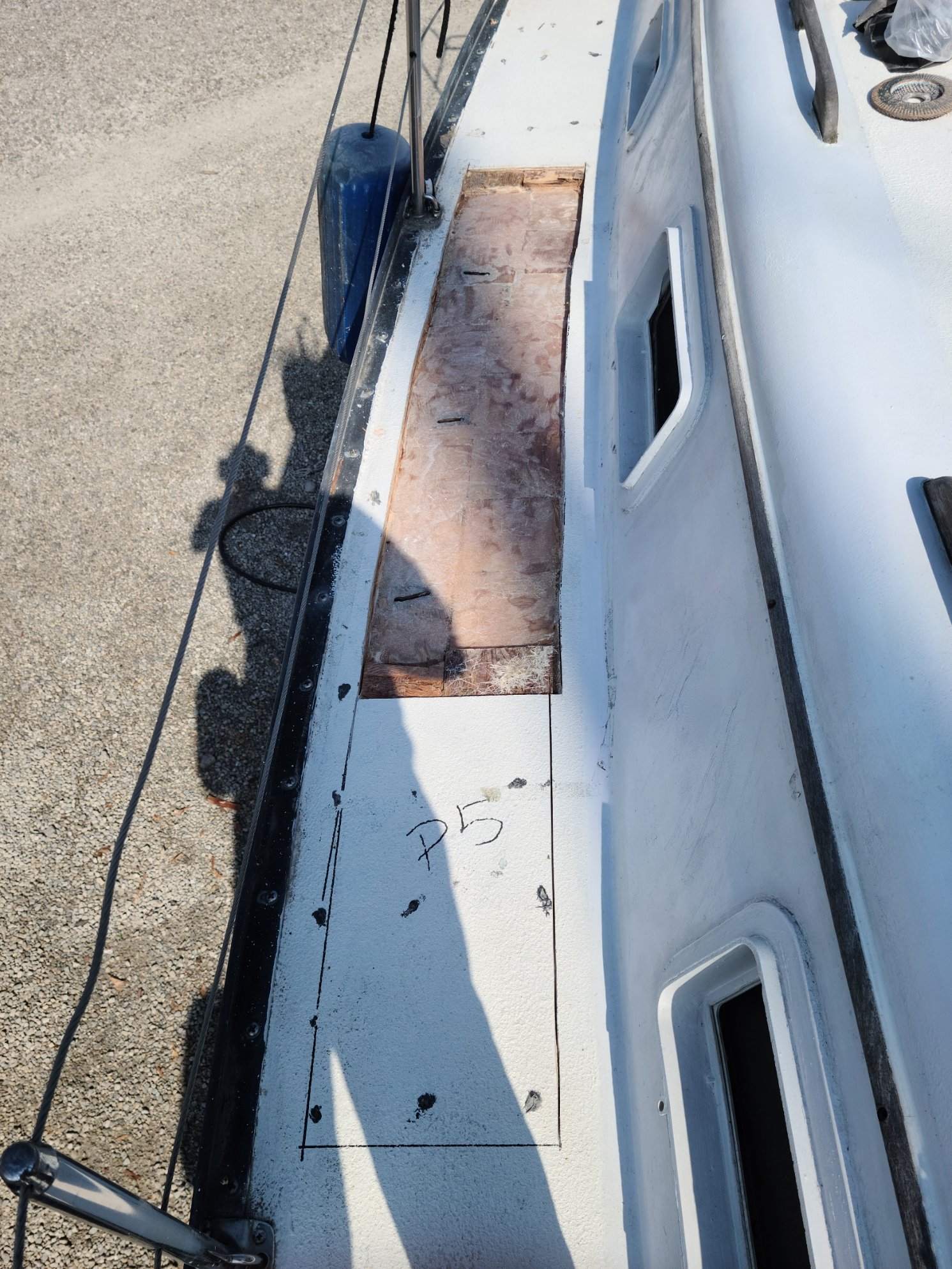

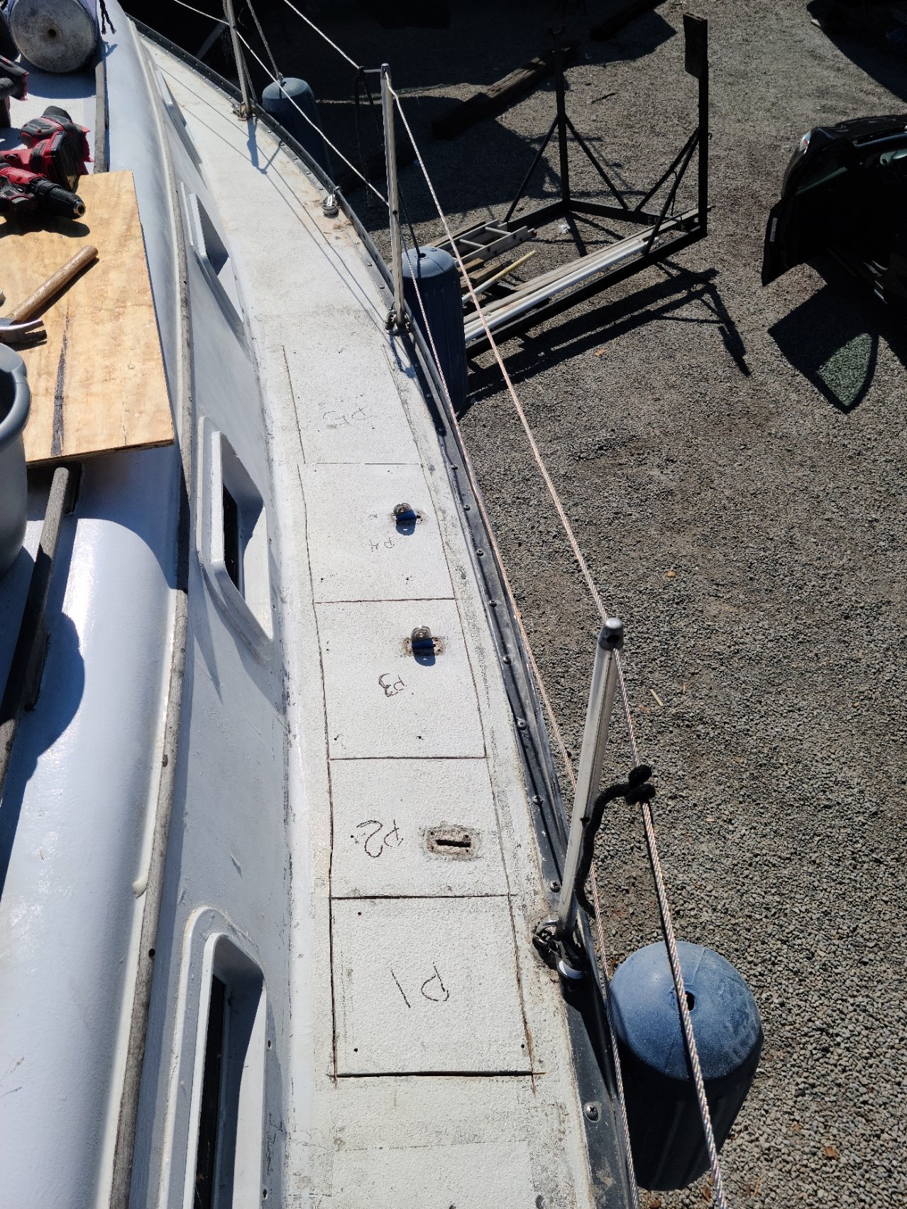

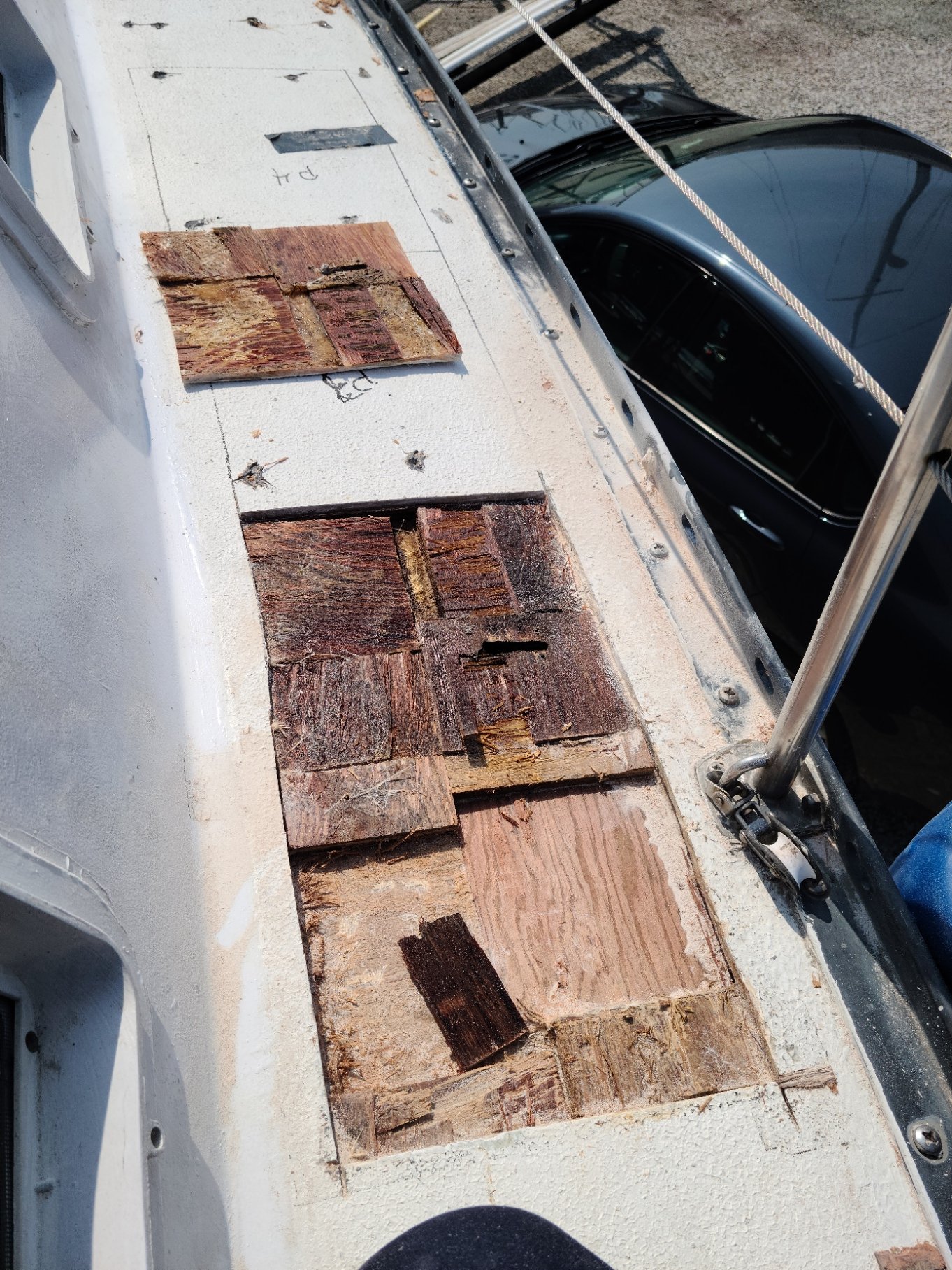

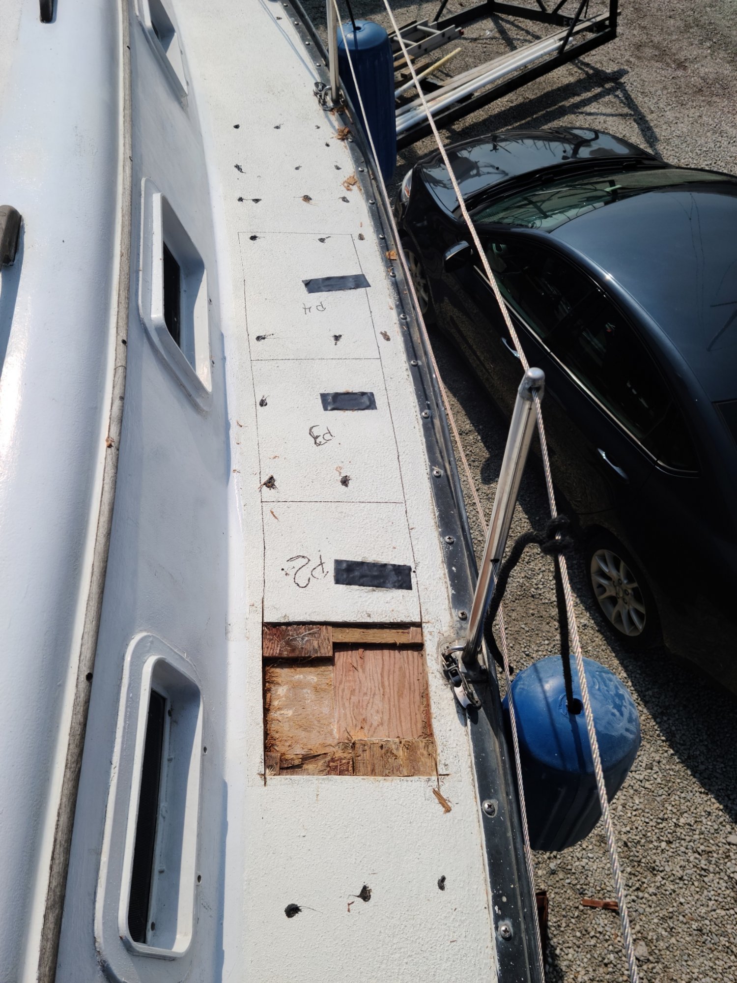

Last weekend I finished getting the rotten plywood core out of the section I am working on. While there is more to remove forward of this work area, I am limiting this job to just the area 2 foot forward and 2 foot aft of the port chain plates. This area is an "A" issue on my survey.
The existing fiberglass top and bottom will be used again in this project, while the water rotten plywood core with be replaced with small (5" x 5" max) pieces of plywood. The area is about 5 feet long by about 8-10 inches wide.

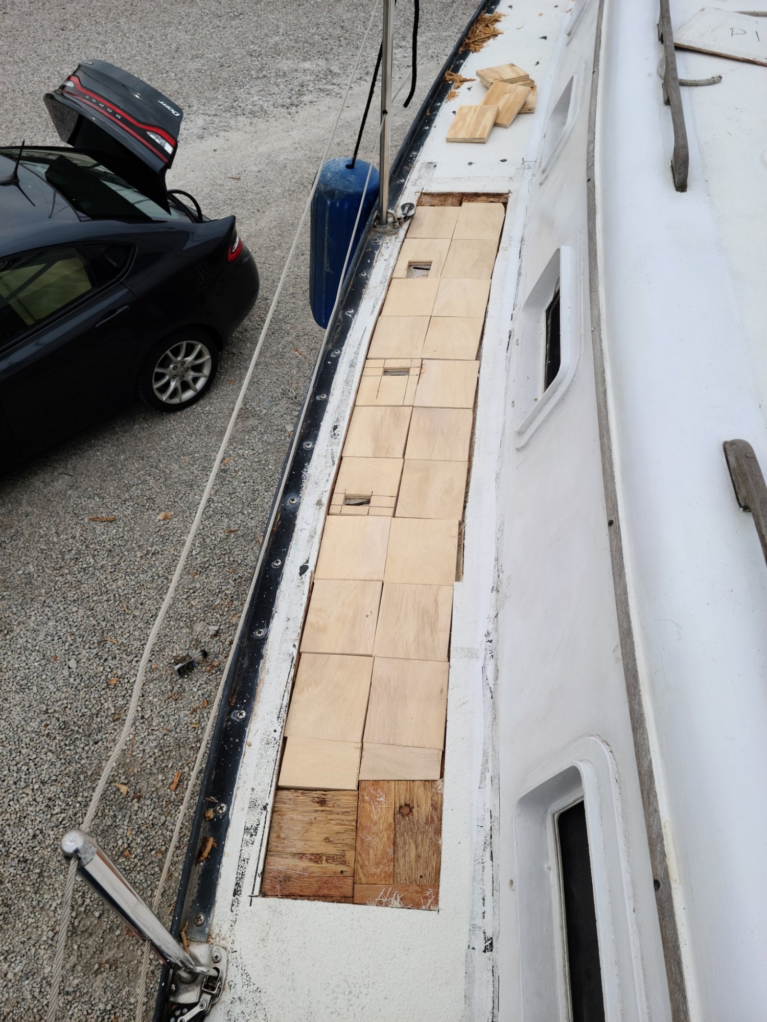

Cut and dry fit every piece and making sure that chain plate holes line up correctly. (Chain plate holes should be a bit oversized so that I can epoxy fill the gap. Mark the pieces so I know where each goes.
4-6 Piece Batch
Repeat the 4-6 batch process until I get the entire 5 foot section done this far. This will leave the entire top area of plywood pieces without any epoxy on them.
Cover the area one cut out piece at a time
The deck sandwich top was taken off in 5 pieces, ranging from about 8 inches to a foot in length. Working with a single piece
Join the edges

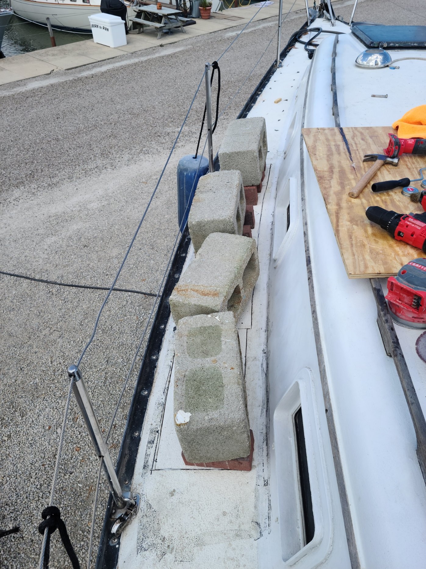

- Position the pieces in their appropriate spot and weight them down with say bricks
