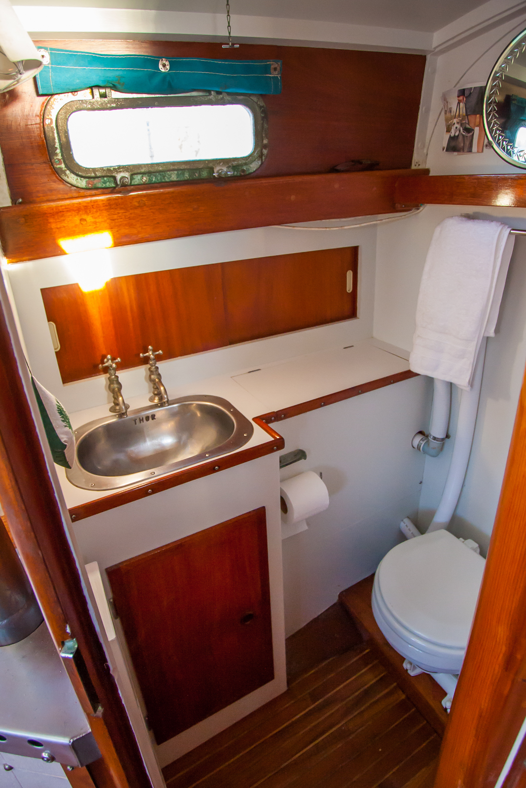

Good summary. And don't forget MDO. If it's going to be painted, I use that. They make highway signs out of it and don't epoxy. I used that for the removable panel to the right that the TP holder is mounted to. Paints beautifully. I didn't epoxy (I don't epoxy anything to seal it but that's just me).
