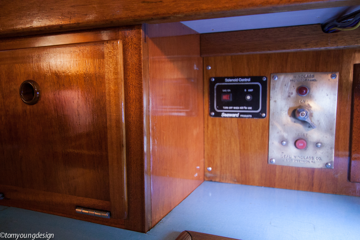

You ask for wood so I'm assuming you're making some cabinets out of lumber. I like Sipo because I can get it a mile down the road at my local lumber supply, and the price is pretty good. About 8-9 per board foot.
Sipo is a tropical hardwood that resembles mahogany. I use it on my boat in place of real mahogany as after I varnish it, it looks just like the 60 year old African mahogany much of my boat was built of.
Here's a comparison of Sipo against a piece of that 60 year old mahogany and a piece of cheap Luan plywood (I used filler stain on that to match the hardwoods).
Here's the finish cabinet I used the above pieces for.

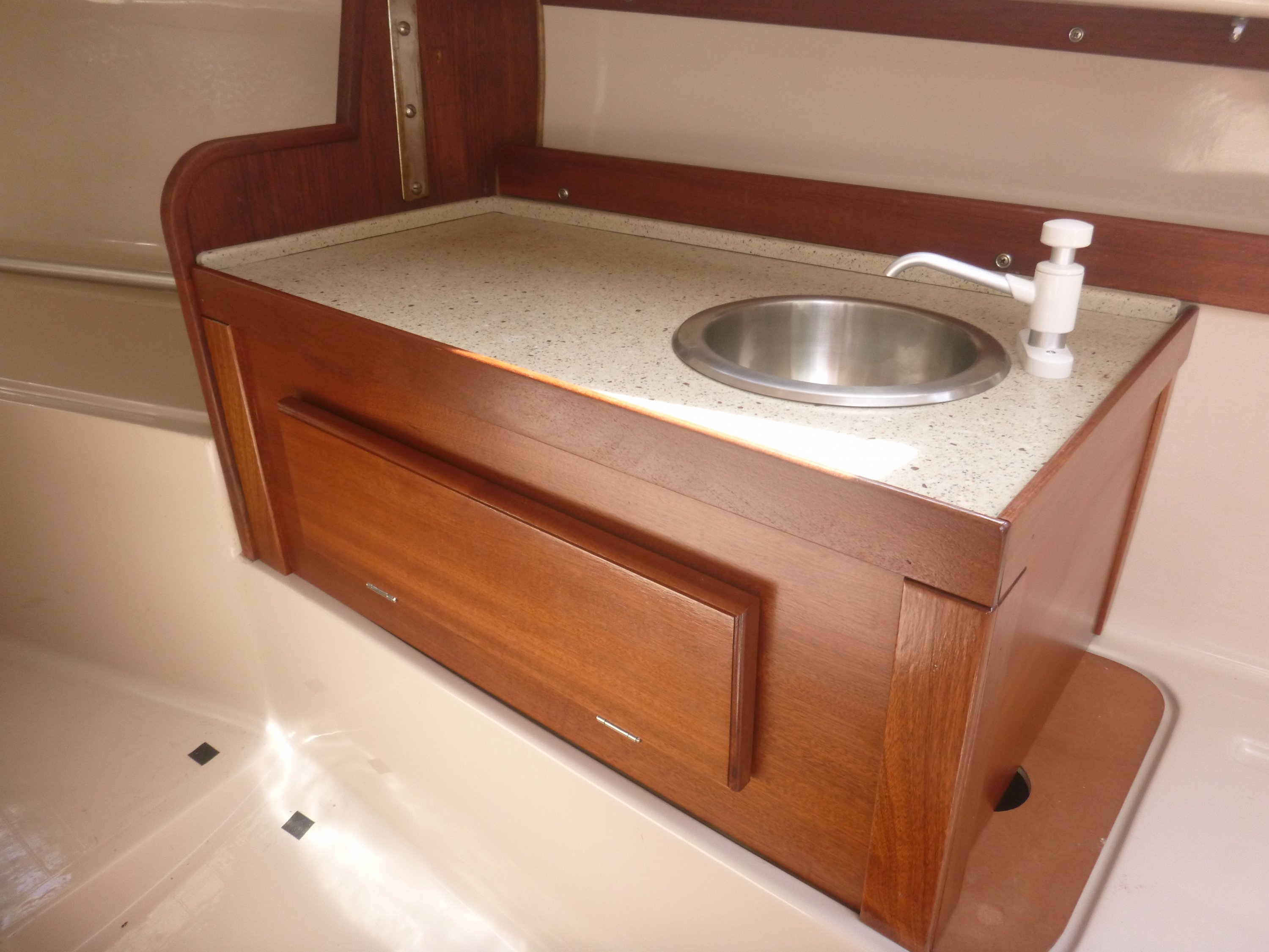

Sapele, an inexpensive mahogany sub-specie, best choice hands down. Eze to work with, great grain which POPS when varnished....wouldn't use anything else....and NO to plywood (other than veneered plywood for bulkheads and such)...Sapele example below - DIY galley on our C22...
