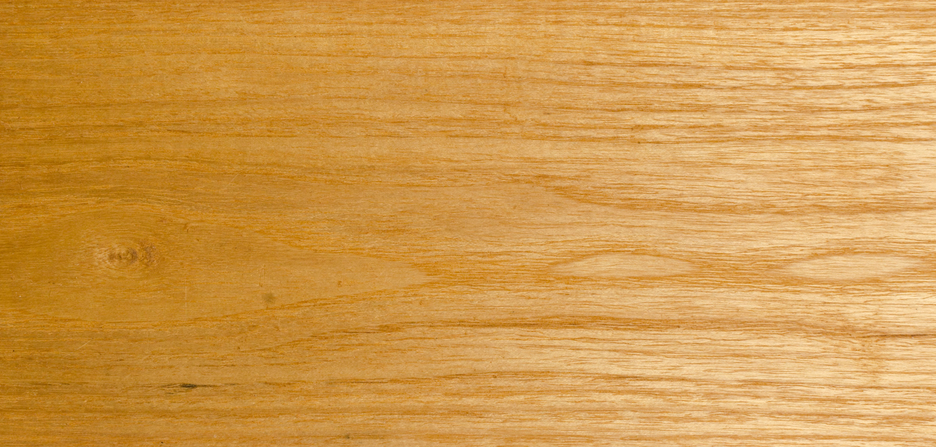

Here''s a data table of woods including black locust.
I've sourced black locust in Erie in the past. You should be able to find it in a lumber yard. It's an excellent wood for what you are doing.

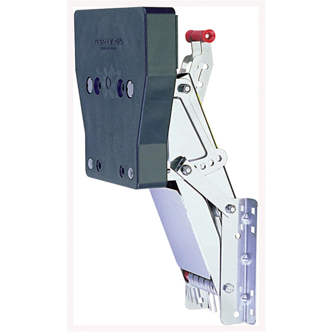

Garelick Stainless EEz-In Auxiliary Outboard Motor Brackets
1721419149977.png Builds and sells a plastic adjustable motor mount. This one is in black. It also comes in white. HDPE
I had one of their mounts on my 15ft sailboat for 18 years.

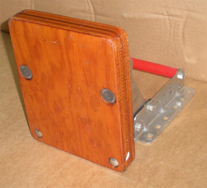

Garelick 71058 Stainless Steel Outboard Motor Bracket
1721419363638.jpeg Here is one in plywood.

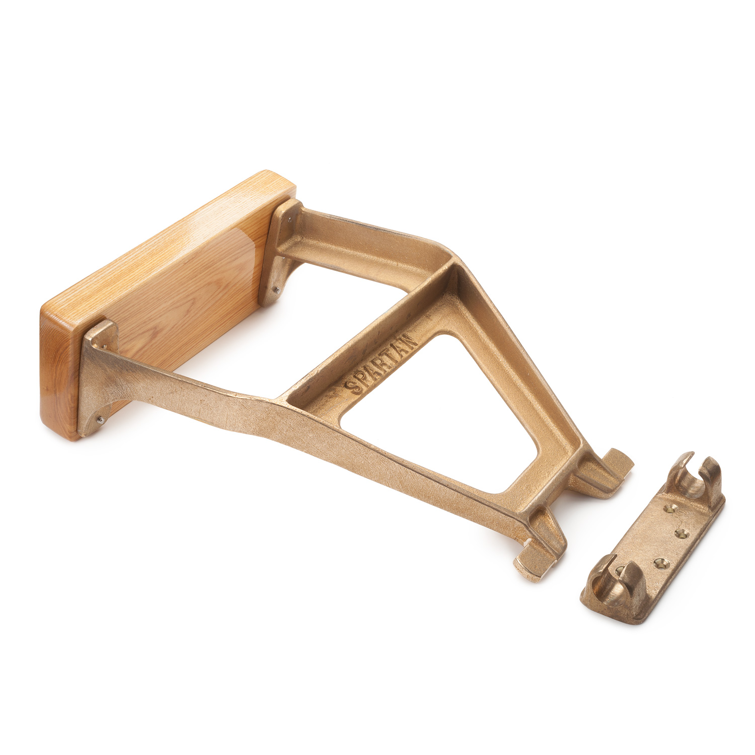

Here is a motor mount in pine. I note it has been varnished. Looks beautiful.
You can make it out of what ever you choose. It will likely last beyond the period you own the boat.

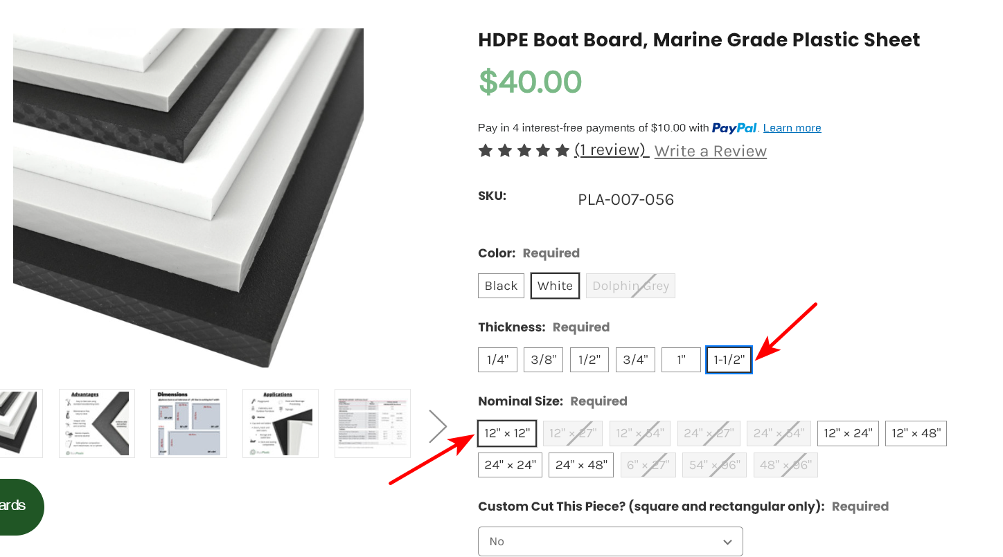

Time to get practical.
For a lousy $40.00 and no surface treatment ?
How can you go wrong ? It's permanent.
As long as the 12" X 12" piece is big enough and you've got the woodworking tools for the job. Recess the the holes for the clams pads by about 1/8" to 1/4".
One thing I've learned about using screws for structural purposes in HDPE, use long screws (2-1/2" SS or more in this case) and drill the pilot holes so the screws goes in without too much resistance. Make the pilot holes too small and the board will split after a few years.
Be sure you have all the POWER tools required to do this. This stuff is beautiful to work with power tools but cannot be worked with hand tools.
