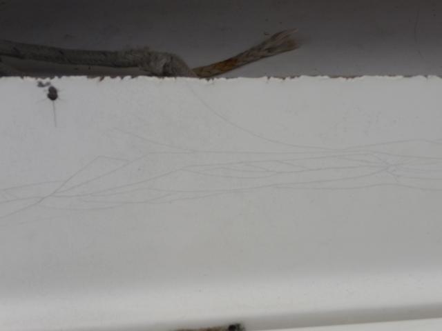

What to do with these spider cracks?
Dec 1, 2010
69
Catalina 1978 C-27 Nortons Marina
What should be done to bring back the finish? These cracks seem to be on the surface. I was just thinking of putting a new Gel coat finish on it. What kind of coating would you use?
Apr 18, 2009
115
Newport MKIi 30' Channel Is. CA
I cleaned the cracks out with a can opener then skimed w/ marinetech then Gelcoat, All gone
