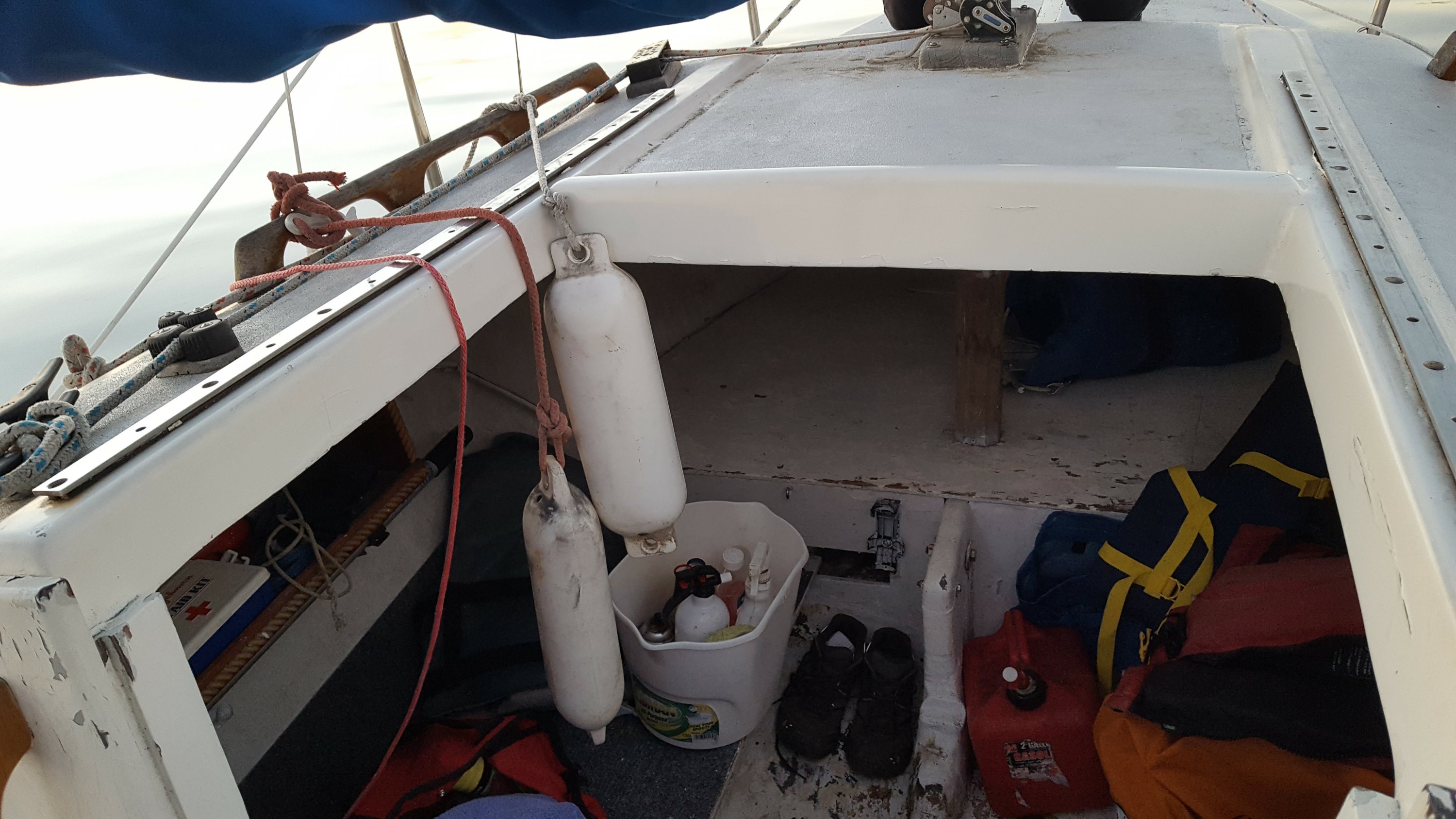

Hi,
A friend and I are fixing up a MacGregor Venture 21 built around 1975 and our main challenge is that it is missing its horizontal and vertical cabin doors. I found a website or two that sells MacGregor parts but they don't seem to have cabin doors.
Should we get something custom made? Is there such a thing as a junk yard for sailboats where we might find the parts?
There are two rails that the top part of the door slid on but they are not completely parallel. The distance between them is slightly less at the end near the mast. I have enclosed photos.
I am a novice sailor and I would love to hear anyone's advice about the easiest way to get this sorted out.

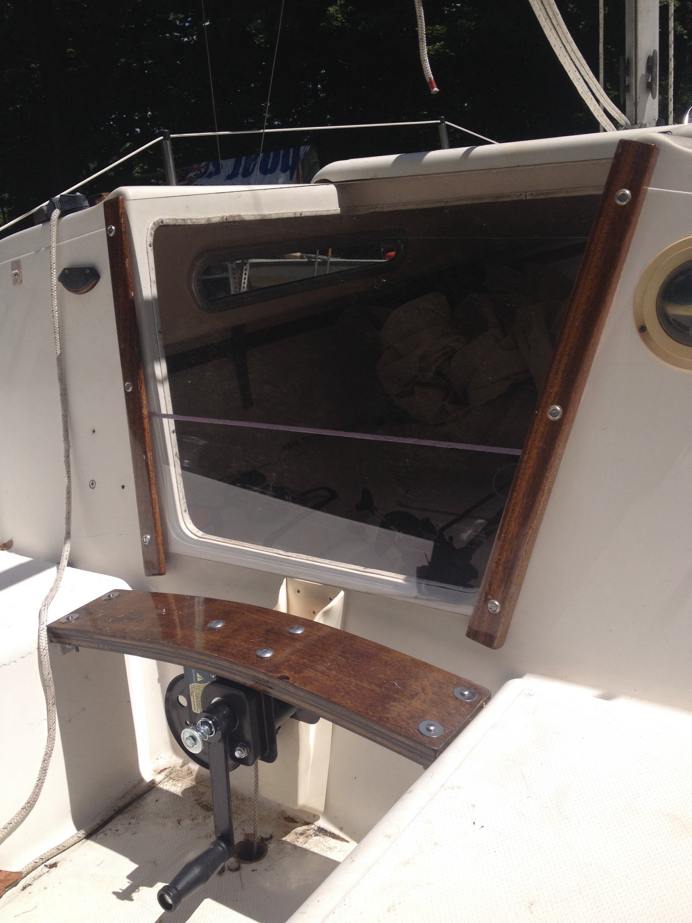

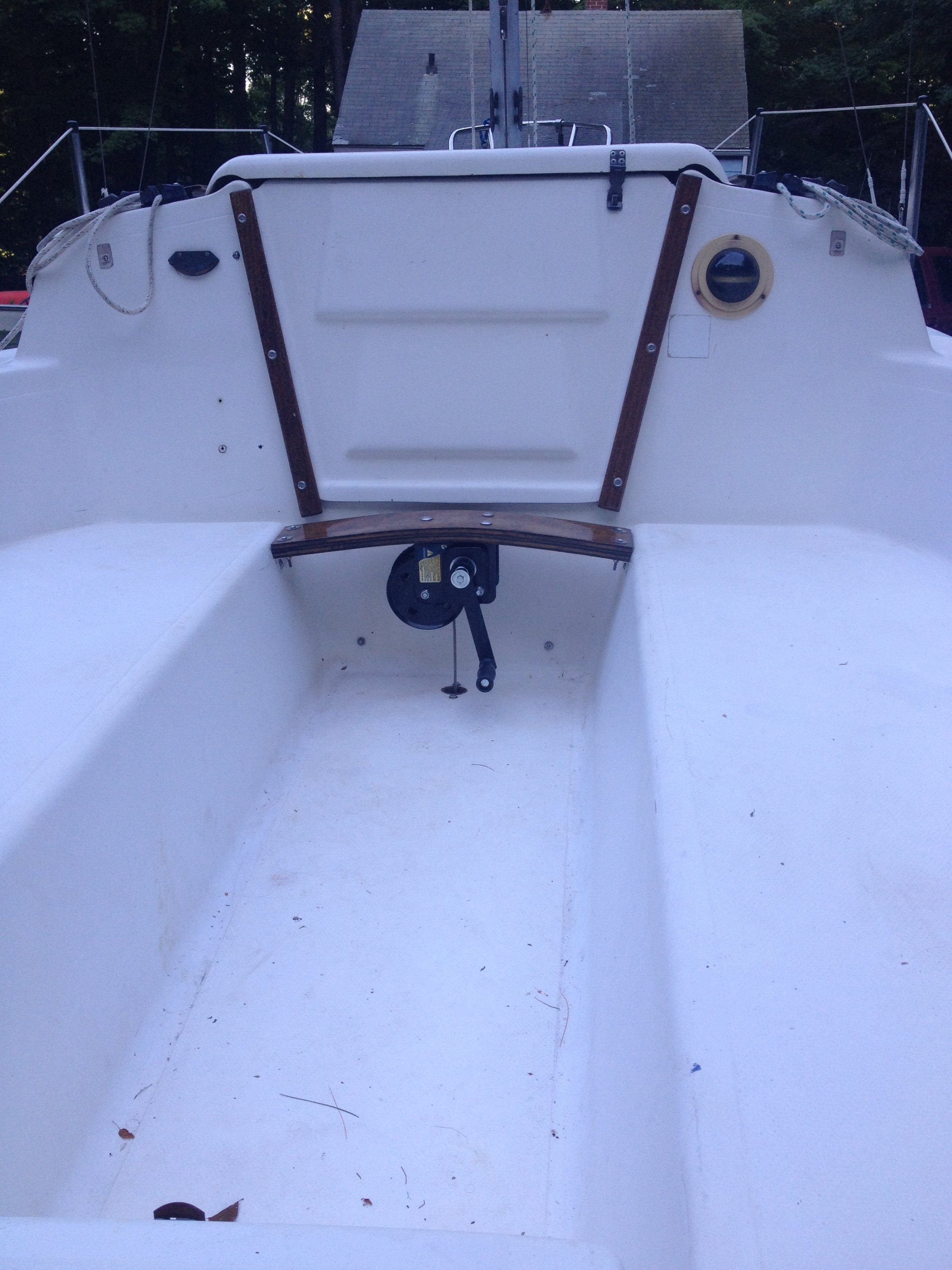

This is all excellent advice, and JohnCTV21's photos are also really helpful. It looks like on our boat there are already grooves that we could use to slide the vertical drop boards into (The boat is still pretty new to me so I'm unfamiliar with many of its details).

It looks like "T" track on the cabin roof, of you could find something to fit it, you could make a sliding hatch. I suspect that is why they are there. Then you have nothing to lift or get blown over.
To make companion way boards, get some cardboard, make a pattern and your good to go, just make sure the material fits the slot.

Those grab handles on each side of the companionway (vertical) appear to be part of customized drop board arrangement, likely bolted in place where the stock ones were. They appear to wrap into the companionway and make it slightly more narrow. You'd also want to be sure the slots they provide effectively drain outside the cabin. How do you like the handles? You may want to revert to the original style shown in JohnCTV21's photos.
Also not real apparent in JohnCTV21's images are the boards matching those for the drop board that sit on the cabin top to retain the port & starboard edges of the sliding hatch cover (outside the lip where you currently have sail track mounted). You may see the old mounting holes from inside the cabin...if were filled at all! Here is are a couple poor shots of my abused boat where one strip is seen (very weathered gray next to sliding hatch) and the dropboard tracks are visible.
