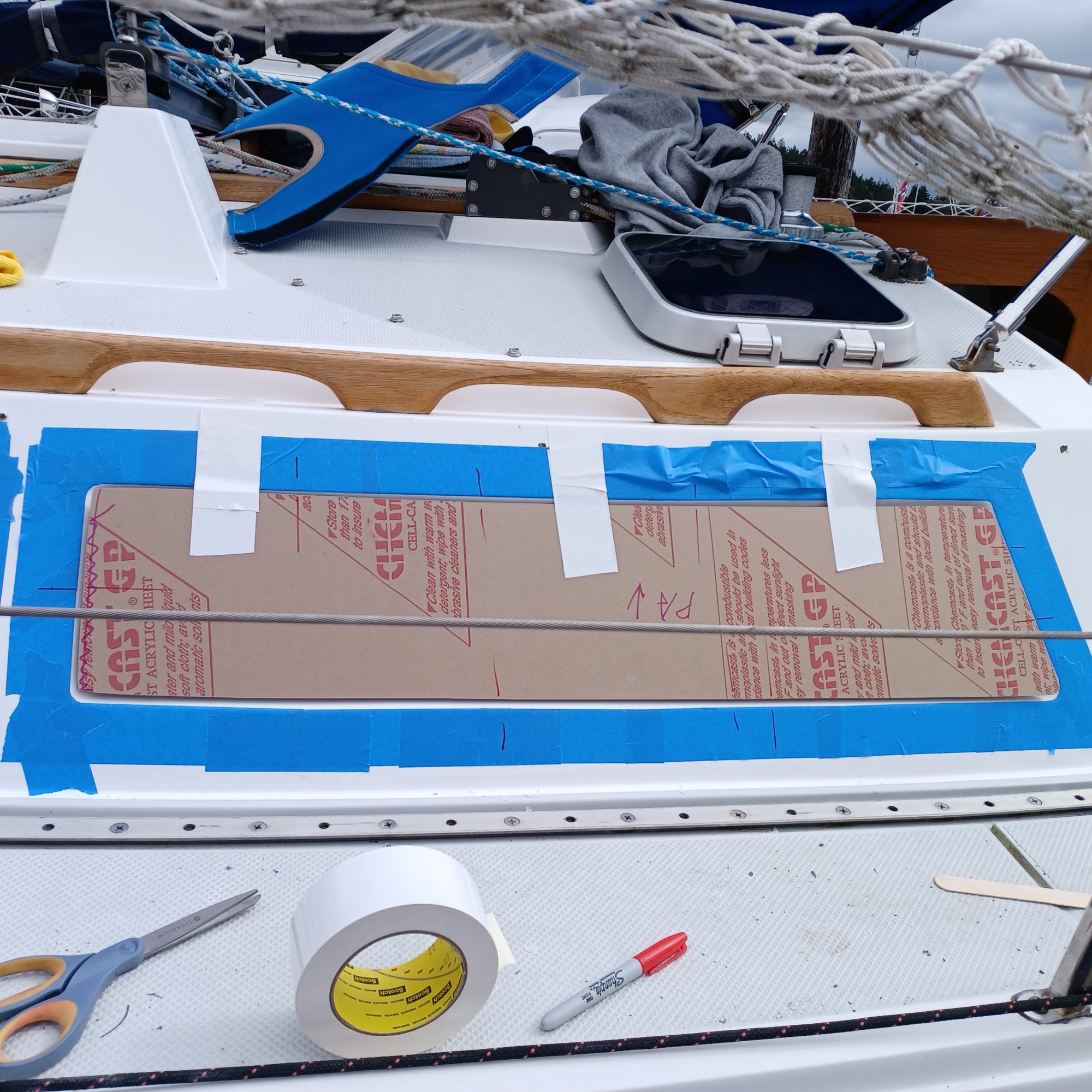

Did you read my post on making the tape hinges to help placing the lens onto the VHB tape. You only get one chance and any error is permanent. I used the white 3m preservation tape to hold the location of one edge in the correct location and then hinged it back over that side to pull the backing off the tape. then it was a simple matter to fold it back into place. Make sure that you put some tension on the tape to keep it properly aligned.

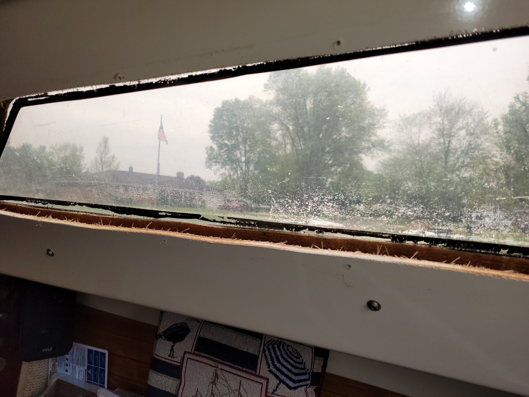

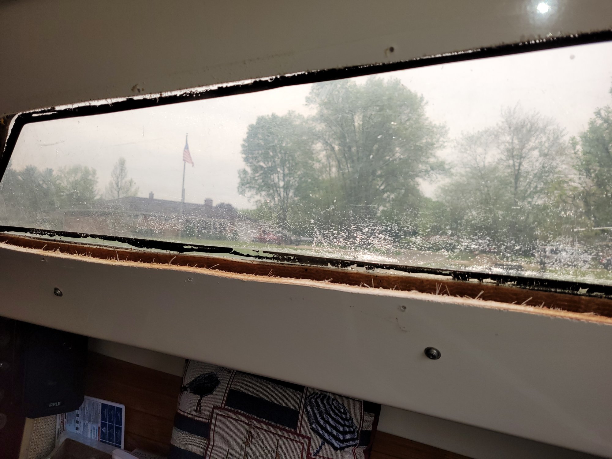

I am just putting the original trim back in. it is in good shape. this picture is what you see when the trim is removed. if my trim pieces were broken or unsightly, I would fashion some out of wood and either paint or varnish them and reinstall. - Chris Castrilper
The trim on my O'Day 25 is screwed to the window frame. How did you fasten yours without the frame?

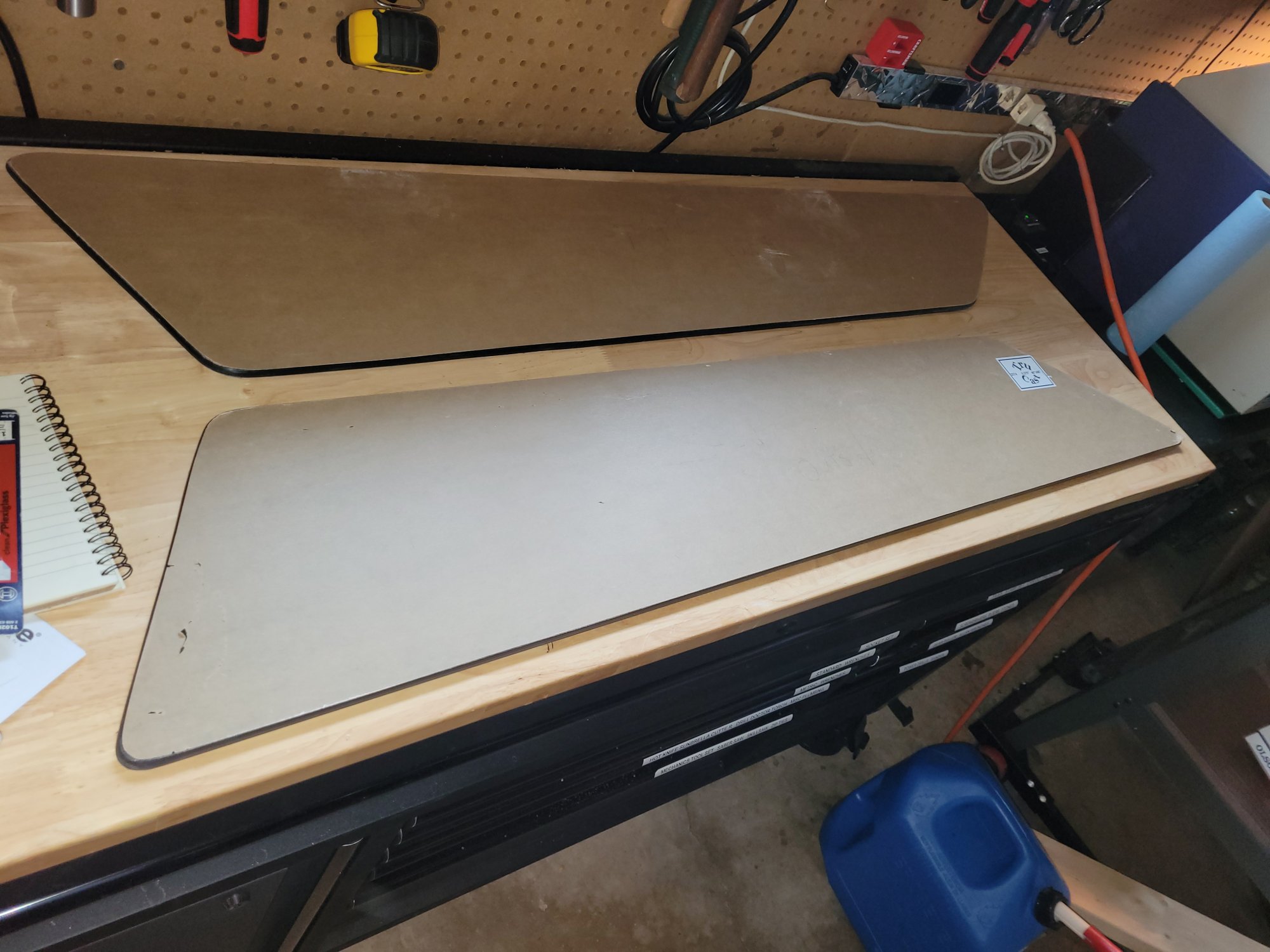

I bought the acrylic from a guy who was going to fix up his O'Day 23 but parted it out instead. The corners are sharp. I'm good with carpentry but haven't worked acrylic before so I may take this to a glazier to get the corners rounded. Husband would love teak trim on those windows. I would too, but I'd also love to spend more time sailing. :)

Fine toothed circular saw blades work well, especially if you go slow. Putting tape over the area to be cut seems to help a little bit with chipping. Routers work nicely. I've also heard of people installing a circular saw blade backwards in a table saw so it "melts" its way through. I've never tried this. You can also sand the edges smooth after cutting

If you replace the window and frame with plexi then there's nothing for the interior trim to fasten to. I don't think it'd be too hard to adhere or wedge some wood/plastic tabs in between the two layers of fiberglass but there would be a gap between the trim and new plexi.

Ahh, so it's not possible to remove and reuse that piece that is adhered to the inside of the original window? The gap changing from the top to the bottom is something to think about. I like your idea of putting the trim in first and then cutting the excess.

You would need to use adhesive or install something for the trim screws to screw into. Your best bet reuse it with externally mounted plexi is to cut up the frame. If you take a close look at the inside you can see where the frame/trim start and end. If your curious, you can remove the trim without any harm. I advise against power tools to put the screws back in. The plastic is a bit fragile
When painting the outside of the window frame, the most time consuming part is masking off the plexi. It's difficult to do a perfect job because of the rounded edge. You kind of have to cut a little bit extra to tuck under the lip of the frame
