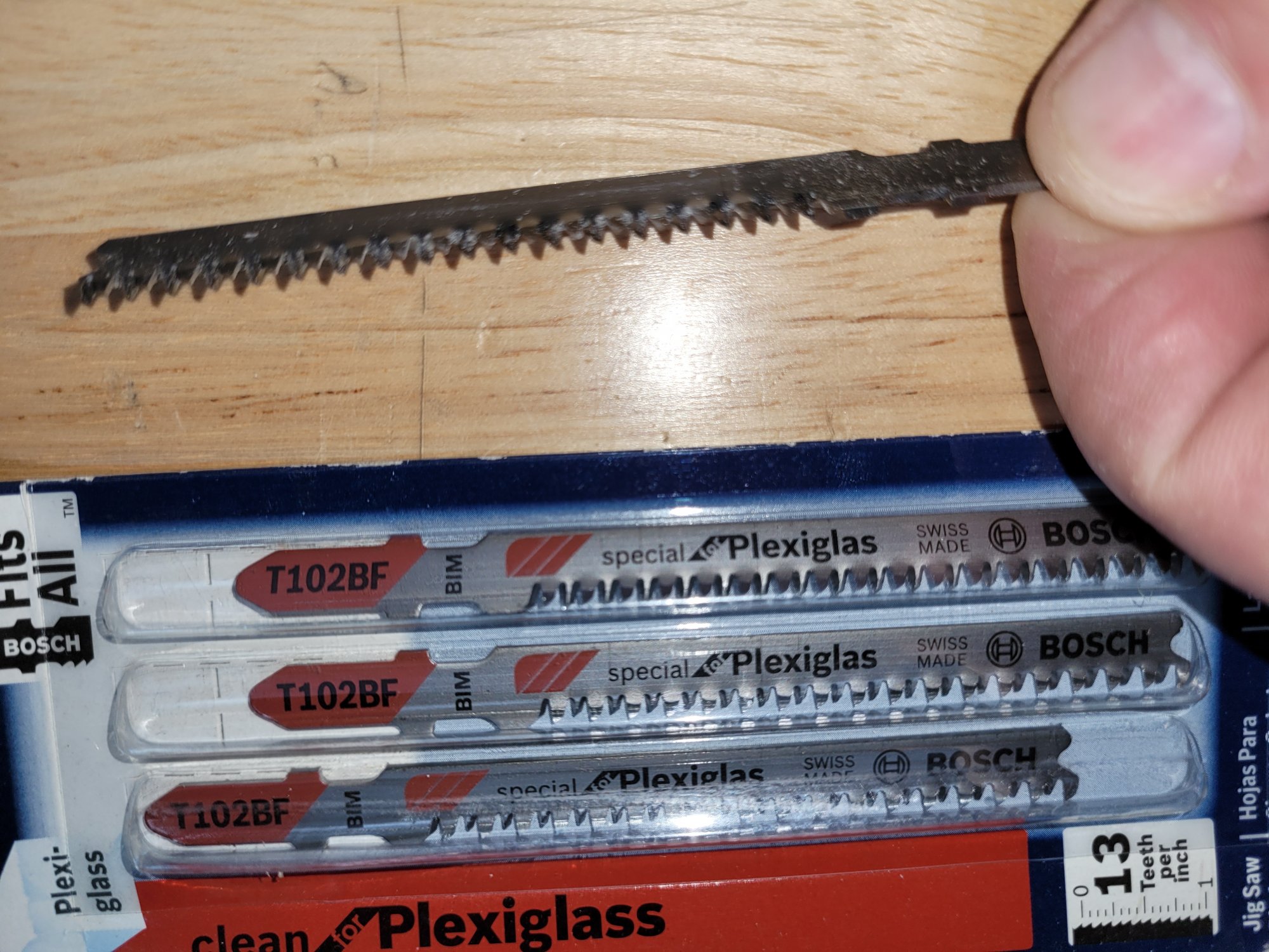

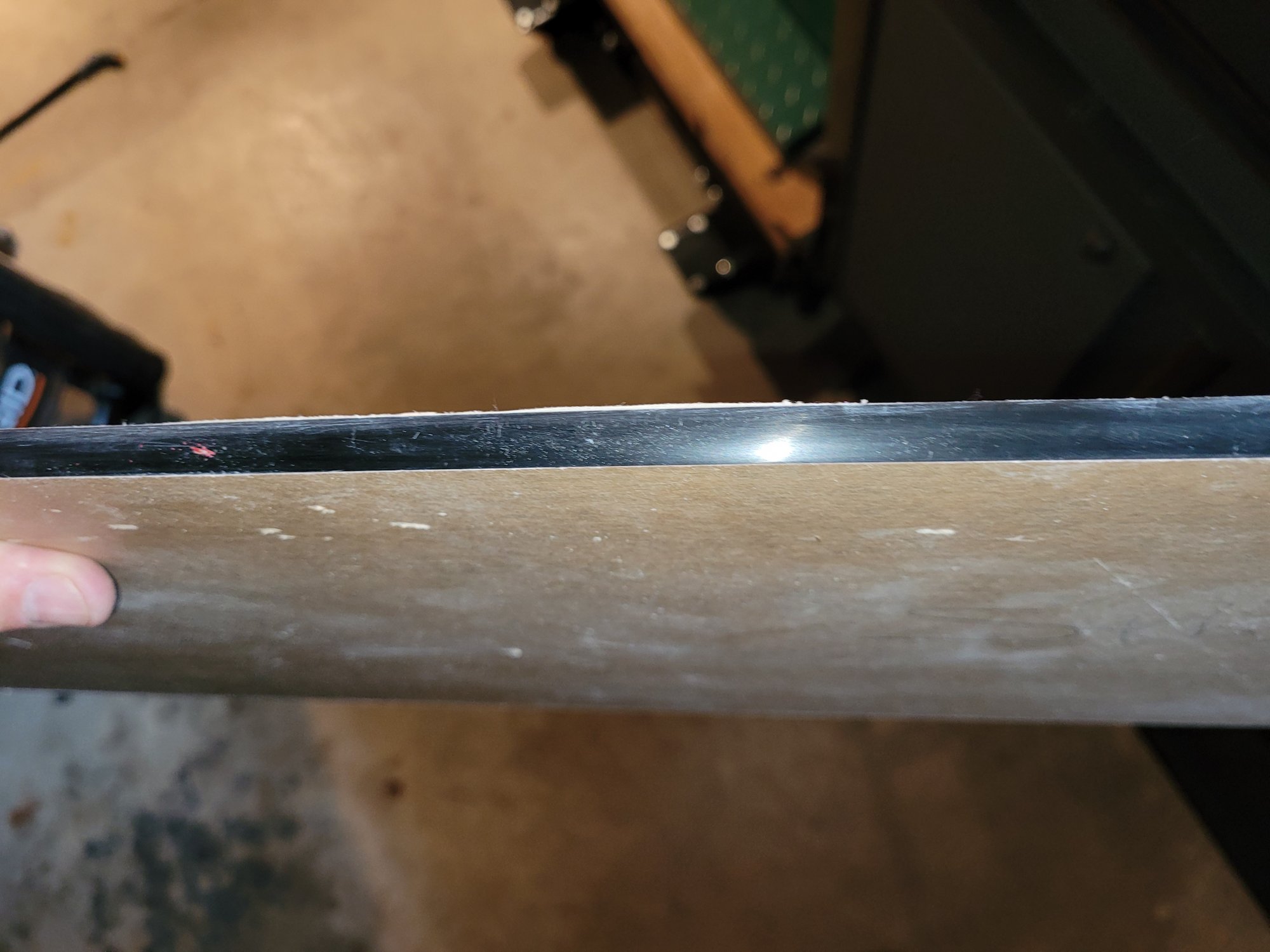

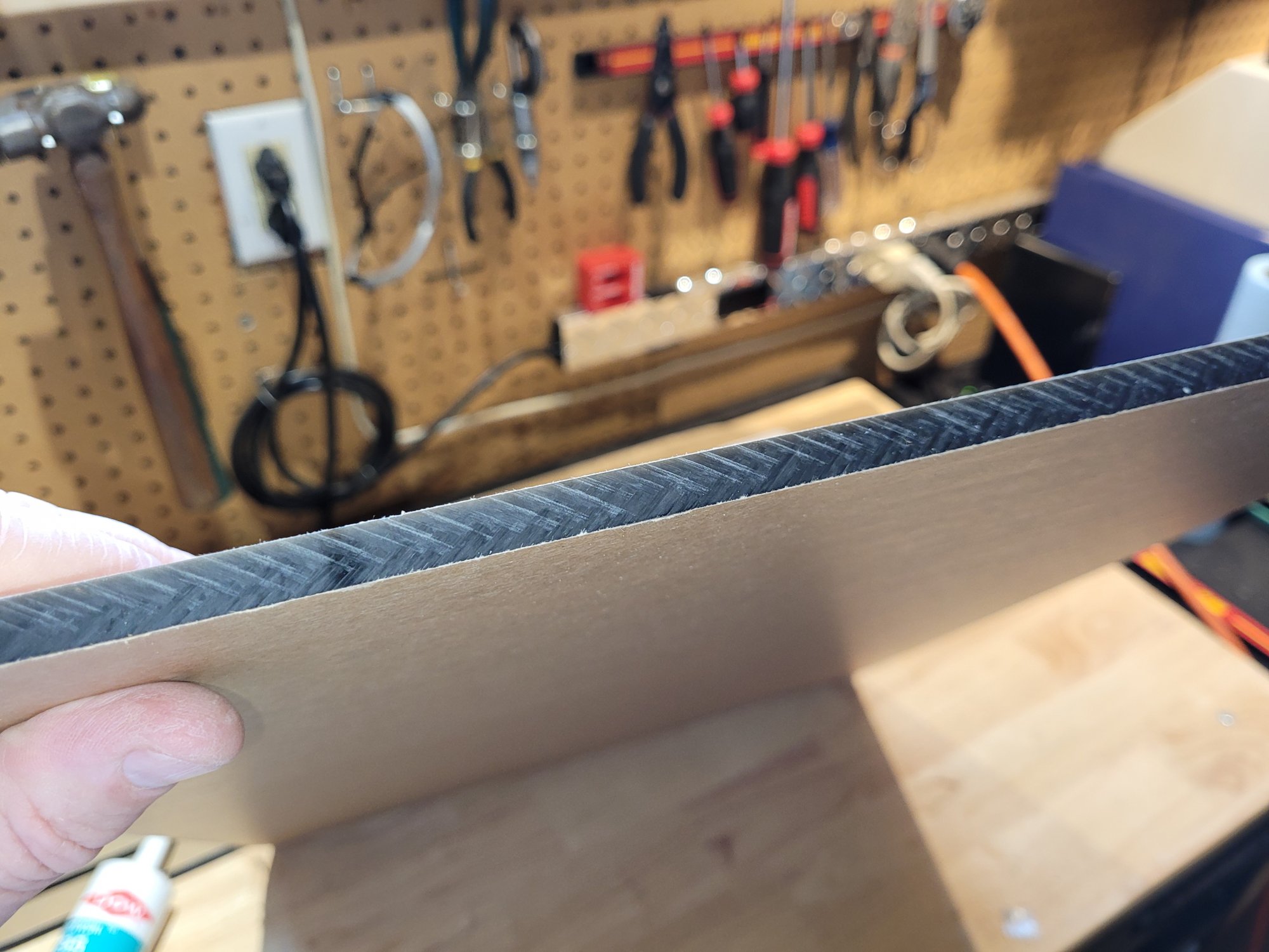

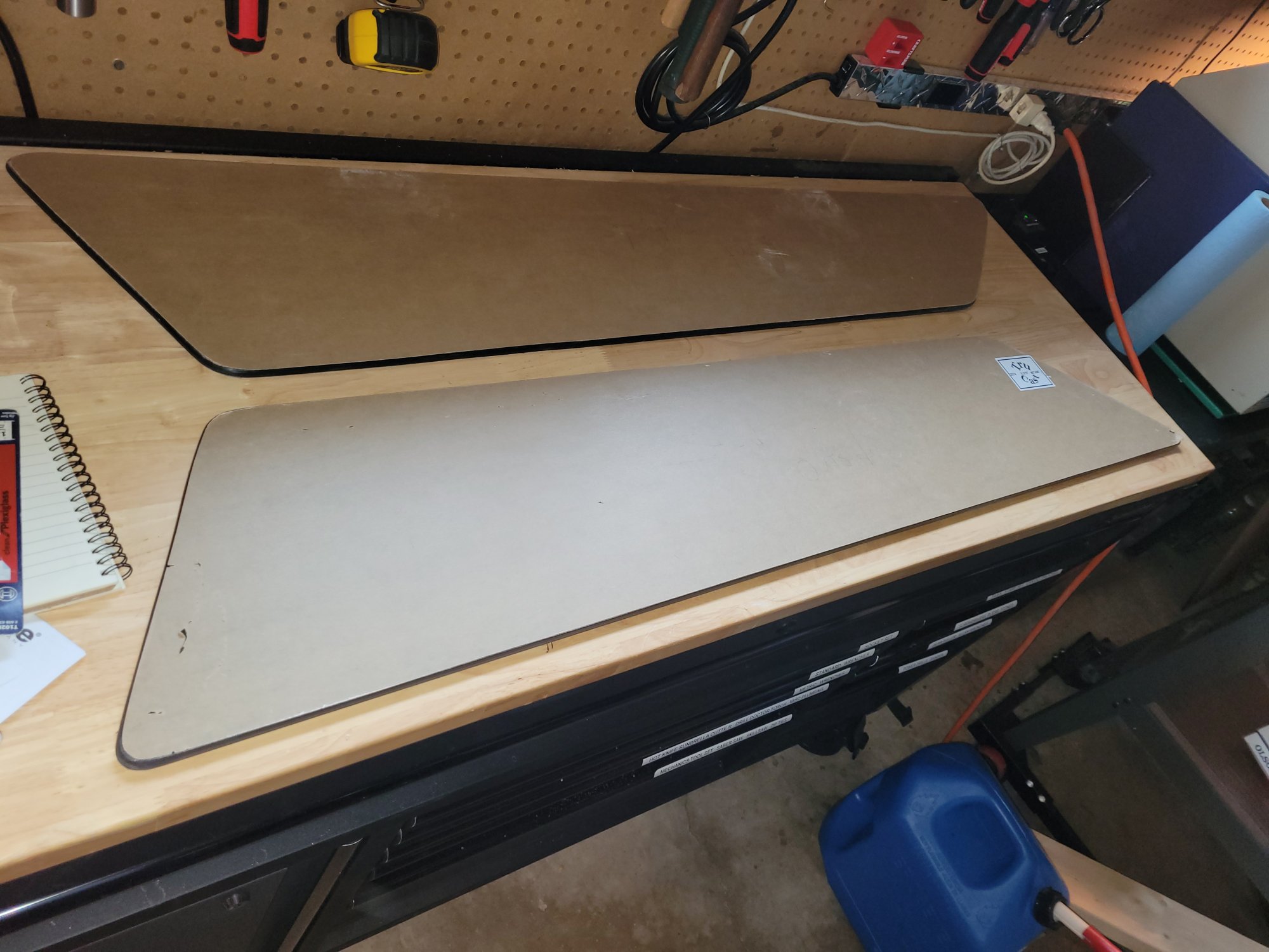

Well - Turns out I did NOT replace the port lights in the spring. I DID, however, make two portlghts out of 3/8" plexiglass. I made a template first, marked up the plexi, then sawed the ports out. I rounded the edges with 120 grit sand paper and smoothed with pogressively finer abrasives down to 400 grit.

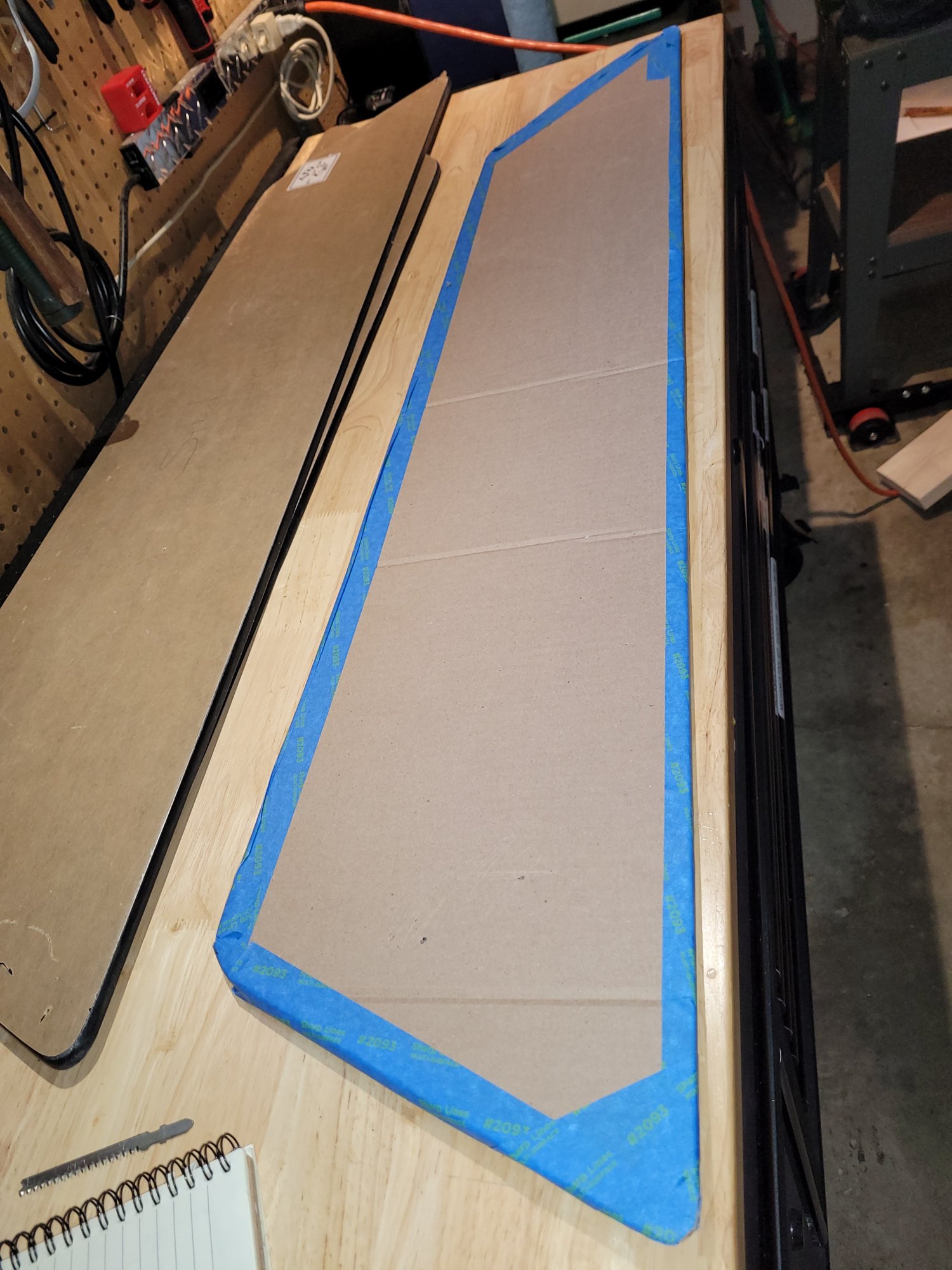

I made a template out of cardboard. I use masking tape to creep up on the precise size. was a challenge with the windows still on the boat.
