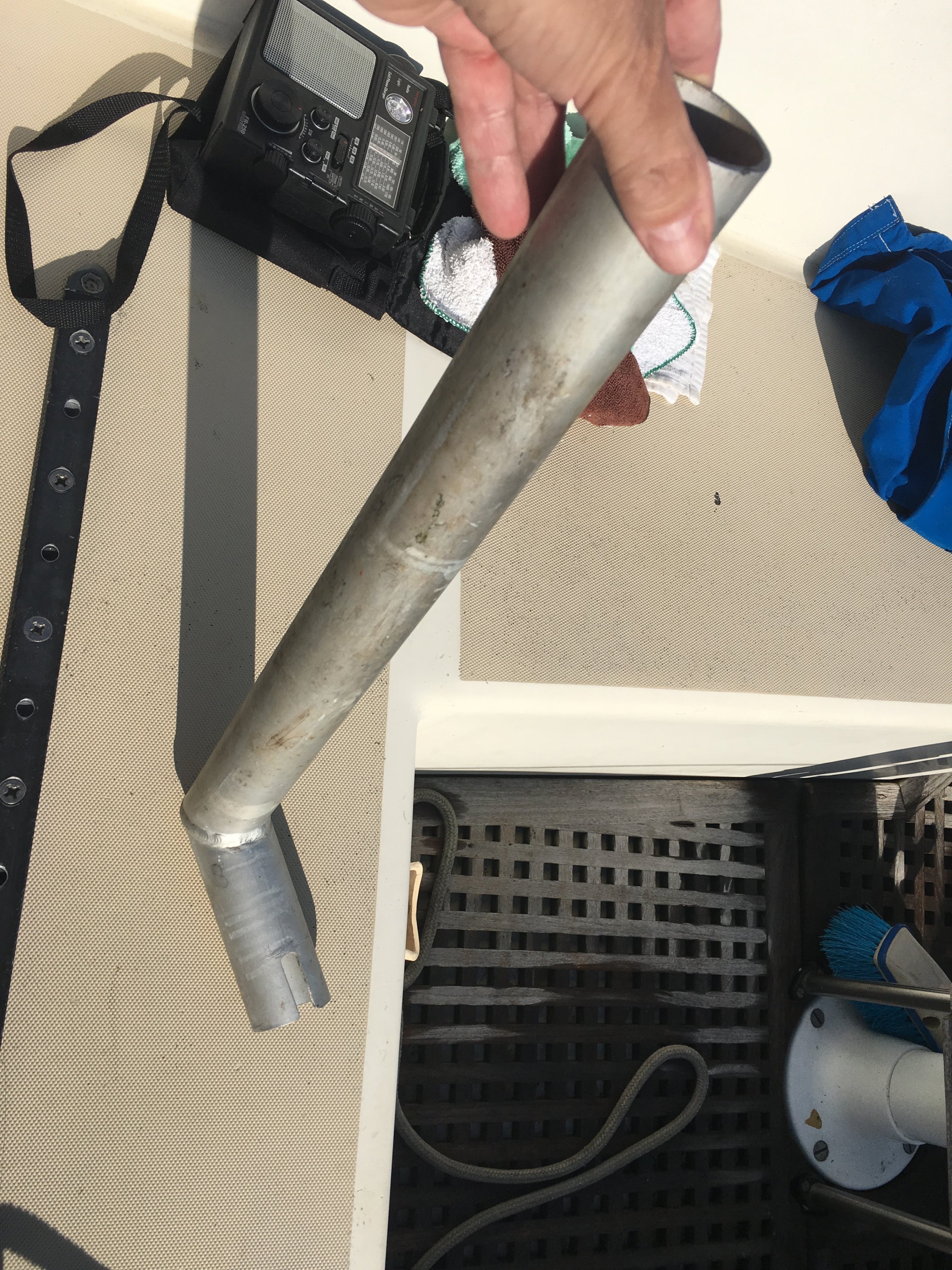

What the heck is this?

It does look like some 'turning device'. The O'day owners will chime in I'm sure.

Emergency tiller, for sure. Either came off another boat or the rudder post is now different due to a new rudder. I had to refab my e.t. when I replaced my rudder.

Maybe, but if so, why the slots on the short end?
So it can slide up around the shafts of two fasteners and be tightened in place?
I still vote for emergency tiller, except for the angle of bend is not 90 degrees.

I'm going to have to take another look next time I visit the boat later this week. Thanks for all the ideas!

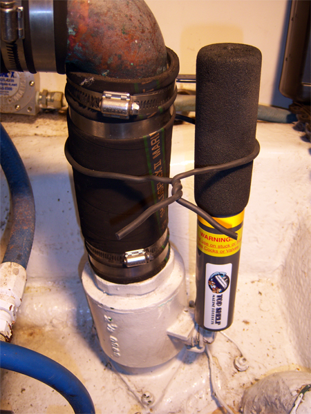

Makes sense, but if you need additional leverage to turn them they may need to be serviced!
Sometimes these valves are in hard to reach places. There is actually a retail product sold for this.

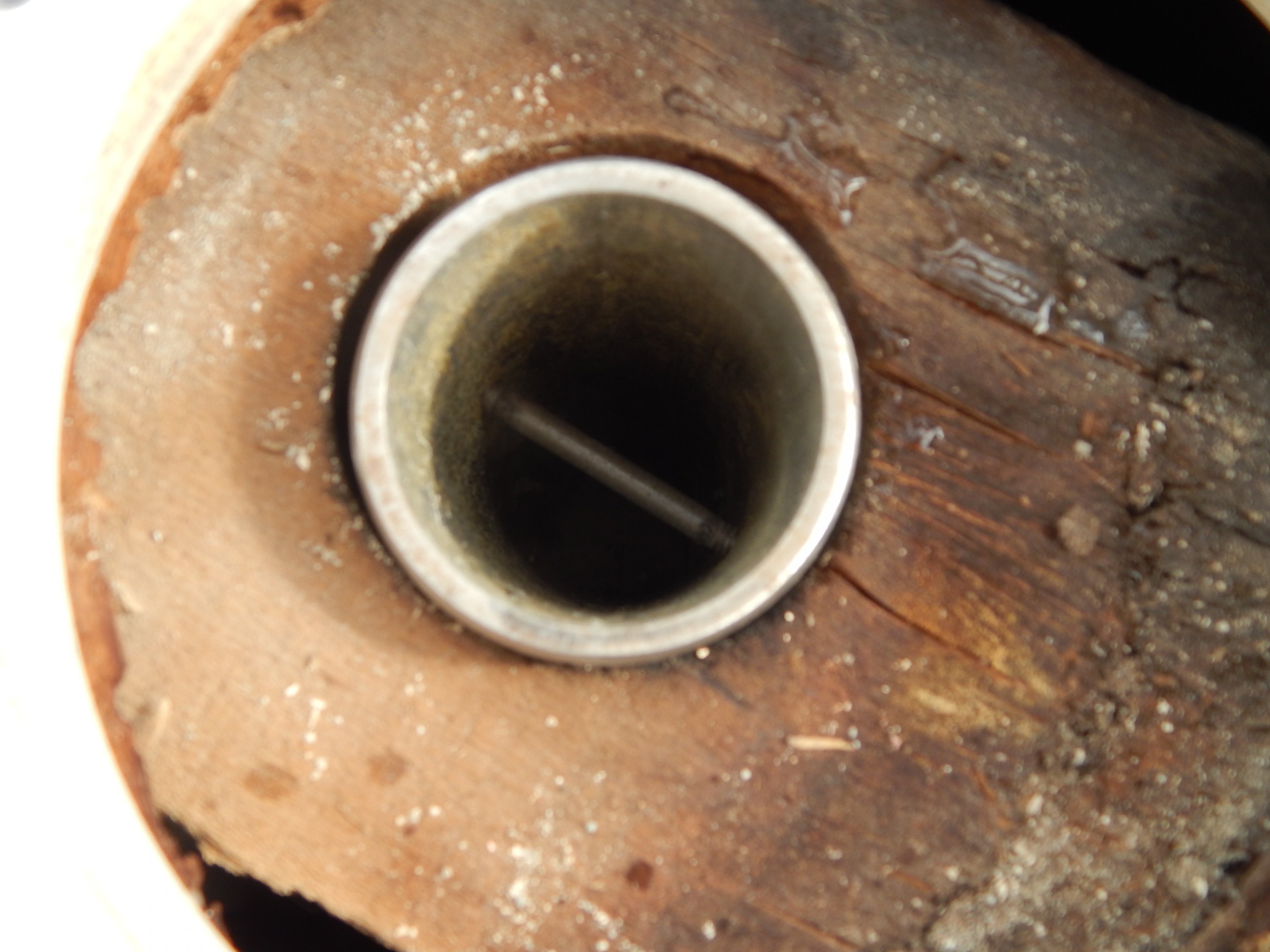

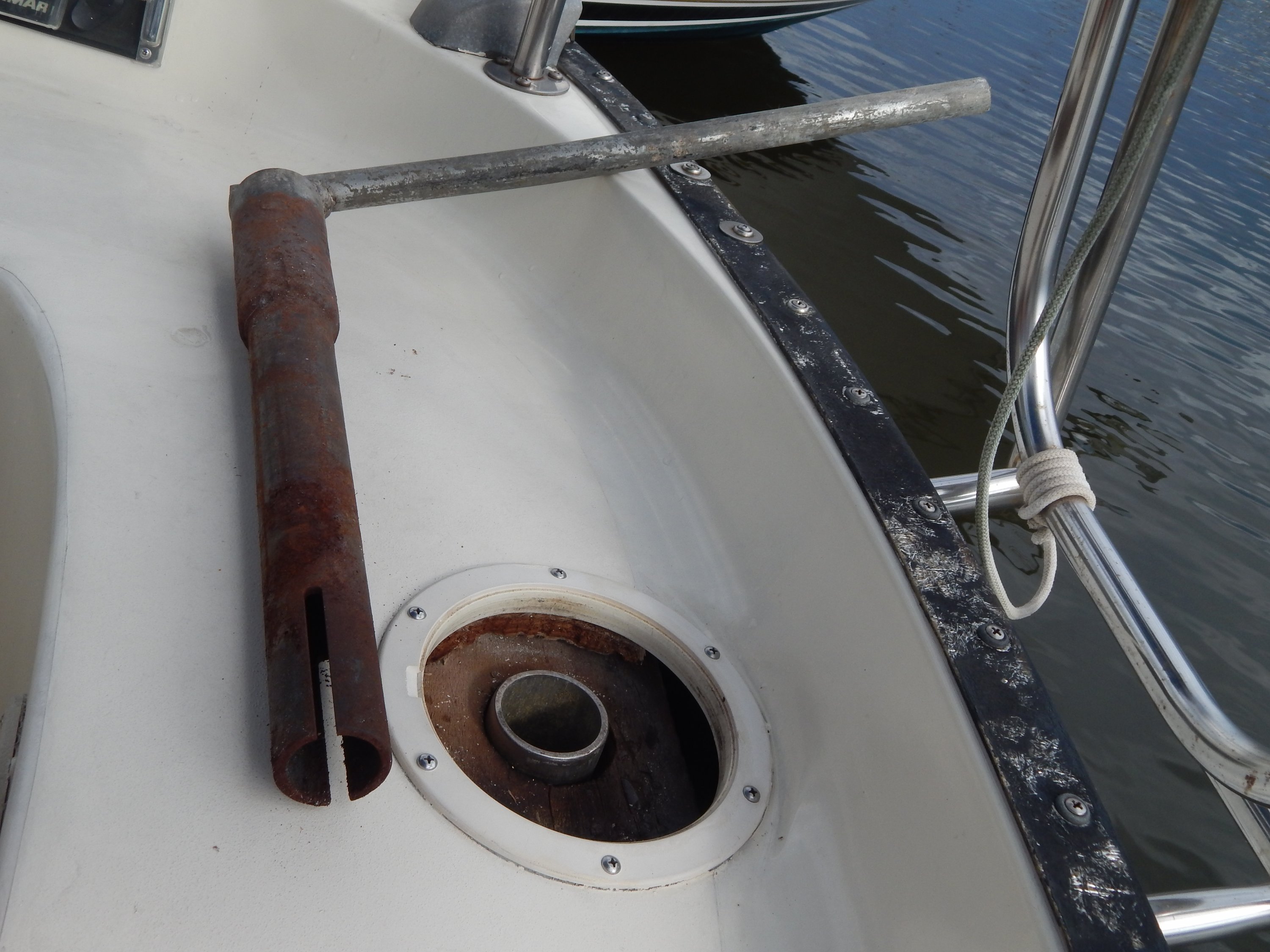

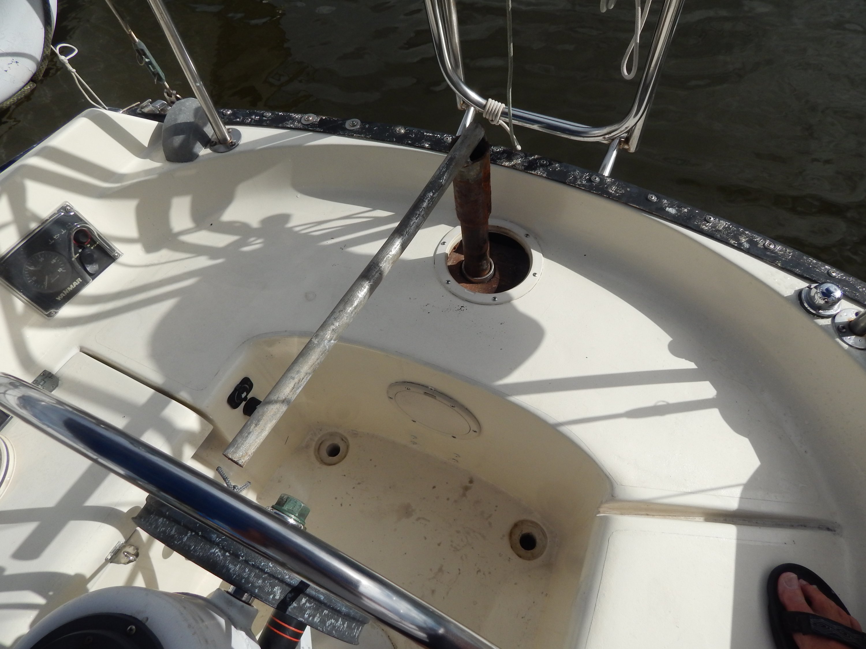

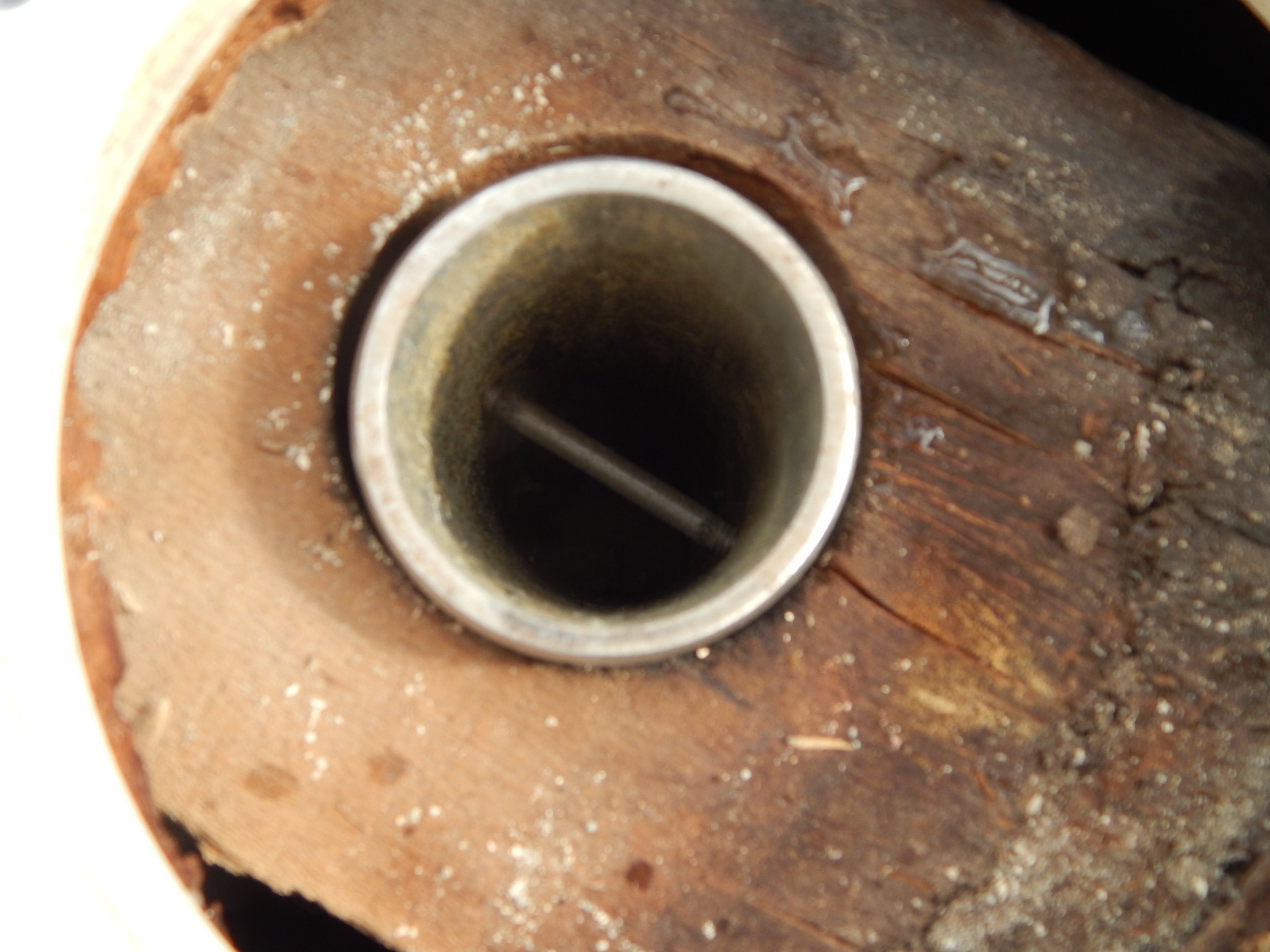

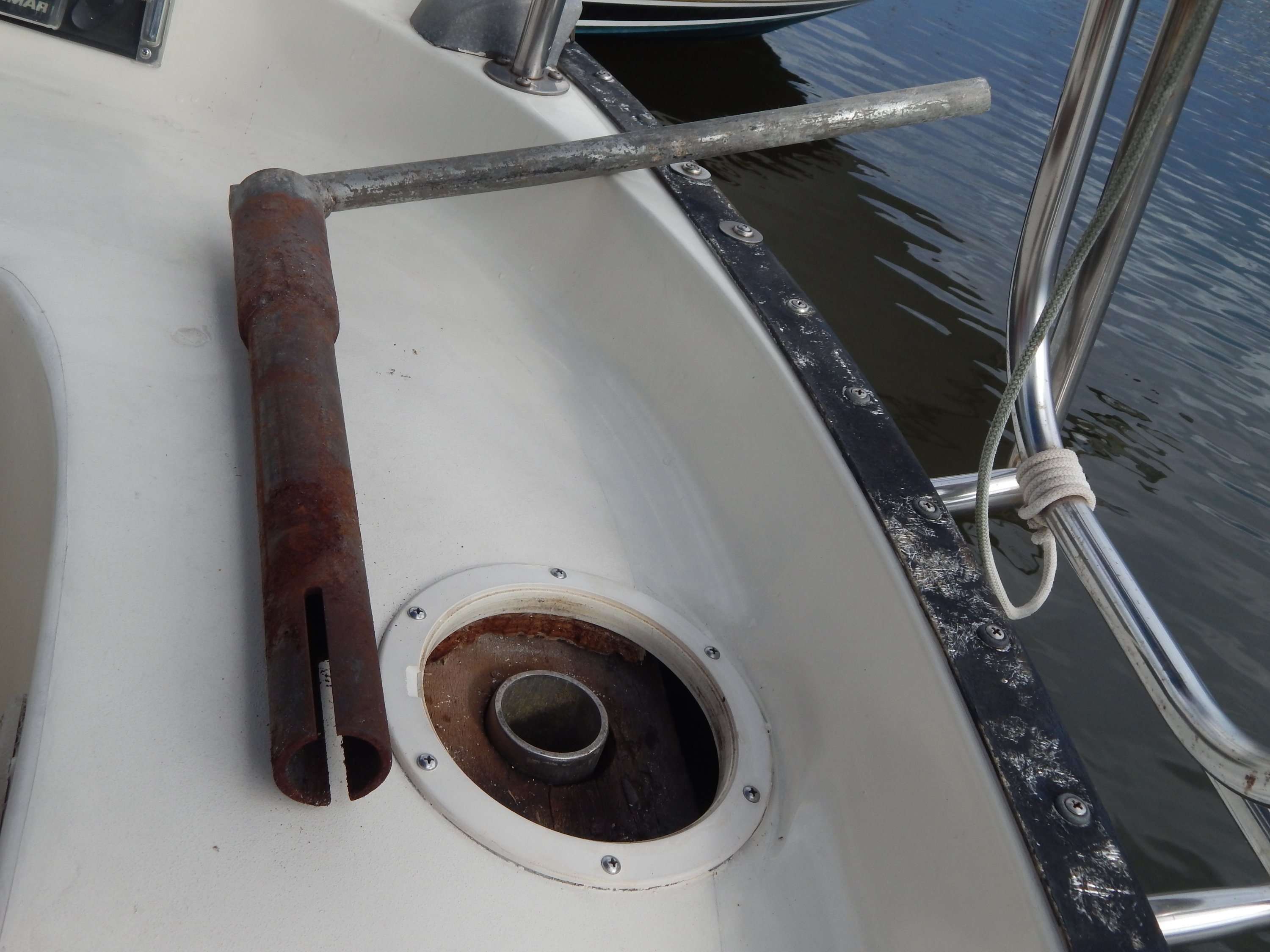

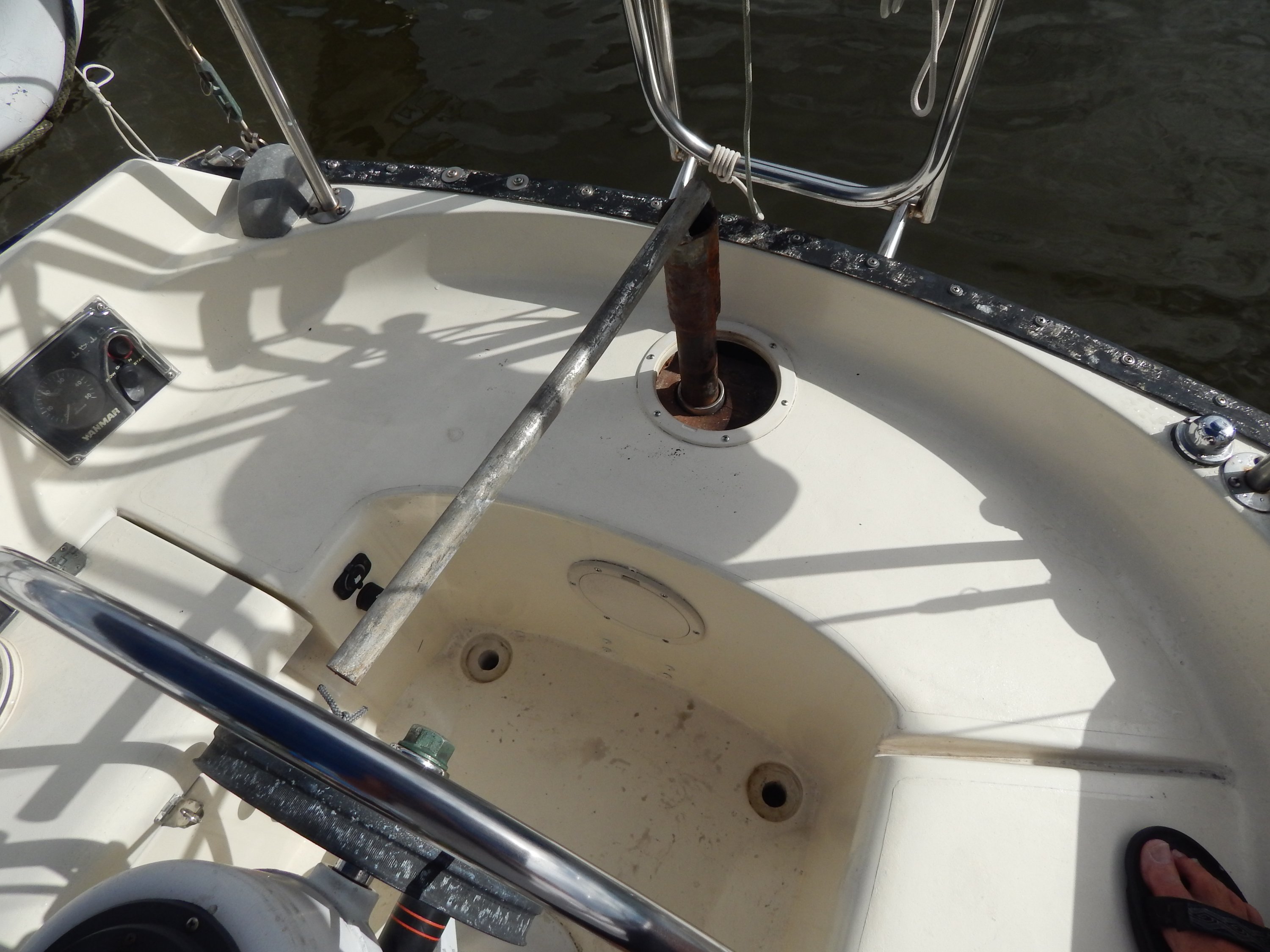

Take a look at these pics. I just took these while I was on my boat this afternoon. See if anything looks like yours.
Pic #1 Emergency tiller and top of rudder shaft.
Pic #2 Looking down the rudder shaft.
Pic #3 ET set up.
