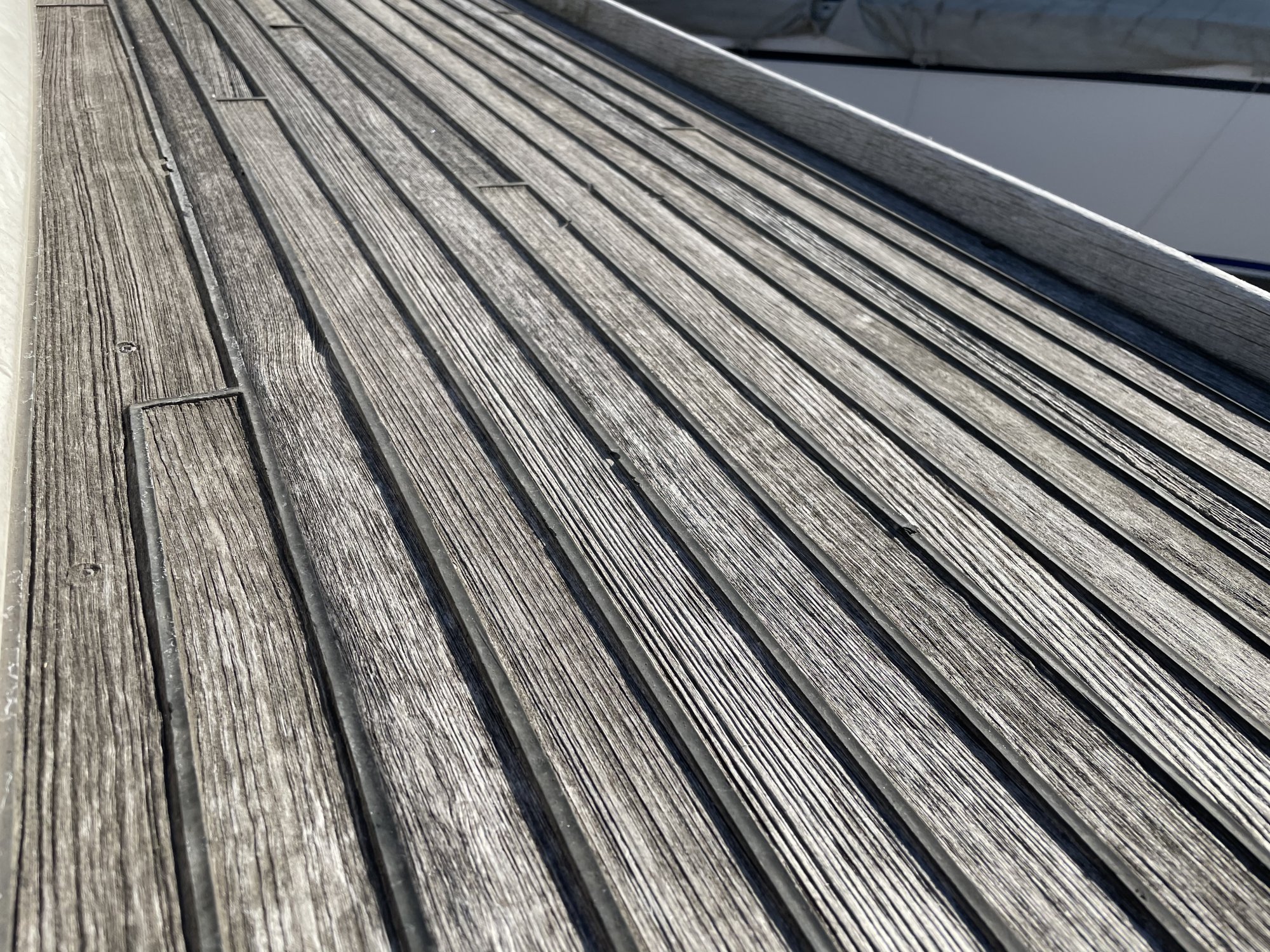

I just looked at a Beneteau First 47.7 that needs a $40k teak deck replacement due to an overzealous PO with a power washer. Beware.
A whole lot of home decks have been ruined by power washing. Contractors like it because it is fast, but it blows the fibers apart. That's not how you clean a deck.

Even if a relatively stiff brush is used the bristles will erode the soft parts of the grain if you scrub with the grain. I was taught to scrub across the grain and never even consider power washing as an option.
On that 47.7, I don’t see how the seam caulking managed to survive.

They don’t lay this down in the traditional manner. It’s more like a mat, with the wood inlaid to a rubber base with the caulking built into it. It probably takes than 1/10 of the time to install it, and it’s much less likely to leak.
