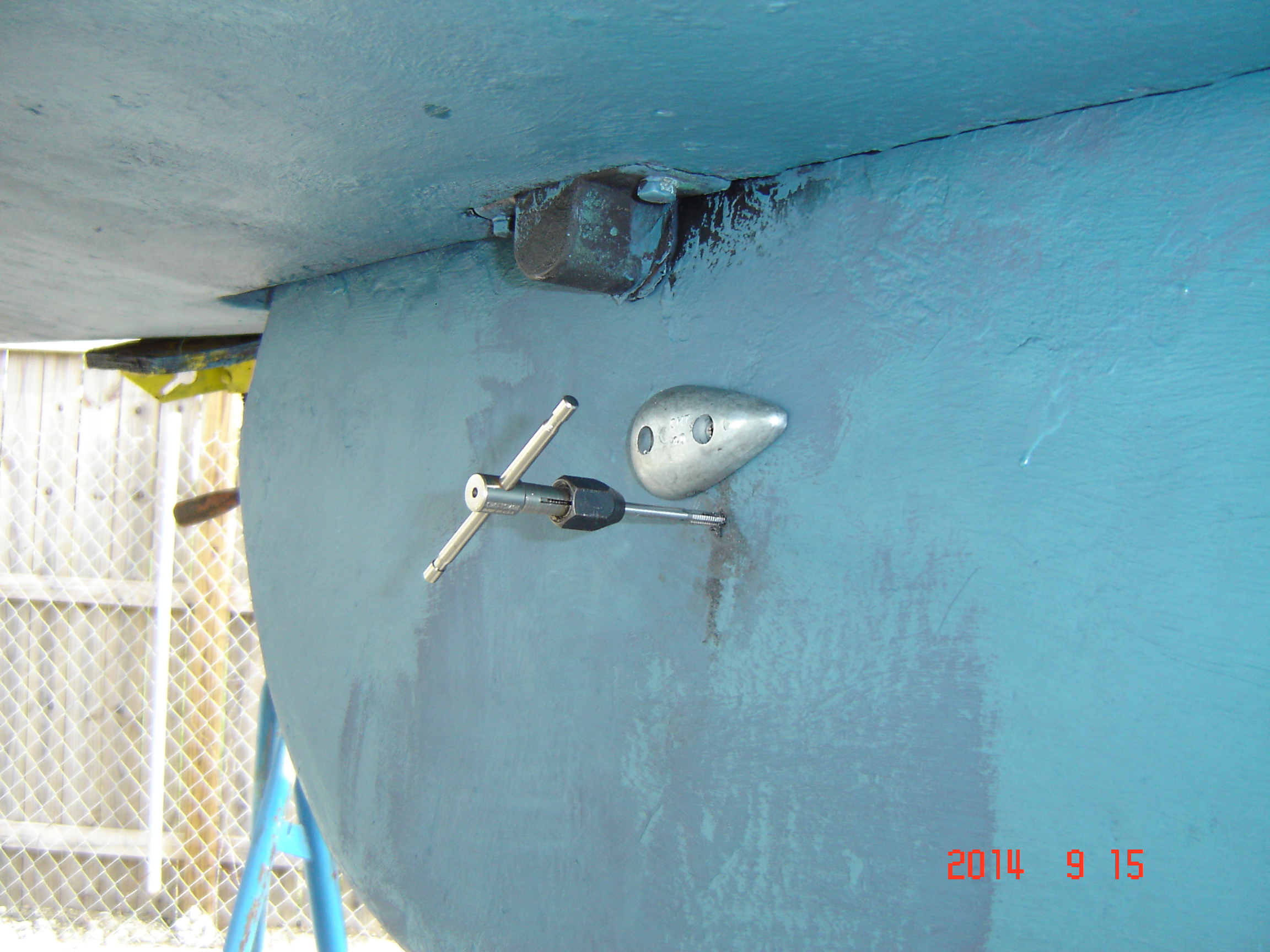

The key reason for a keel zinc is to protect the different metals involved in the bronze hanger to stainless pin to cast iron swing keel, usually pretty much electrically connected. Simple to drill hole through completed coating on keel including bottom paint (mine is copper based, another metal involved.) tap and die and bolt on a teardrop zinc. see pixD anode attachement and new numbers.JPG

Jacktar.......just between you and me, your keel hangers are installed upside down....the round portion goes up into the recess in the hull.
Don
