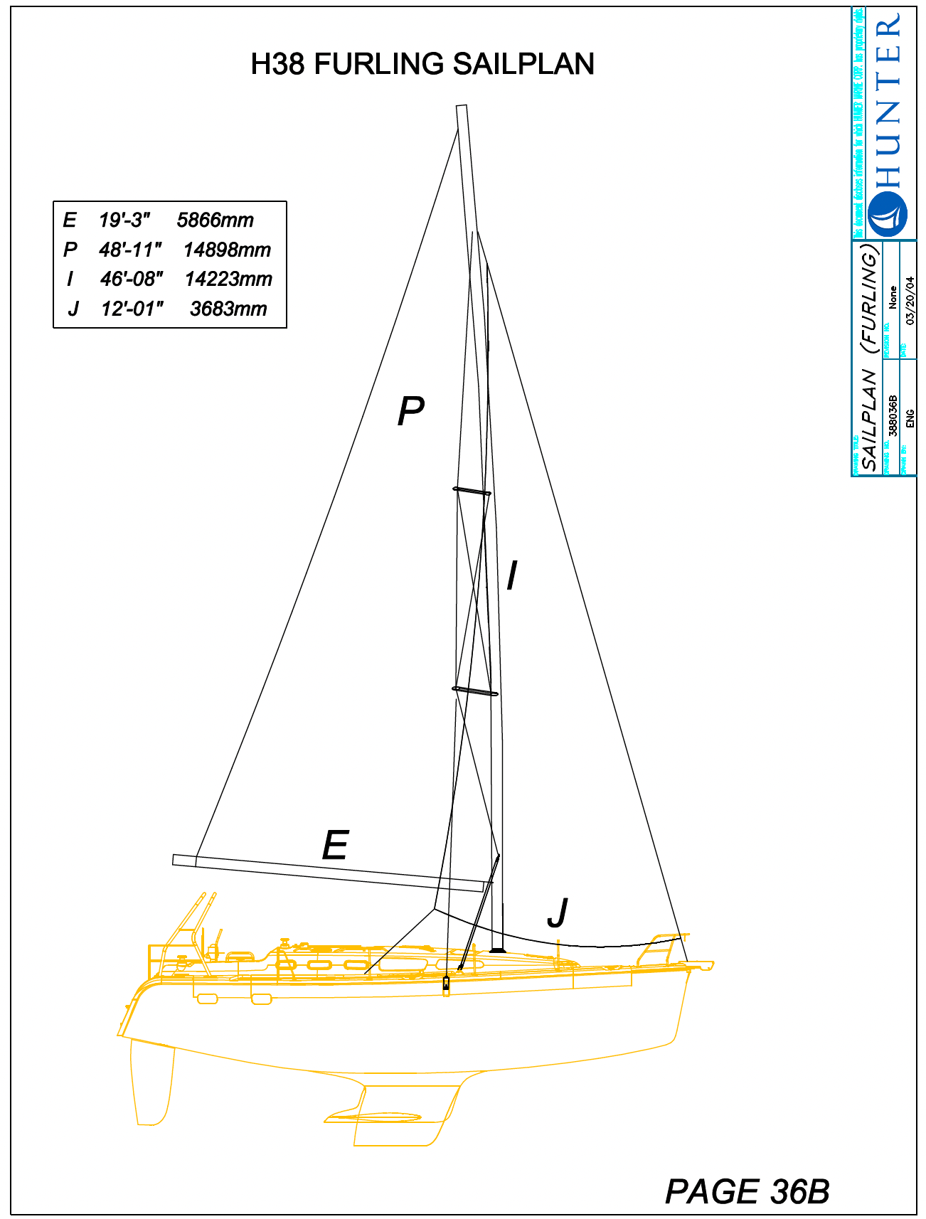

I'm not asking for specific measurements. I've gone ahead and done all the rig measurements.

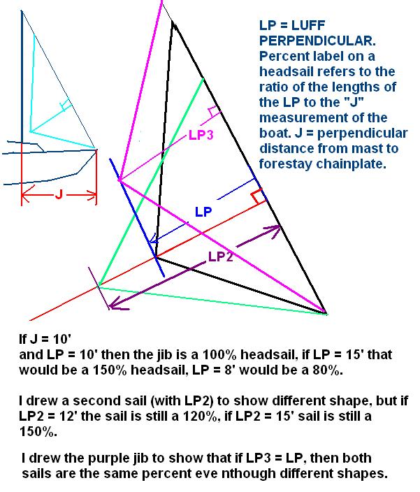

Measure the sail, too. Since you know the IJPE measurements, then compare the sail measurements, like this:
It is the ONLY way to answer your question.

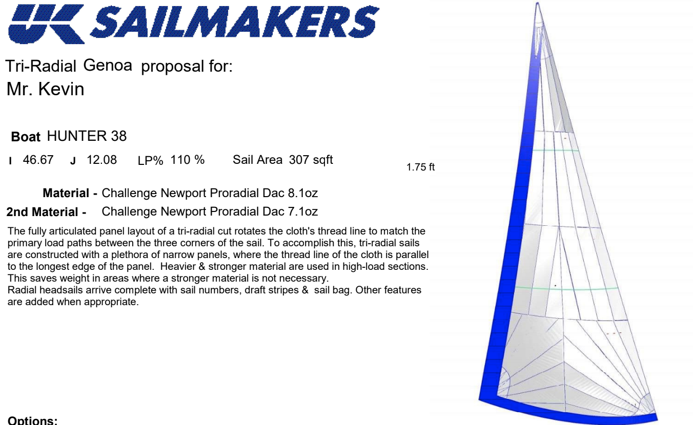

I replaced my factory headsail last season with a sail of the same dimensions. The sailmaker labeled LP as 110%.

I just did this. Measured LP on existing sail and re-measured J. My LP/J shows about 119%, so call it 120%
