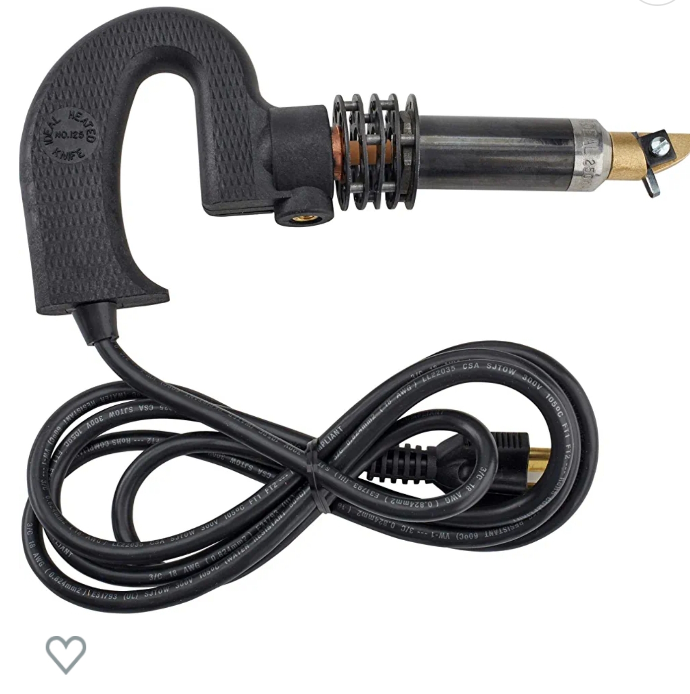

I wanted to post an update. I used a tire cutter tool I had that made removing the old sealant very easy. It is like a super soldiering iron with a U shaped razor blade that heats up to 500 degrees or so.
I taped up the window and hull them sanded the area before laying down a bead of Dow 795. I took others advice and used a plastic spoon to smooth it out and remove extra sealant.
I don't know if it worked yet but will he on the boat this weekend during rain.
